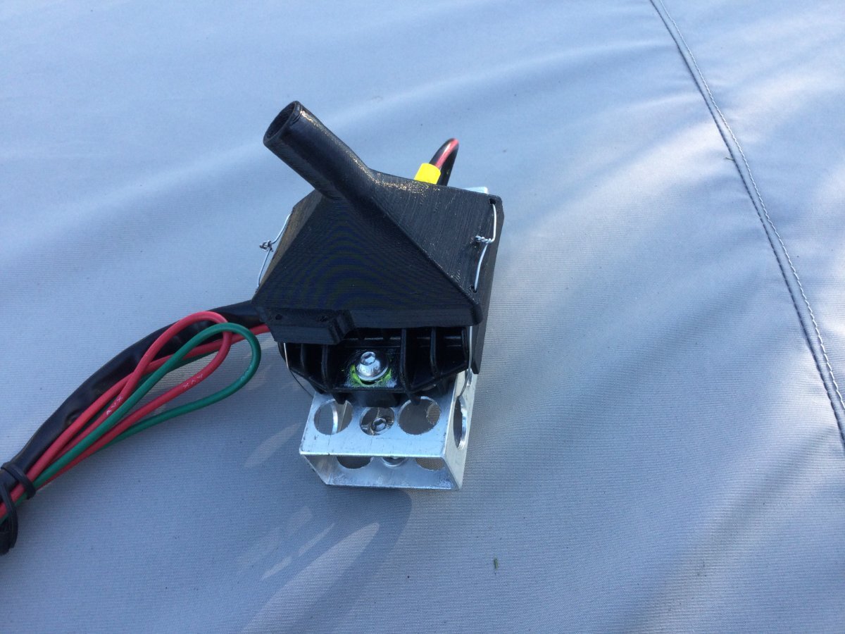

skippydiesel Posted May 30 Author Posted May 30 2 hours ago, BurnieM said: https://www.vectriqparts.com.au/product/rotax-voltage-regulator-carr5115/ Did the wiring take much time/effort ? No the wiring is straight forward - just be sure that connections are good & tight. There is a excellent diagram + specifications on the web site. NOTE: The CARMO has (from memory) mounting holes at 65mm centres and the Rotax 92 mm. You will need to drill an extra hole or make up an adapter as I did: Black top, with spout, secured in place with safety wire, is part of the dedicated cooling system. Rectangular aluminium tube (drilled for air flow) is the adapter . Black wire, (TOP) with yellow connector is to ensure good negative contact - I also cleaned of the black paint around the mounting holes & used a smear of dialectic grease. 😈 1

skippydiesel Posted May 31 Author Posted May 31 1 hour ago, sfGnome said: Is the cooling cap a Sonex thing or a Skippy thing? Where are you picking up the airflow that you’re feeding to it? Bits & pieces from here & there. Sonex are still new to Rotax installations, so no ideas from this direction The idea came from VR problems/solutions in RV12's The cap was made to order/design, by my Son on his 3D printer. The fresh air supply is through SCAT tube from a T piece, to the cooling cap, in the cabin left hand fresh air vent. Down side with the above - in winter there is a nasty draft from it onto my ankles. I have reduced this discomfort by putting a short piece of hose (a choke) in the air duct (SCAT tube) thereby reducing the air flow. The choke will be removed for summer flying. 😈

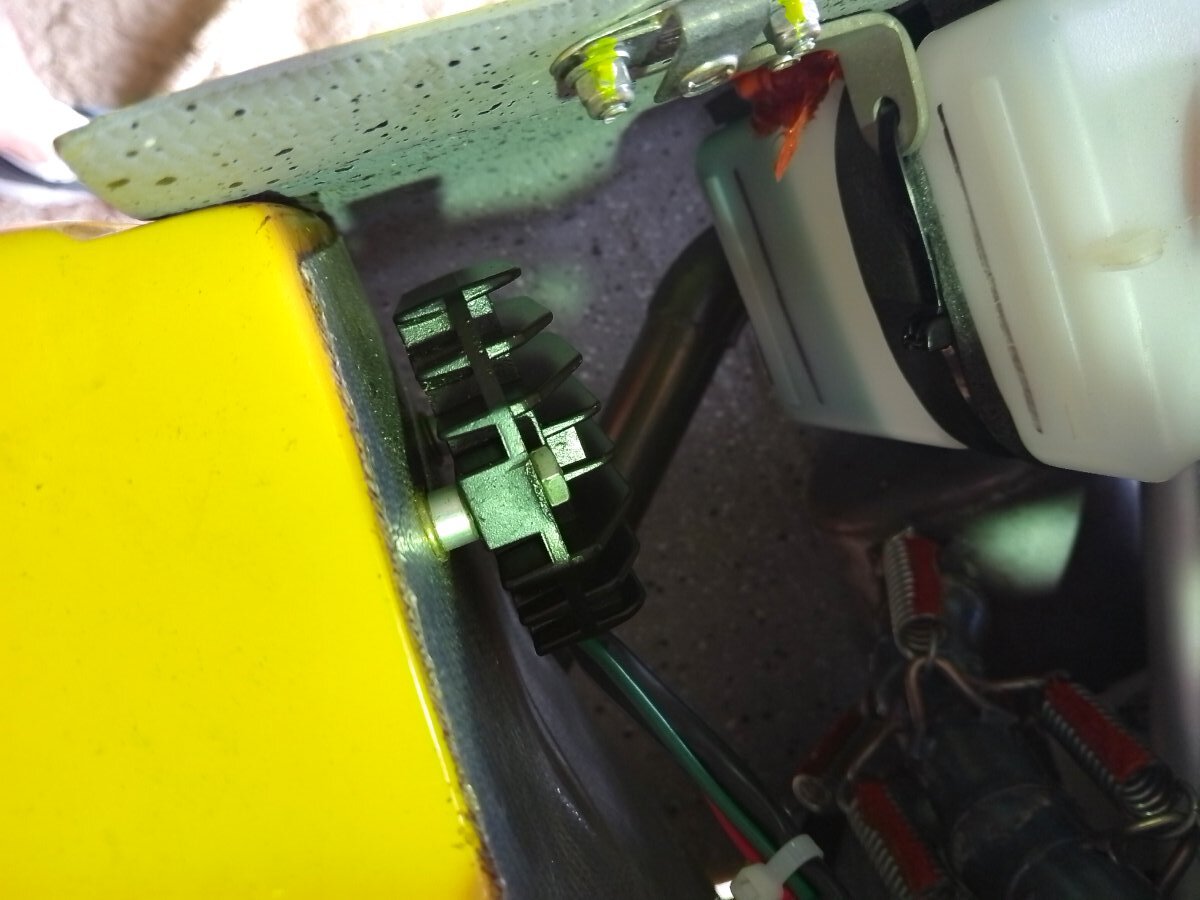

danny_galaga Posted May 31 Posted May 31 My installation benefitted from being a clean install. Plenty of air movement around the device, but the air that's there isn't going to be very cool. That's the kit position and I didn't want to waste time doing something different. Anyway, my hope was that even it's a bit warm there, it's supposed to run cooler than the original anyway. So far the longest flight has been roughly 80 minutes 2
skippydiesel Posted May 31 Author Posted May 31 Hi Danny, Good idea to raise the VR off the mounting surface - just be sure that its making a very good earth contact.😈 1
