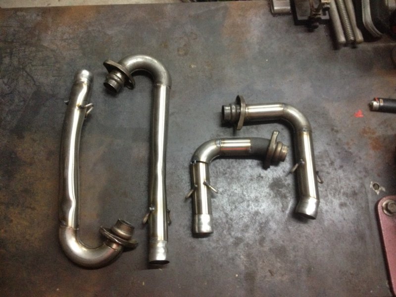

Kyle Communications Posted October 18, 2015 Author Posted October 18, 2015 Ok went to the hangar today with the van loaded up with cut off saws and grinders and tig welder...got my mate who is a good welder..on his birthday even :)...nothing like having to work for your mate on your birthday :)....anyway all pipes are cut and tacked and tomorrow they will be final welded here at home. I had to shift the radiator slightly in the adjustment holes 15mm to the left and I will need to maybe make a new set of hanger brackets at the front for the radiator but thats no drama at all. Once all welded the pipes will be ceramic coasted which stops most of the heat from them as they are a little close to some of the internals but all should be fine. 1

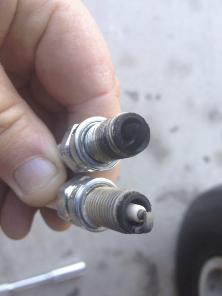

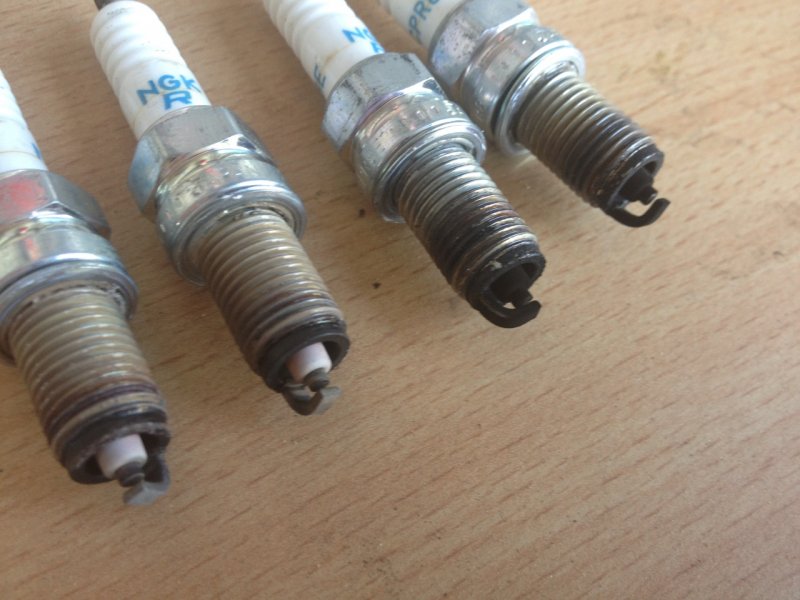

IBob Posted October 18, 2015 Posted October 18, 2015 I'm looking forward greatly to seeing what results you get here. You mentioned there is a noticeable difference in spark plug condition, front vs back. Do you have any pics of that?
Kyle Communications Posted October 18, 2015 Author Posted October 18, 2015 The black ones are the rear cylinders
Kyle Communications Posted October 18, 2015 Author Posted October 18, 2015 I wont get to run the engine until next sunday. The pipes will be finished tomorrow and I will fit them during the week. I am off down to Narrabri/Gunnedah on this Friday to have a look at the Rans S-20 Raven which is the next aircraft I am thinking about building then will be back here saturday night. So it will be the next day I get a chance to run it up but I also need to run it with the original system
IBob Posted October 18, 2015 Posted October 18, 2015 That's astonishing. I'll ask the stupid question (I'm an automation eng of sorts, so it comes with the territory): the Spirit you referred to earlier as performing so much better with same engine and prop: what do his plugs look like?
Kyle Communications Posted October 18, 2015 Author Posted October 18, 2015 Spoke to Roger today about that actually. He is due to check the plugs in a couple of hours so should be able to answer that question for you and me both. The rear ones are so black that it cant be the difference between the front and rear on the inlet manifold distance from the carbs.

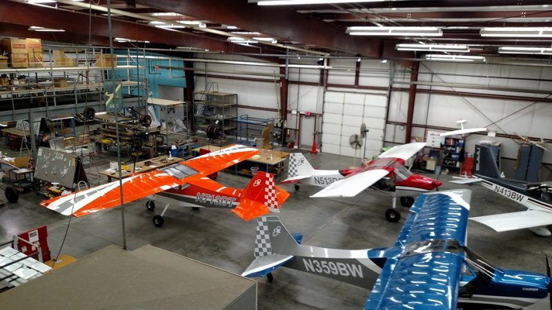

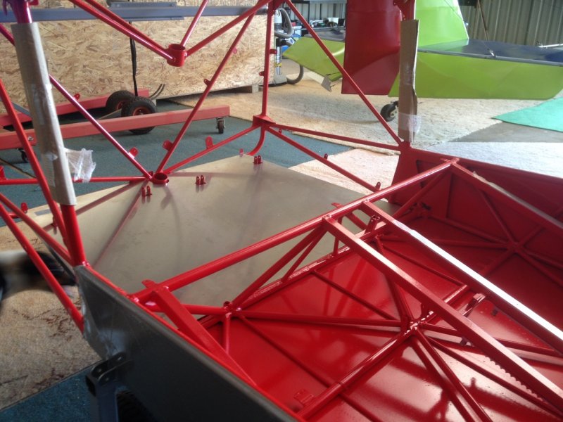

Kyle Communications Posted October 18, 2015 Author Posted October 18, 2015 They are a nice looking aircraft, this is a picture from the factory floor a couple of days ago. I also see they have now for the S7 Courier a set of retractable slats. The S-20 has the same wing as the Courier so should be able to be fitted 1

Kyle Communications Posted October 18, 2015 Author Posted October 18, 2015 The bits are home on the bench ready for tomorrows finishing off. I may do some new ones a little better if this works well. I will probably change a few things with the radiator mounts and I will use a better pipe bender. The current one crushes the pie a little bit but wont make difference for this trial its only for asthetics the function side of it will be the same

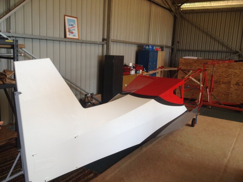

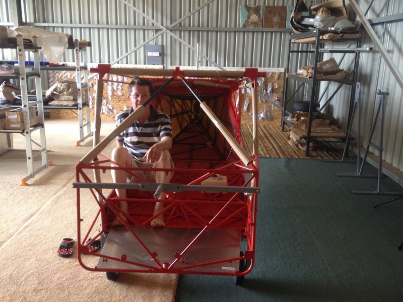

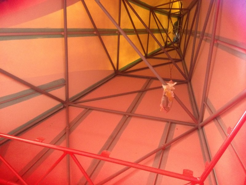

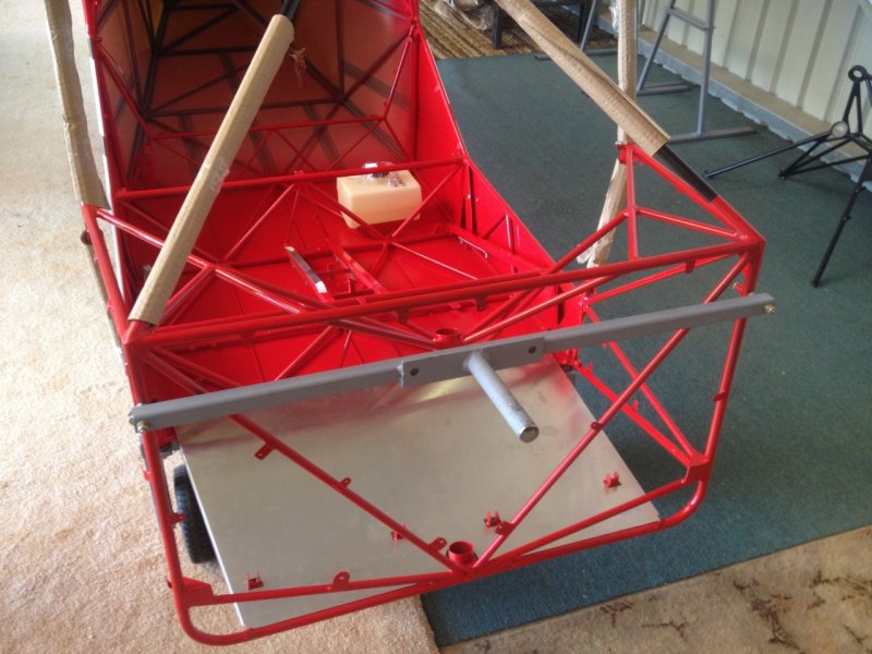

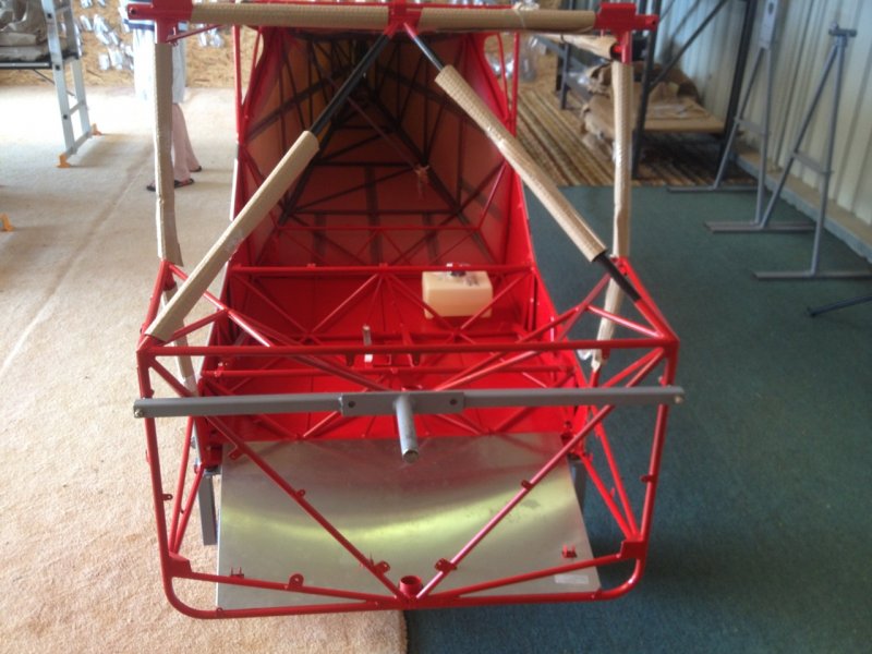

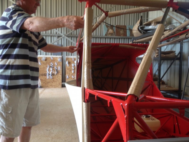

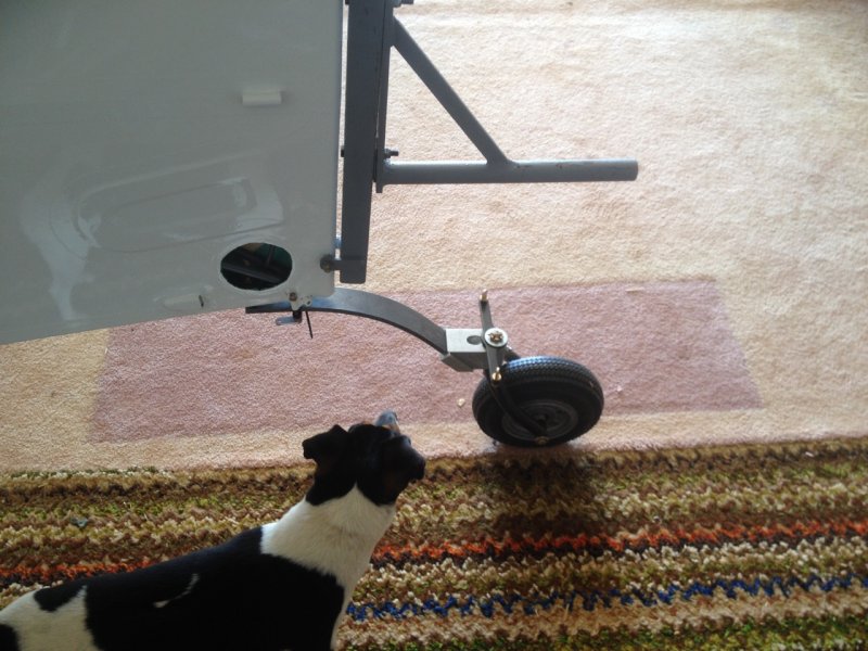

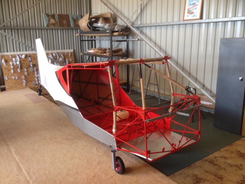

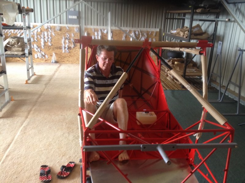

Kyle Communications Posted October 23, 2015 Author Posted October 23, 2015 Sitting back in the hotel room after a nice feed at the Narrabri bowls club. Long but enjoyable drive today to come down and have a look at Tony's Rans S-20 Raven. Well I am impressed with the quality of build and welding. The manuals and information looks extremely good. The parts are very well identified and packed. It really is a very professional kit. The covering job and the painting is extremely good. I took some pics as he really has only just got it out of the box and he has a quick build kit but there is a still a few things to get done but certainly a huge time difference if you were to build the "normal" kit. The room inside the cabin area is HUGE and with the bowed out section of the doors it would be like sitting in a Calais or Fairlane. The whole airframe looks very strong. Tony still had the wings packed in the box but the initial look and feel was very nice as well. I am impressed with the whole aircraft...probably will hit the cot tonight with a woody Drive back home tomorrow and my mate is supposed to have finished the welding on my engine pipes this afternoon so sunday morning will get down to the hangar and if everything still fits properly I hope to get the engine started and see how it sounds and maybe an initial look at RPM 4

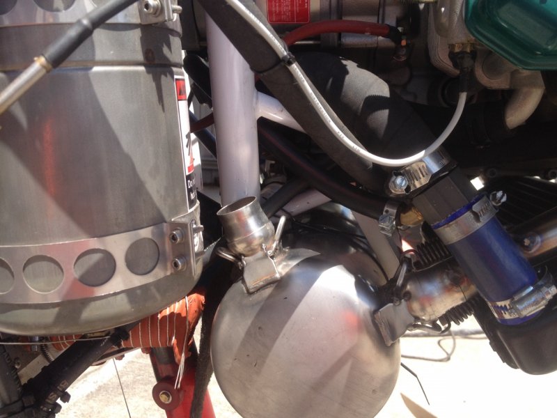

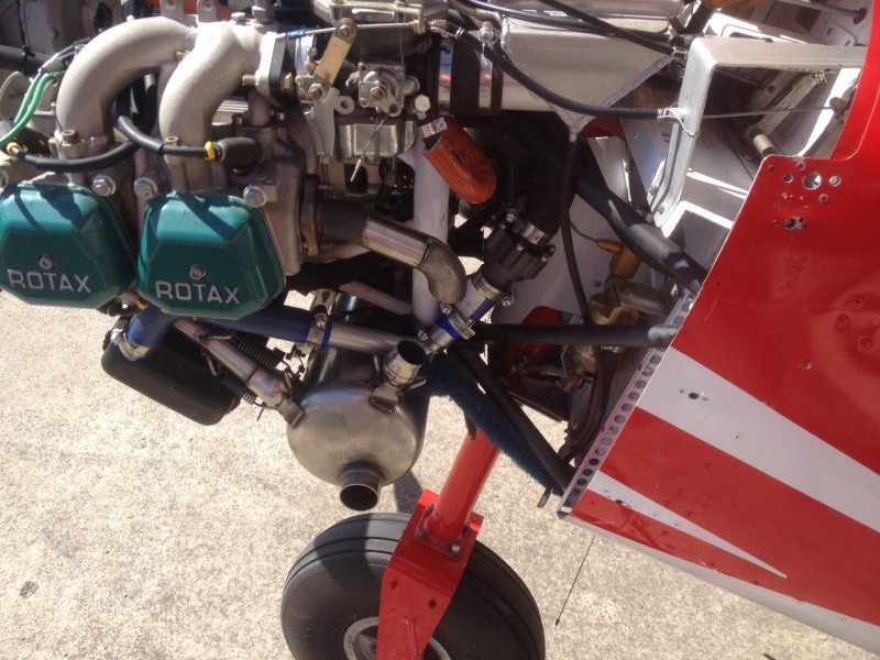

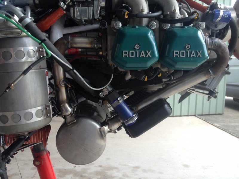

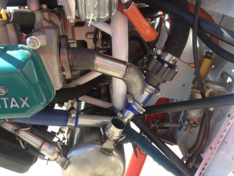

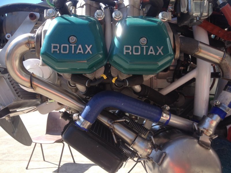

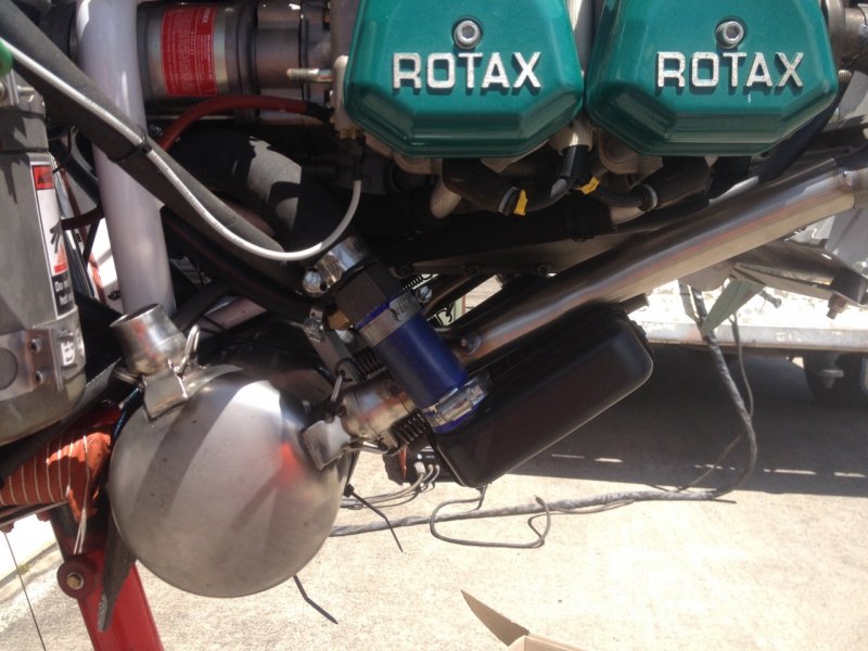

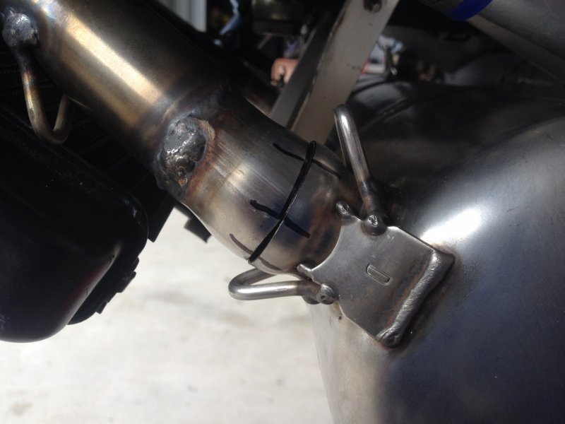

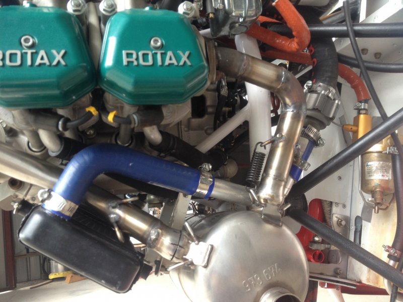

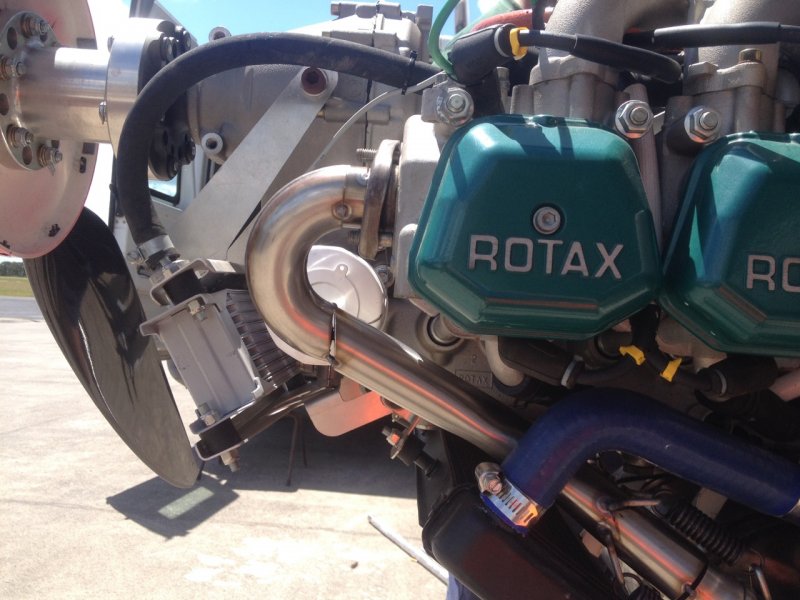

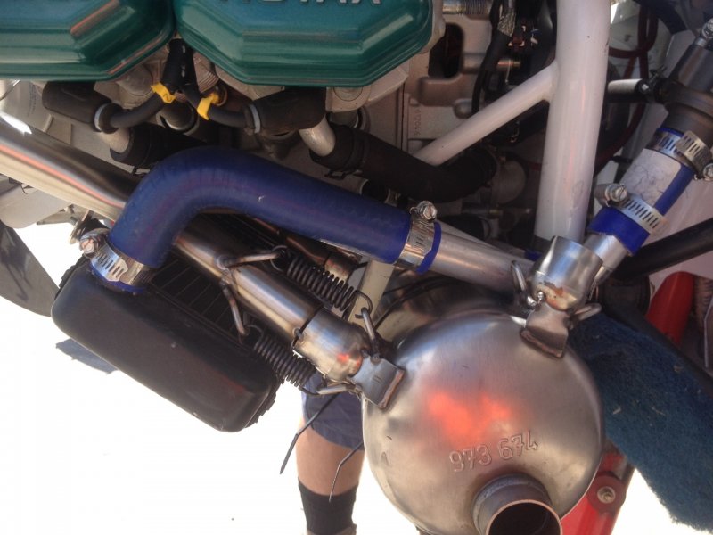

Kyle Communications Posted October 25, 2015 Author Posted October 25, 2015 Went down to the hangar on sunday to fit up the new engine pipes for the Rotax muffler. Everything fitted except 1 set the front left. The bell at the muffler end has pulled during the welding. I pulled the muffler off and the offending pipe and my mate will be around this arvo to cut and reweld it. You can see where I have marked it. Hopefully it will work fine when I fit it again then I can get ready to start the engine. I do have to shift the water radiator a little and that will be easy . All I need to do is to add a plate on each of the existing radiator mounts to drop the top of the radiator by about 15mm that will give me the clearance I need for the RHS front engine pipe the LHS is fine now but will be dropped when I do this. The water pipe to the radiator at the RHS will need to be cut about 15mm longer than it is now also then thats it. I trial fitted to bottom cowl and it will need a little bit of work but it should be relatively easy if it turns out to be successful and I get more power.
