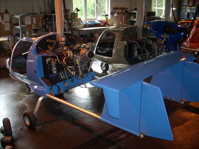

i had my first turbo charged rotax that put out 135hp 7 yrs ago, want more power 5 mins and you can have 180hp if you wanted, you can buy the whole engine ect ready to strap in for about 30k, the aftercooler isnt mounted yet in this photo, but yes it is a must to keep the intake temps down so as to stop predetonion, and obviously because of the heat no carb ice, so it fixes everything.
