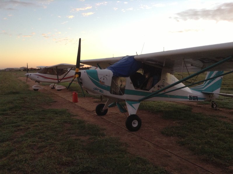

gregrobertson Posted August 6, 2012 Share Posted August 6, 2012 Pic of the latest Nynja at Watts Bridge. 5 Link to post Share on other sites

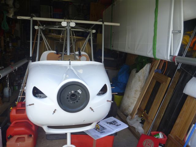

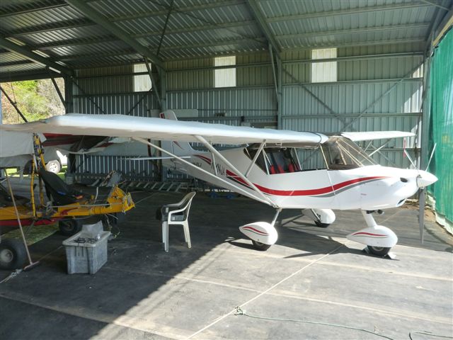

Blueadventures Posted October 12, 2014 Share Posted October 12, 2014 Greg was at Mackay with his Skyranger Nynja to check the wing frame assembly and the build so far. I got to fit the wing structure and verify the front vertical cockpit tube positions. Also one wing covered and can now get on with fitting the ailerons and flaps and covering the starboard wing. Also mounted some items to the fire wall, gascalator colector bottle etc. The images are of the build to date and Gregs Nynja at Mackay shows the new Nynja will fit in the hangar. Greg was a great help and seeing over his Nynga again showed how things fit and were to mount certian parts. The information is very helpful to me. Cheers Mike Link to post Share on other sites

Blueadventures Posted October 13, 2014 Share Posted October 13, 2014 These are the images for the previous post about the build at Mackay. Fitting the wings. Gregs Skyranger Nynja in the Hanger at Marian. Can't wait until 19-2804 is in its spot. Front on view and covered wing on right. Inserting the batterns. Link to post Share on other sites

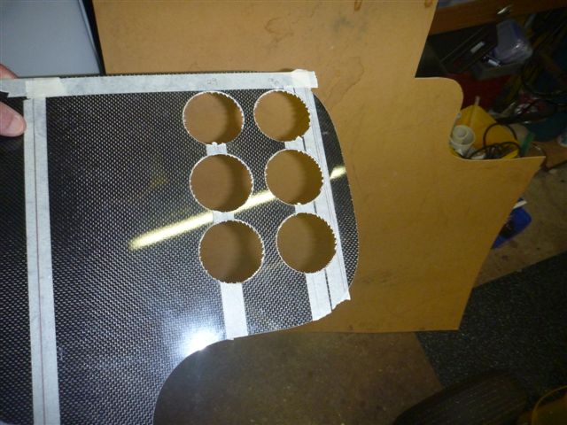

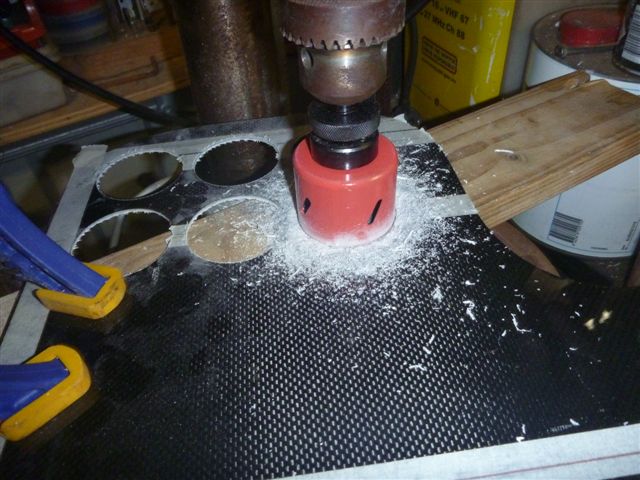

Blueadventures Posted November 22, 2014 Share Posted November 22, 2014 Planning the panel layout #1.I'll place the master, push button start and AMag 1 & 2 switches, fuel pump and carb heat below the VSI and trim guages. A GT-50 goes in the lower left small dia side. [ATTACH=full]32488[/ATTACH] Started cutting out the pamel. Only done the 2 1/4" guage holes waiting for the 3 1/8" holee saw to arrive. All good superglued the furry edges of the fibres on the hole ID and sanded with sandpaper wrapped around a wine bottle neck; the finish was perfect. (A great idea that someone else though of and I used.) Cheers Mike Link to post Share on other sites
