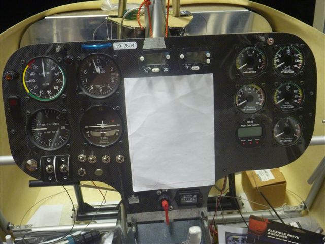

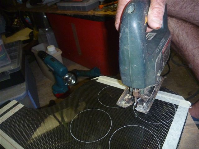

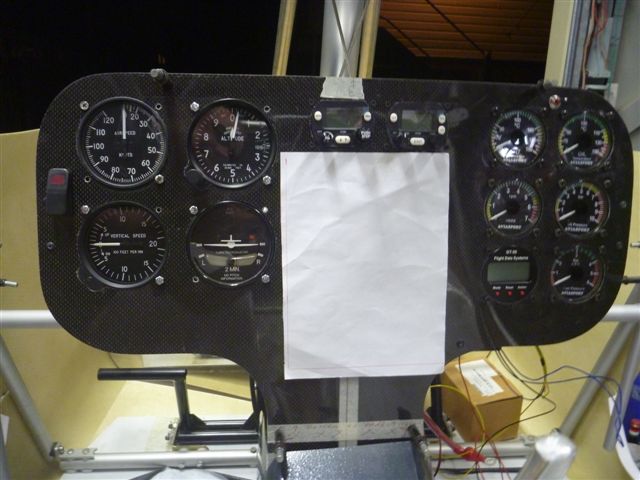

Guest Maj Millard Posted November 22, 2014 Share Posted November 22, 2014 Planning the panel layout #1.I'll place the master, push button start and AMag 1 & 2 switches, fuel pump and carb heat below the VSI and trim guages. A GT-50 goes in the lower left small dia side. [ATTACH=full]32488[/ATTACH] Might stick your tach up where your CHT is Mike............ Link to post Share on other sites
Doug Evans Posted November 22, 2014 Share Posted November 22, 2014 U going to run a fuel flow meter ? Mike Link to post Share on other sites

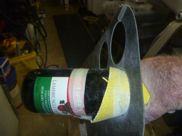

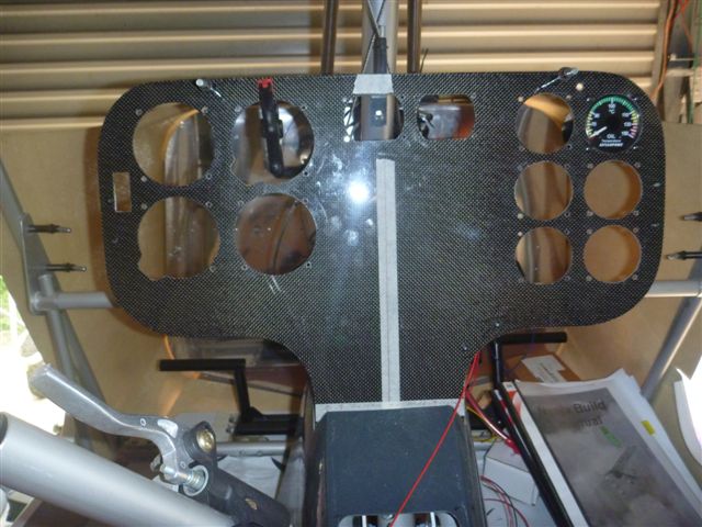

Peter008 Posted November 22, 2014 Share Posted November 22, 2014 Started cutting out the pamel. Only done the 2 1/4" guage holes waiting for the 3 1/8" holee saw to arrive.All good superglued the furry edges of the fibres on the hole ID and sanded with sandpaper wrapped around a wine bottle neck; the finish was perfect. (A great idea that someone else though of and I used.) Cheers Mike What is the material that you are drilling Mike? Is it a fibreglass / Lexon type material or a lamipanel? Link to post Share on other sites
Blueadventures Posted November 22, 2014 Share Posted November 22, 2014 What is the material that you are drilling Mike? Is it a fibreglass / Lexon type material or a lamipanel? Hi It' a carbon fibre lay up so the edges are a little fury compared to fibre glass/ polyester lay up. Cheers Mike 1 Link to post Share on other sites
Blueadventures Posted November 22, 2014 Share Posted November 22, 2014 Might stick your tach up where your CHT is Mike............ Hi Ross Does that allow better viewing of the Tacho? Also i'm placing the radio and transponder at the top to allow better viewing of the radio display. Cheers Mike Link to post Share on other sites
skeptic36 Posted November 22, 2014 Share Posted November 22, 2014 All good superglued the furry edges of the fibres on the hole ID and sanded with sandpaper wrapped around a wine bottle neck; the finish was perfect. (A great idea that someone else though of and I used.) Cheers Mike I used to use a beer bottle, but I found, after the fourth one, I couldn't see the hole properly anymore. It was also a bit rough on my lips as well....... 1 1 Link to post Share on other sites
Blueadventures Posted November 30, 2014 Share Posted November 30, 2014 This weekend I got the panel cut and have fitted some of its gauges etc. Cheers Mike 2 Link to post Share on other sites
gregrobertson Posted November 30, 2014 Share Posted November 30, 2014 The radio and transponder are much better placed at the top of the panel. Ross also has a good point regarding the tach. The most important thing is that the instruments are where you want them . That is what is so good about building your own aircraft. Making good progress Mike. Greg. 1 Link to post Share on other sites
Blueadventures Posted December 2, 2014 Share Posted December 2, 2014 The radio and transponder are much better placed at the top of the panel. Ross also has a good point regarding the tach. The most important thing is that the instruments are where you want them . That is what is so good about building your own aircraft. Making good progress Mike.Greg. Hi Greg I have now placed the tacho on top row. Agree good comment from Ross. Cheers Mike Link to post Share on other sites
Guest Maj Millard Posted December 2, 2014 Share Posted December 2, 2014 Hi RossDoes that allow better viewing of the Tacho? Also i'm placing the radio and transponder at the top to allow better viewing of the radio display. Cheers Mike Yes it would Mike....you'll be watching it a lot...it needs to be front and centre so to speak. I would also swap the altimeter with the turn co- coordinator....just my thinking...... Link to post Share on other sites
Blueadventures Posted December 3, 2014 Share Posted December 3, 2014 Yes it would Mike....you'll be watching it a lot...it needs to be front and centre so to speak. I would also swap the altimeter with the turn co- coordinator....just my thinking...... Thanks Ross. I also sent a email about when you have a chance to get down this way. Cheers Mike Link to post Share on other sites

Blueadventures Posted January 10, 2015 Share Posted January 10, 2015 Almost finishd the panel with the switches and choke method in place, most of the wiring is in place. Doing the throttle inner wires today; as I placed the outer cables yesterday. Bit of a squeeze locating and fitting the carb heat, fuel pump, strobe and taxi / landing switches and circuit breakers and also the start switch. I'm happy with the placements. Hoping no rain next weekend and should get the wings back on and get the windscreen fitted and the door upper hinge piece fitted. Cheers Mike 1 Link to post Share on other sites

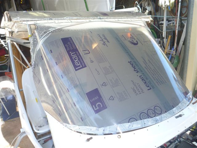

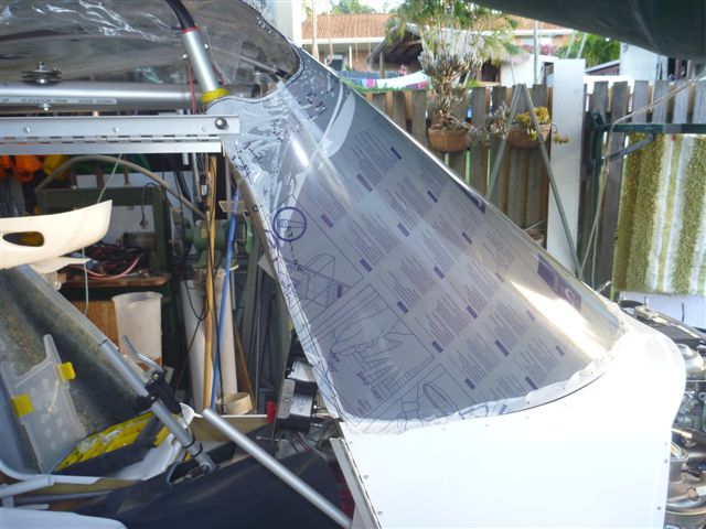

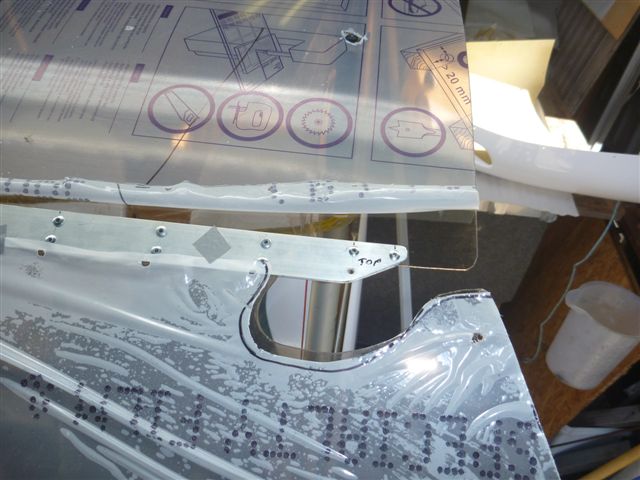

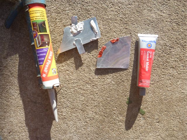

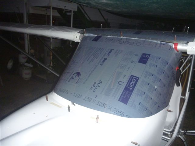

Blueadventures Posted March 5, 2015 Share Posted March 5, 2015 Finished the windscreen and back lexan shaping and fit so starting to look more like it should, next will be the cowl camlocks and the sealing of the firewall to fuse scuttle with fireproof silcone. Cheers Mike 1 Link to post Share on other sites

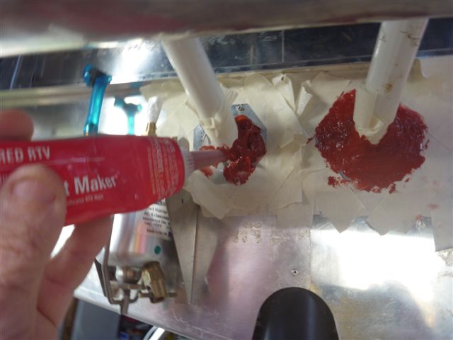

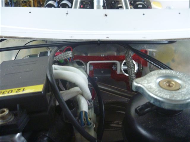

Blueadventures Posted March 19, 2015 Share Posted March 19, 2015 Finished the windscreen and back lexan shaping and fit so starting to look more like it should, next will be the cowl camlocks and the sealing of the firewall to fuse scuttle with fireproof silcone.Cheers Mike Finished the sealing of the firewall gaps so may get the windscreen in this weekend. 1 Link to post Share on other sites
ricky m Posted March 19, 2015 Share Posted March 19, 2015 very nice build, I built a 582 standard version 9 years ago in the uk G-CDDR, and loved every minute spent with The DR ...even the freezing cold nights in a single brick garage with just a small blow heater whilst building it... was also lucky enough to spend my last few months living in the uk working for flylight airsports the uk importer. enjoy :) they are great to fly and easy to maintain. 1 1 Link to post Share on other sites

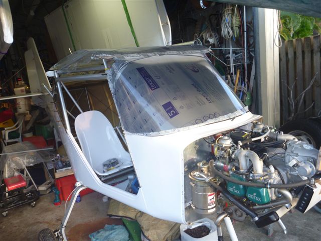

Blueadventures Posted March 19, 2015 Share Posted March 19, 2015 very nice build, I built a 582 standard version 9 years ago in the uk G-CDDR, and loved every minute spent with The DR ...even the freezing cold nights in a single brick garage with just a small blow heater whilst building it... was also lucky enough to spend my last few months living in the uk working for flylight airsports the uk importer. enjoy :) they are great to fly and easy to maintain. Thanks for the info Ricky. The build is starting to get to the looking good stage. If I get windscreen in this weekend along with the top an back riveted it will look more like i'll fly. I'll keep the plastic on the lexan and make up the windscreen cover to further protect the lexan during the build. Cheers Mike 1 Link to post Share on other sites
Blueadventures Posted March 21, 2015 Share Posted March 21, 2015 Now have the windscreen fitted. So I can now fit the upper engine cowl camlocks and start on the doors between other build jobs. 1 Link to post Share on other sites

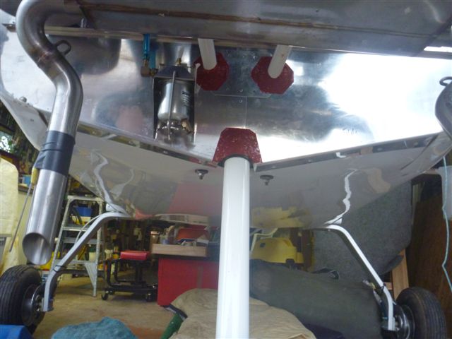

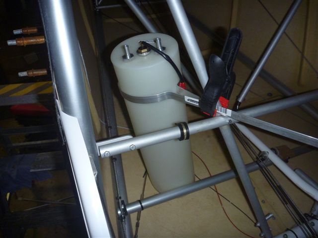

Blueadventures Posted March 21, 2015 Share Posted March 21, 2015 Lookin' good Mike! 90% done, 90% to go eh? Hi Scott Yes that sounds right. A long way to go but would be just past half way. I'll get a straight 5 or 6 days on the build in about two weeks so should get the two piece doors and probably fit the fuel tanks into the wings and fit radio units and some wiring. I'm soon to sort the fuel supply. I'm fitting a savannah collector tank as it has a low fuel sensor fitted as standard and its inlets and outlets are 9.5 mm so I'm wondering if the 6mm feeds from the two tanks in the wing are suitable to feed this surge / collector tank, or should I fit 8mm outlets in the wing tanks? Any comments appreciated. Cheers Mike Link to post Share on other sites
cscotthendry Posted March 22, 2015 Author Share Posted March 22, 2015 Mike: Re the fuel lines. It's a toss up. My attitude would be "what's the simplest or lightest solution?" With two tanks supplying the header, the 6mm lines (I'm assuming 6mm ID lines, not OD) will supply plenty of fuel. In fact each line by itself would supply the engine on its own. With two lines and gravity on your side, you'll have zero problems with sufficient flow rate. So it boils down to one opinion or another. However, Greg may be better able to point you one way or the other because of something that neither of us has thought of. Link to post Share on other sites
gregrobertson Posted March 22, 2015 Share Posted March 22, 2015 Hi Mike. Use at least 8mm ID fuel hoses from the tanks to the header tank. I tried 6mm but they get an airlock as there is no vent on the header tank. 8mm seems to work well maybe 9.5 mm would be even better. Greg 1 Link to post Share on other sites
Blueadventures Posted March 22, 2015 Share Posted March 22, 2015 Hi Mike.Use at least 8mm ID fuel hoses from the tanks to the header tank. I tried 6mm but they get an airlock as there is no vent on the header tank. 8mm seems to work well maybe 9.5 mm would be even better. Greg Hi Greg Thanks for the info. Fully agree. I'm not ready for fitting the tanks yet but will start planning soon. I though it may be ok to feed the two 6mm feeds from the tanks into a single 9.5 mm hose into the collector surge tank and also have the vent line from the surge collector tank venting back to the one of the tanks from the other top outlet in the surge tank. I'll give you a call through the week about it. Do you recommend any changes to the fitup with the new tanks fitted recently? I got the cam locks in today and I'm happy with the cowl fit. I'm out of town this week so won't get any more done during the week. Regards Mike 1 Link to post Share on other sites
