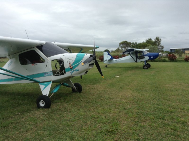

image.jpg.3c06715e085f64db377473b58ef08e0b.jpg For the past coupke of years I've had my 3 blade Powerfin pitched fairly course for best cruise, as that is what I was doing most of. Was only getting about 5100 wot at takeoff heavily loaded, with 700 fpm climb, ( flaps) and cruising level at 5000 RPMs straight up.
Just de-pitched the prop a couple of degrees and now getting 5300-5400 at take off with good climb, 5000-5100 cruise RPM, slightly better fuel economy and same or better airspeed.
Prop now seems much more lively and happier allround. Haven't lost anything, but gained more safety RPMs at takeoff.
The 100 HP Rotax likes to be loaded in my opinion and you know your using all the HP available. My engine has just turned 900 hours and always run on the cooler end of the scale with both radiator and oil cooker half blanked off. Sometimes I'll remove the oil cooler one here in the northern summer but leave the coolant one on year round. They seem to be a little happier if running warm.
