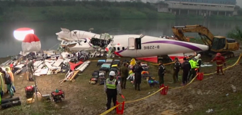

Rotorwork Posted February 4, 2015 Share Posted February 4, 2015 I have to buy one of those dash cams Hard to believe passengers survived this crash, another with Asia in the title! http://www.abc.net.au/news/2015-02-04/taiwan-plane-crashes-in-taipei-river-people-killed/6069950 11 persons are feared dead after a plane carrying 58 people crashed into a river in Taiwan's capital Taipei, the local fire department says Of the 58 people on board, 28 were rescued, the fire department said in a text message. Taipei City government spokesman Sidney Lin told Focus Taiwan news channel the TransAsia Airways plane crashed into the Keelung River after hitting a bridge. Dramatic pictures taken by a motorist and posted on Twitter showed the plane veering over a motorway close to the airport soon after the turboprop ATR 72-600 aircraft took off. A senior rescuer at the site said those yet to be rescued were thought to be trapped inside the submerged front section of the plane. "The focus of our work is to try to use cranes to lift the front part of the wreckage which is submerged under the water and is where most of the other passengers are feared trapped," the rescue official told reporters. Earlier, television footage showed passengers in life jackets wading and swimming clear of the river with rescuers standing on large sections of broken wreckage trying to pull others out of the plane with ropes. The accident happened a few minutes after the plane took off from Taipei's Songshan airport en route to the island of Kinmen Thirty-one mainland Chinese tourists were among those on board, Taiwan's tourism bureau said. China's Xiamen Daily newspaper said on a verified social media account the Chinese tourists were part of two tour groups from the eastern Chinese city Xiamen. "All their phones were powered off because they were on board a plane, so we haven't been able to contact them," an unnamed representative of one of the tour agencies told the newspaper. Xiamen is in Fujian province, which lies across the Taiwan Strait from the island. An employee of one of the tour agencies, surnamed Wen, said it had 15 clients, including three children younger than 10, and a tour leader on board. "It's an emergency," she said. "We're working with different work teams. We're trying to arrange for the relatives to go to Taiwan." Local television news reported 53 passengers and five crew were believed to be on board the domestic flight. Reports said all those rescued were taken to hospital. Last July, 48 people were killed when another domestic TransAsia flight crashed onto houses during a storm on the Taiwanese island of Penghu. Link to comment Share on other sites More sharing options...

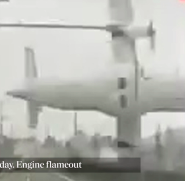

Guest ozzie Posted February 4, 2015 Share Posted February 4, 2015 Looking at that close up footage (@15sec) as it crosses the road, compare the left and right props, seems like they may have lost power on the left engine and have not feathered the prop. Link to comment Share on other sites More sharing options...

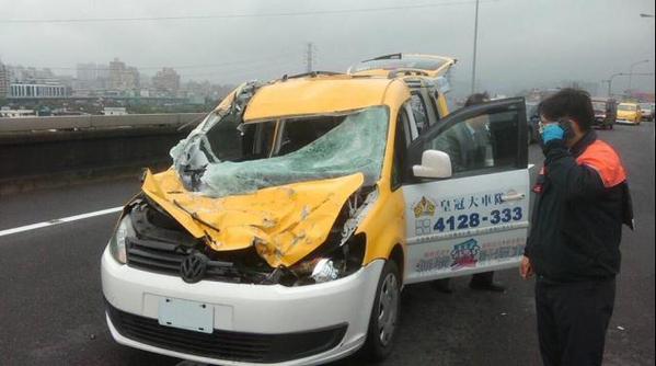

Guest ozzie Posted February 4, 2015 Share Posted February 4, 2015 Some very very lucky people in the taxi that you can see being hit in the dash cam footage and there is a report on another forum that they did radio an engine flame out after take off. Amazed anyone got out of this. Link to comment Share on other sites More sharing options...

facthunter Posted February 4, 2015 Share Posted February 4, 2015 Think most of that type of aircraft have auto feather built into their performance envelope A turboprop engine can absorb about 3 times it's rated thrust as drag if you don't get the prop feathered. Nev Link to comment Share on other sites More sharing options...
Guest Howard Hughes Posted February 4, 2015 Share Posted February 4, 2015 Over torque? Hardest scenario I've ever done in a simulator, never ends well. As someone who fly's turboprops, I will be watching this one with interest. Link to comment Share on other sites More sharing options...

Guest Howard Hughes Posted February 4, 2015 Share Posted February 4, 2015 http://www.reuters.com/article/2015/02/04/us-taiwan-airplane-idUSKBN0L808520150204 Early accounts have it as an engine flame out, seems odd that the autofeather has not worked. Link to comment Share on other sites More sharing options...

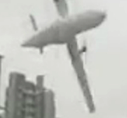

winsor68 Posted February 6, 2015 Share Posted February 6, 2015 Is it my imagination or is big chunk of the left hand propellor missing? Link to comment Share on other sites More sharing options...
fly_tornado Posted February 6, 2015 Share Posted February 6, 2015 Link to comment Share on other sites More sharing options...
winsor68 Posted February 6, 2015 Share Posted February 6, 2015 My Imagination...? Link to comment Share on other sites More sharing options...
fly_tornado Posted February 6, 2015 Share Posted February 6, 2015 hard to say really Link to comment Share on other sites More sharing options...
facthunter Posted February 6, 2015 Share Posted February 6, 2015 That trail doesn't look right. Perhaps someone has doctored it. I based my assumption of left engine fail on the appearance of the prop and the way the wing dropped. Not entirely conclusive. Nev Link to comment Share on other sites More sharing options...

facthunter Posted February 6, 2015 Share Posted February 6, 2015 It relies on the engine feathering quickly to achieve single engine performance.. A turbo prop will absorb more power to windmill the prop than if gives thrust, so it is critical the prop be feathered quickly. they also have complex pitch locks to prevent overspeeding the prop which is a serious hazard . Nev Link to comment Share on other sites More sharing options...
