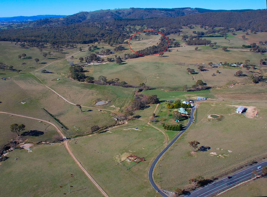

Guest mudjeep Posted October 3, 2007 Share Posted October 3, 2007 I've just recently bought 100 acres near Tarago NSW. The land is undulating but there's a spot where I can fit a 400m strip with a 3 degree slope. Luckily it's pretty much into the prevailing wind. I'm not exactly sure of the process yet but I imagine I'll need to spray it, plough it, level it and seed it. It'll be fenced from the horses (about 35m between fences - does that sound enough?) but we are thinking of letting alpacas graze it when not in use (light hooves). Our main driveway will cross it (I get to put up a "Give way to aircraft" sign!) and will also double as taxiway for a short distance. Our house will sit on the hill and overlook the strip. I'm going to buy a tractor with a box scraper (combined dozer/grader/scarifier/ripper) and a loader and hope to do the whole lot myself. With a bit of luck construction will commence around Christmas. I'm also thinking of writing a story about it for one of the magazines. Link to comment Share on other sites More sharing options...
