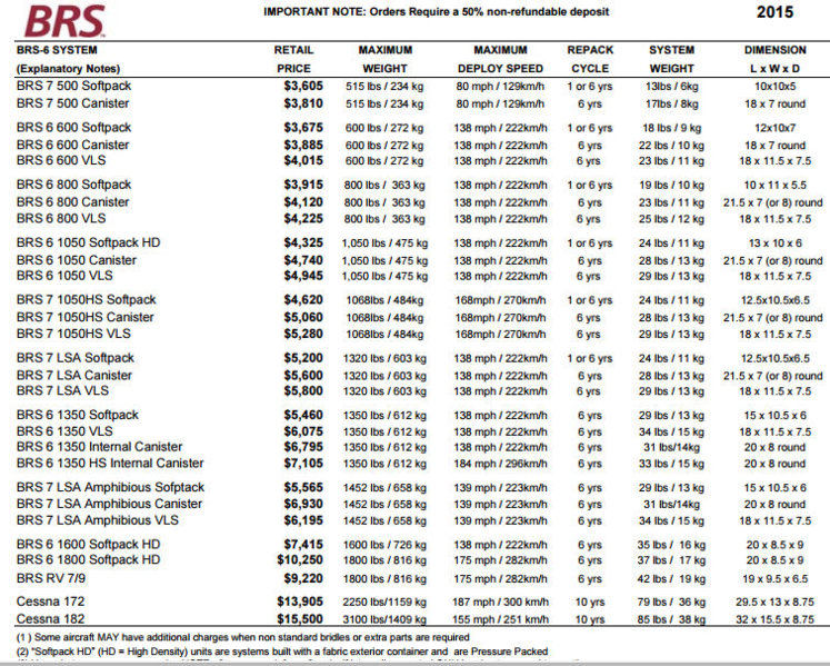

bexrbetter Posted April 25, 2015 Share Posted April 25, 2015 You can get spring loaded chutes too you know. I've been in contact with these guys for some time, extremely helpful .. http://www.brsparachutes.com/ 2 Link to comment Share on other sites More sharing options...
