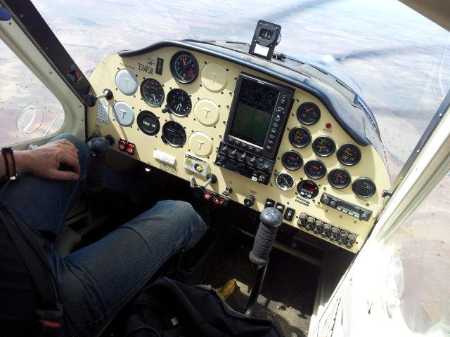

85kts @ 4800 rpm with GT prop. Taken from my photo which also shows 4,500 AMSL with nil climb/descend and hands off stick. One up, 80 litre fuel load.

Yesterday took brutus Bravo to 2000 feet - OAT would have been 25 degrees - 150 kilos of pilot and fuel - no wheel fairings - standard timber prop
flew one way - then reciprocal back - it was a lumpy day and suspect plane was in lift and then sink .......... not the best day for record taking
rough recording was as follows - speeds were (REVs: IAS / GPS)
OUTWARD
5000: 103 / 95
5200: 104 / 94
5400: 119 / 110
INWARD
5000: 103 / 105
5200: 104 / 110
5400: 110 / 114
5600: 115 / 118
