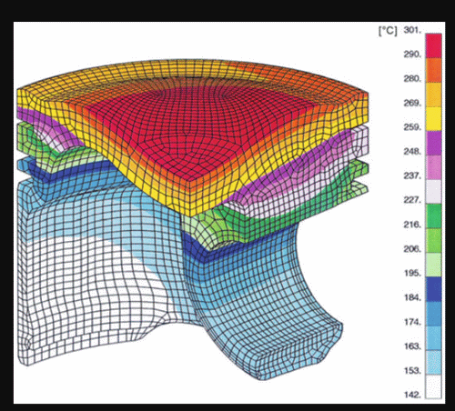

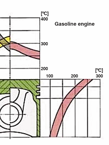

RFguy Posted April 12, 2021 Share Posted April 12, 2021 Which means before goign crazy on cooling the bores all the way round, one has to be confident the piston temperature is down also, otherwise cooling the bores may have unwanted repercussions. You would 'guess' that cooler bores would mean cooler pistons and less piston expansion. I wonder if the amount of clearence/slap can be heard and detected to get some handle on this. I wonder if a sudden rush of cold air in the front could cause a fast cooling of the bores and generate a jam Link to comment Share on other sites More sharing options...
facthunter Posted April 12, 2021 Share Posted April 12, 2021 Not in a W slot engine which depends on a good temp difference in the piston for the idea to work. When the crown is much hotter than the skirt it forces the ovality to reduce and thereby counters the normal expansion process which seems pretty cunning except a lot of ovality reduces skirt contact with the cylinder wall and is then cooled less effectively. than if it was near round. Nev Link to comment Share on other sites More sharing options...
RFguy Posted April 12, 2021 Share Posted April 12, 2021 (edited) The piston temperature is a complex beast : (wet jacket cylinder bores) https://x-engineer.org/automotive-engineering/internal-combustion-engines/ice-components-systems/internal-combustion-engine-piston/ Edited April 12, 2021 by RFguy 1 Link to comment Share on other sites More sharing options...
