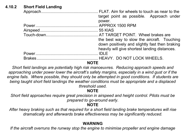

Maybe practice some short strip approaches with your instructor . (landing on the keys and bringing it to a stop quick)
 IMO that's a good exercise in improving approach technique.  my experience with that is that I  must fly a slow  and stabilized approach to put down on the keys and stop in minimum distance .
have a read in the J230 POH "4.10.2 Short Field Landing"
Edited by RFguy
The Jab book is reasonable, IMO. I think the NOTES jab provided here are pretty well on the mark.
any comment , others ?
short fields are worth practicing with instructor...

Clipboard01.gifHaving read the notes attached to this post, I am further convinced to not fly a Jabiru. Why is a short field approach and landing any more risky than any other?
Basically the POH says to drag it in, low and slow with power. The risk is if the engine quits, you've got no safety margin in airspeed or height.
