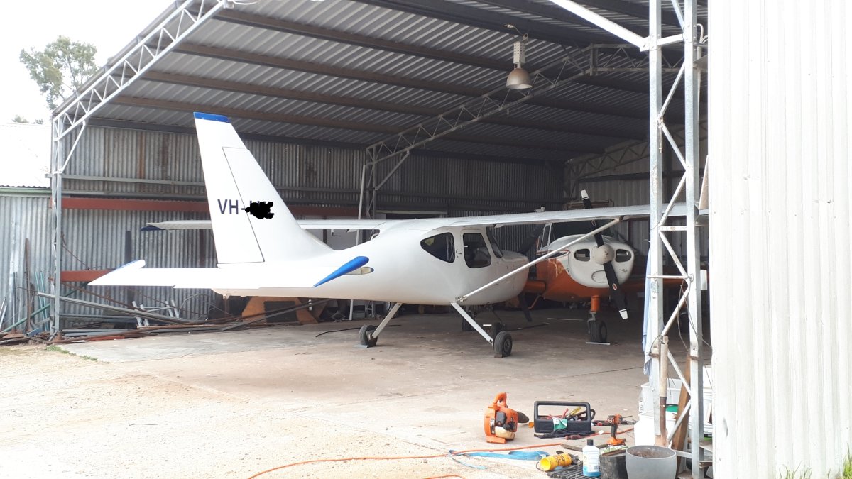

WELL an interesting event for engine builders and interested . Pls do not pollute this forum with flippant comments, understood?
-finally got the right time in a hangar available to to the First oil change after the rebuild.  27 hours
Leakdowns  80 80 80 80 80 50.
The 80/80. well I couldnt beleive it, so I cranked up the pressure and 90/90 ! Very very difficult to get it up at TDC and hold it, the plane moves.
Well, I guess I did that job right. BUT Now, what about this CYL # 6 ??? hissing out of the inlet and exhaust valves
I feel can ONLY be more head recession causing the valves to not full close. It had recession before (#6), lots of it.
Pull off rocket cover. YEP  ZERO clearance. cant push lifters back, valves never fully close.
Recall I shortened all the pushrods before because the stock Jabiru ones were TOO LONG (and Jabiru admitted this - they went to shorter rods)  (insufficient tappet clearance ).
Short check leave for 10 minutes with each valve open to bleed down a possibly pumped up lifter . Nope. used to have 0.5mm here.
Some clues !!!
1)  About 6  hours ago I noticed the static was very slightly down
2) That cylinder has been running cool. Cool in CHT and EGT. Makes sense now eh ????
When the others were 160CHT/680 EGT  in climbout , that one was 20 deg less.
When the others  were 140 CHT/710 EGT  in cruise, that one was 115CHT, 610EGT ! Reduced  fuel/air charge ....
My mantra as you all know is 165 C MAX on top because I measured 20C higher underneath at stationary 2000 RPM. .
But, I know that the underneath of CYL#6 is absolutely starved of airflow and thus is COOKS the Ally under the head around the lower (hidden) head screw....
So, grounded while I think about what to do next.
Either the head under there is getting still hotter than I estimate OR the previous long term overheating degraded the aluminium.
-glen
