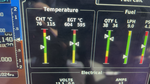

BirdDog Posted May 16, 2021 Share Posted May 16, 2021 Hi all, I have a Rotax 912ULS with just over 400 hours on it and I noticed something today that I have not noticed before. (this was on the ground at around 2300 RPM, after just landing from an hour of flying) The right side CHT would creep up to just below the Yellow Zone (see attached pic) about 117 degrees C. It would sit there for a 20 seconds, and then it would drop back to down to be equal with the other one. The EGT are all stable etc, so has me beat. Thoughts? Link to comment Share on other sites More sharing options...
skippydiesel Posted May 16, 2021 Share Posted May 16, 2021 Faulty sensor??? Faulty wiring/connector??? We all tend to treat our various engine condition read outs as accurate - at best the automotive type sensors & gauges (if steam) are indicators ie not precise. Faults at both the sensor end and head (gauge) end, are very common. 1 Link to comment Share on other sites More sharing options...
BirdDog Posted May 17, 2021 Author Share Posted May 17, 2021 Yeah - don't know! I will pay closer attention to it next time, but it did appear like it was say when the thermostat would kick in, and the engine would cool, then it would close, and it would heat up again. If you know what I mean. But weird that only on one side. I need to look at where this sensor is! I have Left and Right! So is it one Cyl on the left and one of the right? Link to comment Share on other sites More sharing options...
skippydiesel Posted May 17, 2021 Share Posted May 17, 2021 27 minutes ago, BirdDog said: Yeah - don't know! I will pay closer attention to it next time, but it did appear like it was say when the thermostat would kick in, and the engine would cool, then it would close, and it would heat up again. If you know what I mean. But weird that only on one side. I need to look at where this sensor is! I have Left and Right! So is it one Cyl on the left and one of the right? If its a Rotax 912 you will have left & right cylinders - CHT is not coolant temperature (although pretty closely associated) - You have stated that EGT's are even -- suggesting same combustion heat on each side. So I still think sensor or wire. I always advise going with the simplest lowest cost option first - so check your wiring make sure insulation is good and all connections firm. If that doesnt fix the problem, try swapping CHT sensors and see if the problems moves with the sensor. 1 Link to comment Share on other sites More sharing options...
BirdDog Posted May 17, 2021 Author Share Posted May 17, 2021 Thanks Skippy. So I take it only one cylinder on each side is monitored? Link to comment Share on other sites More sharing options...
IBob Posted May 17, 2021 Share Posted May 17, 2021 The earlier 912s had CHT sensors (on the underside of the heads), the later ones are not CHT but coolant temperature (sensors on the top side of the heads). The cylinders monitored are 2 & 3, which is front left and rear right. My 912 has the coolant temp sensor, and L appears to run a bit cooler than right, which makes sense as the L is a front cyl and the R is a rear cyl. Link to comment Share on other sites More sharing options...
IBob Posted May 17, 2021 Share Posted May 17, 2021 So far as I know, the 912 does not have a coolant thermostat. Have you checked your coolant level? There is a little window in the coolant reservoir on the top of the engine, where all the hoses run to. With the engine cold, you should be able to see a coolant level there. Link to comment Share on other sites More sharing options...
facthunter Posted May 17, 2021 Share Posted May 17, 2021 That type of response is as if there is a local hotspot or airpocket. Nev Link to comment Share on other sites More sharing options...
skippydiesel Posted May 17, 2021 Share Posted May 17, 2021 3 hours ago, BirdDog said: Thanks Skippy. So I take it only one cylinder on each side is monitored? In evry set up I have seen only one cylinder per side is monitored - usually a front/rear diagonal. Link to comment Share on other sites More sharing options...
