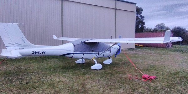

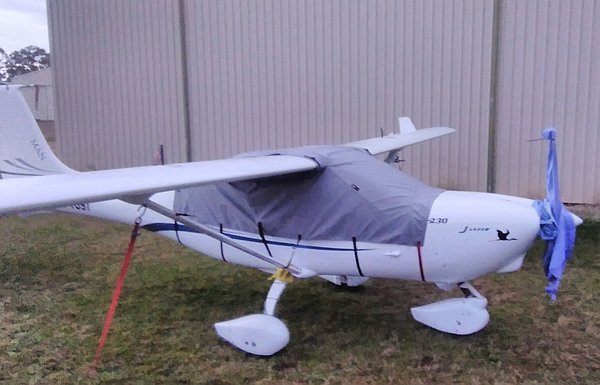

RFguy Posted July 14, 2021 Share Posted July 14, 2021 (edited) Really very sophisticated constructed cover. excellent value for money , nice sail cloth stuff with felt liner. fits well, no slop and no fluttering in the wind. Additional velcro seams for attachment to full all over cover. photos. (not sure if I have the ties around the struts right, I think I need to extend the straps (variable) full length and go around the leg.) I put it on for the first time in the near dark. Edited July 14, 2021 by RFguy 1 Link to comment Share on other sites More sharing options...
mkennard Posted July 14, 2021 Share Posted July 14, 2021 That's a different setup than mine. Mine covers the cowling and the bottom half. I can't find a photo with mine on. Link to comment Share on other sites More sharing options...

RFguy Posted July 14, 2021 Author Share Posted July 14, 2021 These ones are Weathermax fabric, better for shrink than the Sunbrella material (am told). And the velcro doesnt get attached to the lining. It's nice kit. Link to comment Share on other sites More sharing options...

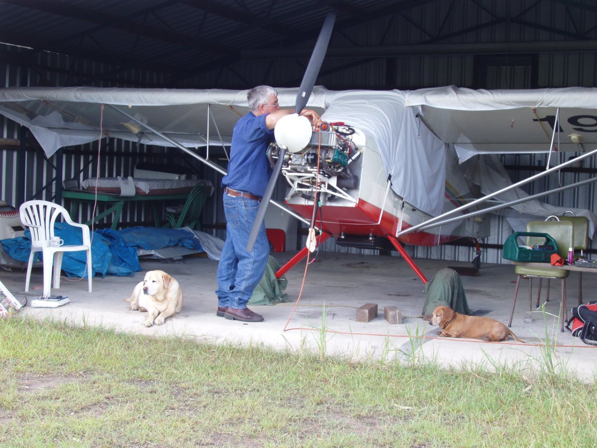

FlyingVizsla Posted July 15, 2021 Share Posted July 15, 2021 Our Punkin Head cover taken Feb 2008. The covers on the wings were made by an upholsterer. 2021 and they are brown with all the dust & muck in the hangar, but the Punkin Head cover is still looking good and clean. Highly recommended. This was the honeymoon - we spent it in the hangar. 1 Link to comment Share on other sites More sharing options...
kiwiaviator Posted July 17, 2021 Share Posted July 17, 2021 I have the same one on my 230 Glen. Great covers and yes, I have the side straps around the main spring. Link to comment Share on other sites More sharing options...

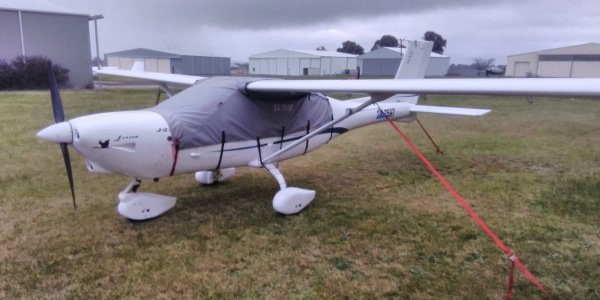

RFguy Posted July 18, 2021 Author Share Posted July 18, 2021 (edited) Got the straps right now... image before prop and cowling covered. Repegged after the winds and rain of last few days. despite the glum wx, got 0.8 in yesterday. fixed a CHT sensor. This material is reasonably heavy/stiff compared to some I've felt. Wont flap in the wind. Will move under cover before too long. Was in hangar until April. Sun/temp is not too strong down here this time of year. Edited July 18, 2021 by RFguy 2 Link to comment Share on other sites More sharing options...
