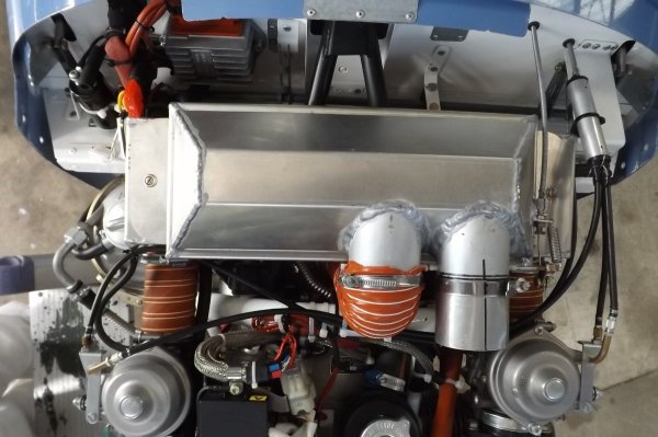

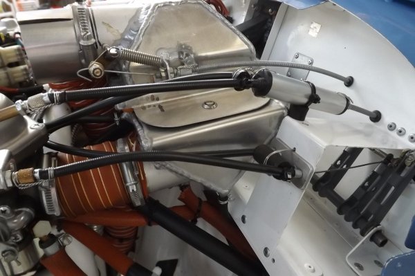

IBob Posted December 7, 2022 Share Posted December 7, 2022 Skippy, I think part of the problem is that we label this particular control as a choke, because that's the sort of function it performs, and that's how we are used to thinking of it. And I am no different: mine is labelled 'choke'. But as others have stated here: 1. It is actually a starting carburettor. 2. The throttle also needs to be fully closed for it to function (because it is this full closing of the throttle that provides the necessary 'choking'.) Here is mine.....labelled choke: 1 Link to comment Share on other sites More sharing options...

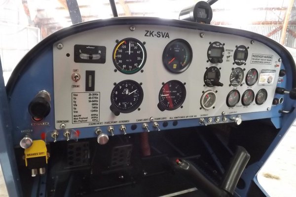

RFguy Posted December 7, 2022 Share Posted December 7, 2022 Vso 26-30 kts ? and Vne 124 kts wow ! you can get in and out of short strips AND chase the Germans in a vertical dive Link to comment Share on other sites More sharing options...
IBob Posted December 8, 2022 Share Posted December 8, 2022 RFGuy them's the numbers........however with that fat wing and various other gear hanging out in the breeze, the reality is you'd need to be doing something well past radical to reach 124kts. As most owners will agree, the Sav is happy at about 85kts. Anything much above that and there is very much the sense that you are pushing it..........) Link to comment Share on other sites More sharing options...

IBob Posted December 8, 2022 Share Posted December 8, 2022 Glen, I know nothing about Jabiru engines, and just a bit about the Rotax 912 since I own and maintain one, so have a particular interest there. I do understand the importance of the float bowl vent, as providing appropriate float bowl pressure (in the Sav the vent/s are plumbed into the airbox downstream of the filter, which makes sense). I am fortunate that my enrichment (aka choke) has a free action, and shuts positively as soon as released. I hadn't thought about carb heat, but try not to make that a set and forget thing: I can set various degrees of that, so tend to return and adjust it when in use. Having said all that, it is perhaps 800m of taxiing from touchdown to my hangar and any time I have pulled the plugs they look very rich. However, my fuel consumption is certainly not excessive and the thing has run like a dream from new, so I have just assumed that the Bing setup runs rich near idle. You say the Jabiru was about right, now rich after LCH? I'm not quite sure what you mean there??? 1 Link to comment Share on other sites More sharing options...
