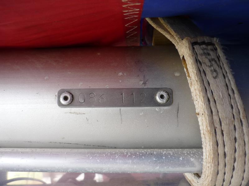

FlyingVizsla Posted January 18, 2011 Share Posted January 18, 2011 I guess what you are really asking is "how long can a RAA aircraft last with minimal maintenance?" Any aircraft can last indefinitely under the "My Grandfather's Axe" principal (It's my grandfather's axe, we replaced the handle 5 times and the head twice - ie there's nothing of the original left). As the owners of a number of aging recreational aircraft we have battled with the constant need to "maintain" them. Fabric needs renewing, cables, fuel lines, rods, tyres, etc all need replacing. These things sneak up on you with RAA and often left to your judgement. One day you look at it and decide to take it out of commission pending major work - it costs a lot in time and money. The temptation is to keep pushing your luck and keep flying it. Our Wheeler Scout is in a shed waiting for wing recovering, the turbulent is likewise sitting because the glued joints are suspect, the Karasport is due for a rerigging, we've just finished replacing all the fuel & static lines in the RANS. Engines & props wear out. Occasionally someone breaks them. Or it floats away in a flood. GA has maintenance schedules, so when the engine is at its hours it has to be (expensively) rebuilt. I knew people who bought GA aircraft and ran them until the engine ran out of time, then had to sell cheap because they could not afford the rebuild and the buyer had to run the risk the engine would not come up to spec. Owning an aircraft is a lot of peaks and troughs, if you want to hold on to the one aircraft for years. It may be better to buy new, sell after a (couple?) of years while it is still looking good and not due for major work and buy another new / near new and keep cycling through that way. I am looking at one of the troughs now - the C152 is due a paint job - that means new fibreglass tips, cuffs, plastic interiors, some skin work, renew anthing that looks sad - the paint is the cheap part. Sue Link to comment Share on other sites More sharing options...
farri Posted January 18, 2011 Share Posted January 18, 2011 Any aircraft can last indefinitely under the "My Grandfather's Axe" principal (It's my grandfather's axe, we replaced the handle 5 times and the head twice - ie there's nothing of the original left). Sue Whenever I have to submit the total number of hours that my aircraft has flown, I scratch my head and wonder.............."Well which piece do you want first"? My Drifter is 25 years old. ( Still Original of course ) Frank Link to comment Share on other sites More sharing options...
