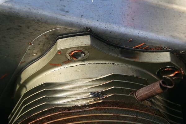

Also can't anyone else recognise that the cylinder in the picture has been loose for a few hours before the snap?
Look at the wear pattern around the nut area.
If it was a clean break you'd get in indentation matching the nut, and maybe cracks/chips around it.
If it was a loose bolt under little tension/movement you get the 'blackening' that I'm sure you've all seen in loose spinner/cowling bolts.
That looks to me like places where something has been loose and experiencing high force for a reasonably short period of time (my guess would be a few hours)
If a through-bolt was loose, the force on the base of the barrel become uneven and invloves a bending moment, this could lead to the crack as an over stress crack.
Once that happened the uneven force on the bolt would snap the head off, and also the uneven force (because of the con rod) would make the other 'top' bolt the next to go. Once they snapped the cylinder was still 'working' but less compression/less force, and the bottom ones held in to stop the cylinder snapping off and releasing hell in a handbasket.
I will be contacting the Chad/Andrew to see if there was evidence of wear on the other side cylinder.
I see it that my life might hang on working out how to stop this happening to mine.

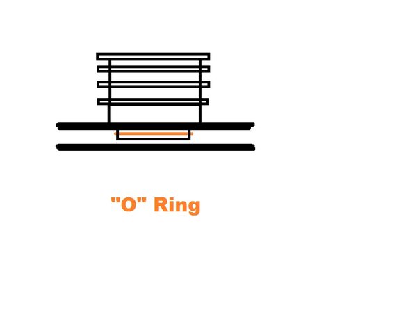

I'm not too sure how accessible the cylinder bases are out in the field, but since the statistics seem to show that an early warning of thru bolt failure is a black residue leaking out, I would be recommending at least a weekly pre-flight involving a torch, and mirror on an extension, or a $300.00 camera probe, rather than wait for a forced landing.
I would be interested in Jabiru's reason for the coppermax sealant to be added to the O Ring, because an O Ring is a perfect sealant (if diameter and groove dimensions are correct) and is designed to compress to allow metal to metal contact thus providing a permanent pressure seal. Any additional, or loose, silicon would be superfluous.
Black residue leakage would be an indicator that the faces had come apart far enough to de-compress the O Ring, so that is consistent with what's been happening in the failures.
Having decided to apply the Coppermax, I think what Jab's conflicting instructions refer to, is on the inside of the O Ring, wipe away any visible residue once the O Ring is sitting in the groove. On the outside of the O Ring any residue is only going to be squeezed to the outside of the engine, and that's easier to remove when dry. And of course when you are applying silicon you make sure there is no dirt on your hand, bits of grass etc. Licking a finger will ensure the silicon doesn't stick to it.
