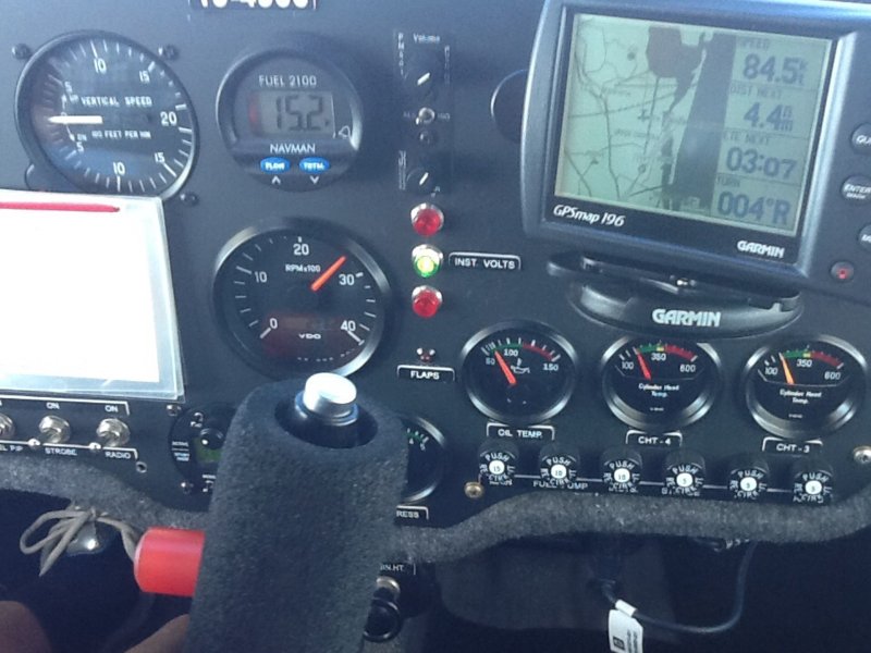

This is what all should be aiming for ...... ( CHT's bottom RHS ), and that's in degrees Fahrenheit . Admittedly on descent into Southport , but normal cruise temps only slightly higher . Engine No 2200A/2787 , around 2009 , fine finned heads , no head stud re torquing required since new , now around 350 hours . Bob

This is what all should be aiming for ...... ( CHT's bottom RHS ), and that's in degrees Fahrenheit . Admittedly on descent into Southport , but normal cruise temps only slightly higher . Engine No 2200A/2787 , around 2009 , fine finned heads , no head stud re torquing required since new , now around 350 hours . Bob[ATTACH=full]27021[/ATTACH]
Now THAT is the sort of Plastic Jesus I want on the dashboard of MY plane! I do believe the appropriate term is 'relaxed and comfortable'..

biggles, those temps look great, and nice and even aswel. Are they as marked? 3 and 4? One of our jabs (170) has always ran very cool in CHT and oil temp. While the 160 has always been a hot engine. CHT's routinely 30 or 40 deg's hotter than the 170, but still within the specs. The hottest engine (j) we have seen was in a 230 a few years ago. Always hot, always pushing the limits of the quoted specs. Pilots needed to fly it very particularly or risk over heating it. It never suffered a breakdown while online with us, but did suffer valve failure some years later when with another school.
