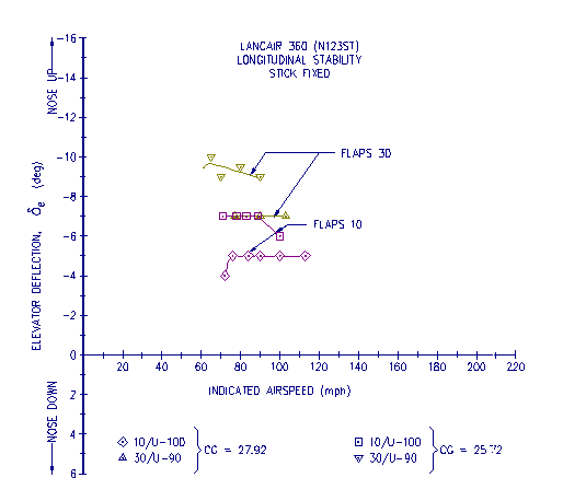

djpacro Posted November 1, 2013 Posted November 1, 2013 Stall stick position is not very useful in something like this Lancair 360. Treat the vertical scale as stick position.
facthunter Posted November 1, 2013 Posted November 1, 2013 That's why I said as a concept. If you reconfigure the plane. Flaps, GEAR, C of G, Change Horiz.stab trim etc it doesn't apply except to each separate condition standing alone. Since the elevator(s) are the main way the pilot controls angle of attack and the pilot is usually the one who stalls the plane, the pilot's actions re the elevator position is the cause and the cure of the problem. Thrust or power comes into it as well, but few mention it. Nev 1
Oscar Posted November 1, 2013 Posted November 1, 2013 Quote Stall stick position is not very useful in something like this Lancair 360.[ATTACH]23931[/ATTACH] Treat the vertical scale as stick position. The Lancair 340/360 is, statistically, one of the most deadly things ever to take off (after, possibly, the Messerschmidt 163, though I believe it may well have flown better than a Lancair..). Read the original CASA flight testing report; from memory, it dropped a wing violently to 70 degrees or so in a stall, repeatedly, with a highly-experienced test pilot doing the testing. About the only really safe position for the stick in one of those is to put it in a small concrete bunker and leave it there.
David Isaac Posted November 1, 2013 Posted November 1, 2013 I think Uncle DJP is sh!t stirring to be honest. I can see the smirk on his face as he wrote that ... he knows how bad they are ... LOL
djpacro Posted November 1, 2013 Posted November 1, 2013 No,seriously, I have come across people who have done some advanced stall training - no flaps, single CG position and in an aeroplane with ample longitudinal static stability - and happy to proceed to stake their life on Stall Stick Position applying in aeroplanes with characteristics like that, blithely unaware of the limitations that Nev outlined. The concept is not new - see the Chapter "The Silver Chain" in Wolfgang's excellent book from 1944, Stick and Rudder. Quote The so-called “elevator” is really the airplane's speed control, or, if you want to state it accurately, its Angle of Attack control. This shows how you can keep yourself from stalling or spinning in! Stalls and spins are caused by having too low a speed or—what is practically the same thing—too high an Angle of Attack. All right, simply do not move the stick into the position where it will force the airplane to fly at stalling speed (or at stalling Angle of Attack). Simply do not let that hand creep back. For an airplane cannot stall and cannot spin unless the stick is held back in the stalling position! Remember this simple fact. It is of the utmost importance for every pilot; unless the stick is in the stalling position, an airplane cannot stall and hence cannot spin. Stalling position of the stick in most airplanes is nearly all the way back if the power is off, and perhaps about two-thirds back if the power is on. Just what it is in your airplane it is very much your business to find out. Now from this you might easily get the idea that to keep yourself from stalling and spinning in all you'd have to do would be to buy 10 cents' worth of wire and tie the stick loosely to some structural part of the airplane; so that regardless of how confused or panicky you might become in ome emergency, you simply could never pull the stick farther back than so far—say to the position for 15 degrees Angle of Attack or say a speed of 10 m.p.h. Above stalling speed. Thus, you might think, the airplane would be rendered unstallable. This would then solve one of the biggest problems of aviation, the terrific death rate from accidents, since most fatal accidents involve a stall. And it would also cut out much tedious training—all the practice of stalls and spins. You might think you had a big idea there! THE FOOLPROOF AIRPLANE The strange thing is that you would be right! Ten cents' worth of wire will make any airplane unstallable, will solve one of aviation's biggest problems, and will simplify flight training enormously. It is very worthwhile to read the rest of the Chapter, if not the whole book. 1
Oscar Posted November 1, 2013 Posted November 1, 2013 Quote I think Uncle DJP is sh!t stirring to be honest. I can see the smirk on his face as he wrote that ... he knows how bad they are ... LOL I'm positive he does! - but there is a deeper message, I think - and one to which DJP alludes above: that simply training to 'go through the motions' in sequence in a benign aircraft does not necessarily render you immune from entering a really bad situation in something with quite different and far more savage characteristics. Obviously any decent familiarity with the basics is way better than none at all - but that familiarity ought to be reinforced with some decent and reliable information about the characteristics of something that will 'bite'. By way of example: drivers who are entirely familiar with sliding a front-weight-biased car safely, used to find themselves facing the wrong way in an early Porsche 911s very, very quickly (and uncatchably!). The situation was already happening before the tell-tales became obvious. 2
