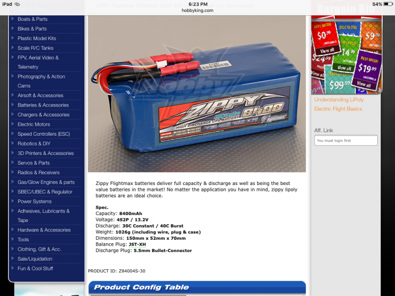

I,m thinking of putting the hobby king zippy flight max lifepo4 (see attached pic) as a replacement to my odyssey. At $125 and 1kg. The price and weight and various advantages make it an attractive choice. I would like to hear from members that are using this battery, specifically, in a Jabiru 230D, how they have physically installed this battery and their experience in using this type of battery and any other helpful comments that I should be aware of. Cheers
As I said above....I have consistently used Lifepo batteries in aircraft for a number of years. They were of the brands Antigravity and EarthX. I have used all variants of LiPo/Lifepo4 etc in hobby use for RC aircraft for many years as well. I have had no issues with the brands I used in my aircraft but (given my experience with RC hobby batteries) would not recommend using the RC variants because you really need do need something to act as a shut off in low or high voltage or balancing cells type situations. The EarthX has a BMS inbuilt for that purpose. The best option IMHO.
Unless weight is an issue (my issue) I do not think they are worth the expense/risk. If you must use one then choose the EarthX brand - very expensive but built for purpose.
PS I have a suitable EarthX here, used no longer in use if you want it PM
  • Winner 1
Id assume you realise under LSA (unless E 24 reg) you cant fit this without Jabiru approval?
  • Haha 1
