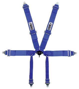

Old Koreelah Posted May 12, 2015 Author Posted May 12, 2015 Quote ...With a six point you have two chances of detaching the crown jewels instead of one... Ouch! Turbs that got my attention. One Crow harness appears to have its lower straps wider than most; it looks like they go either side of the legs:
turboplanner Posted May 12, 2015 Posted May 12, 2015 My eyes are still watering Marty! OK, I'd ask how they work. If they are attached permanently to those buckles, then when you sit down the waist strap will come across your pelvis and the smaller strap across your leg. To me you could still submarine, but the mounting positions they set may squeeze you enough. 1 1
Marty_d Posted May 12, 2015 Posted May 12, 2015 From the pic I'd say you step through the waist/leg straps which look like they're permanently attached, latch them, then your shoulder ones come down through the loops near the buckle and latch in also. Submarining can't occur and hopefully the jewels are safe as the sideways pressure of the straps is in an outward direction. Looks good for a cockpit you step down into but wonder how it'd work for normal side-entry cabin.
turboplanner Posted May 12, 2015 Posted May 12, 2015 Problem with that is that you have to be dragged out through them, and if there's a fire you only have seconds to get someone out who may have a broken leg. That's what I like about Simpson - one pull and you're out of it and running. 1

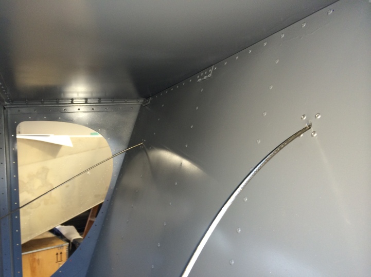

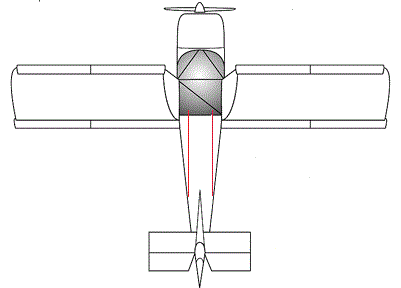

Old Koreelah Posted May 18, 2015 Author Posted May 18, 2015 Quote ...There's no hard points on the 701 for 4 point harnesses...[ATTACH=full]35691[/ATTACH] That's a bit of a problem, Marty. Seems like a slight oversight on the part of the designer. I used your solution on my BRS harness. The cables are anchored on the rear wing attachment points. Looks like your 701 has slats. Are they fixed or automatically deployed like Handley Page? The tailplane seems quite narrow, presumably for trailering.
