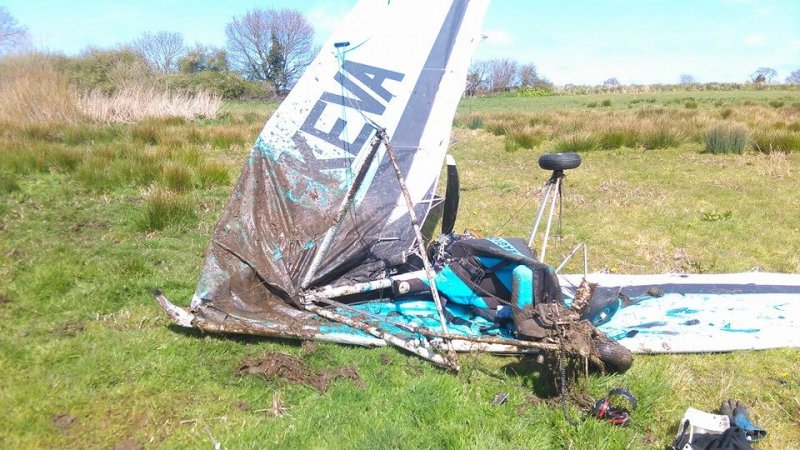

OUCH ! Engine failure ?
Just had this posted on Fizzogbook by my mate Kev Armstrong,. . . . he posted it ten minutes ago ( 13:28 bst ) so he's obviously not that bady broken. . . .( Neither is his smartphone evidently )
Waiting for details. That's not his home fireld so it could be power failure without a suitable landing field.
Will update. ( light damage should buff out easily I would have thought )

Gee Phil looks like a mess glad your mate survived that.
Thanks Teck,. . . .Kev is an engineer par excellence, and in the forefront of various microlight developments in the UK, and a really nice bloke too.
He posted that picture from the crash site after crawling out of the wreckage. I have not got the full story yets, as this happened less than 2 hours ago. I only got the "Engine fail" bit secondhand, but that definitely doesn't look like any part of his airfield, although it COULD be near another he was visiting maybe. The trike is a single seater ( Was - sorry ! )

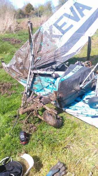

No more news yet, but another photograph uploaded by a friend.
I'm wondering about the poor blokes feet and legs, this aircraft had no pod, just simple footpegs.
This pic shows a bit more of the frontal detail.

I don't usually speculate but to me it looks like he landed nose wheel first on very marsh like ground. Wheel dug it, flipped him over and the mains never touched the ground at all. A very sudden stop. I'm not surprised his brain is not quite right at the moment. He's a lucky guy to be able to walk away from it.
Nope to first part - in a trike its not actually possible to land nose first - the trike hangs nose wheel high and in an engine out situation even if you push out really fast the wing pivots more than the trike angle of dangle changing. - take a look at the avatar image of mine with the EclipsR - nose in flight is about 12" or 30cm higher than the rear wheels ... and the thrust line of the trikes are usually set up with very little power impact on swing ... unless you are flying a 1980's early trike and then you have significant swing from power ... but the modern ones do not and the Magic trike Kev was flying does not.
And the Magic trike hangs quite nicely nose high as well.
The real issue looks to be bog and tuck under after getting the wheels down - if you have few options on where you arrive you take your best available.

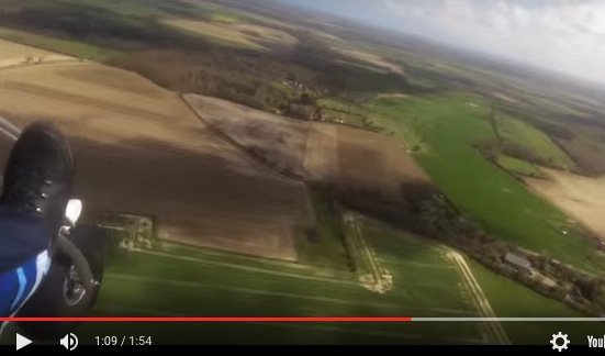

Kevin A. is back to posting his usual drivel on FB today, with no mention of his Whoopsie. . . .? Posted a vid showing American transports dropping vehicles on parachutes, with one in four of these falling to the ground unchecked. . . I guess he'll post a bit on the BMAA site when he's ready.
  • Caution 1
From the look of how the cloud shadows were moving, did he land with a bit of a tail wind? As said before, there were a whole lot of other options, but we can only say that in hindsight. I don't know if I'd do any better when the adrenaline starts pumping. I remember in my emergency training selecting what looked like a very smooth field to land in from 2000ft, only to find at about 500ft that it was a bit rough, but I was committed. You can't go changing your mind when you have no altitude, so you have to see it through. I'm glad he is ok.
The video is priceless, watching it got me thinking of my emergency training.
