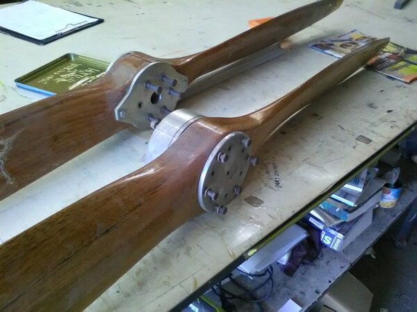

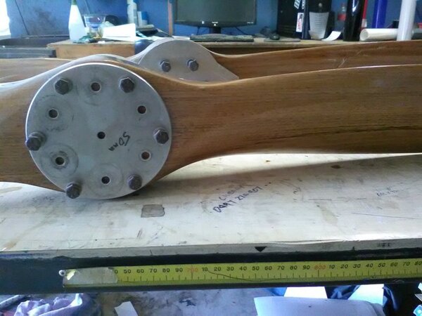

Aero28 Posted September 19, 2016 Share Posted September 19, 2016 Here is a couple I have made out of Tas Oak or Victorian Ash. The one with the cracks in it was on a belt drive Suby and didn't leave the ground , just taxiing, too thin near the root , (hub) and is two separate blades. The other one was for a 440 Kawasaki belt drive but I never got around to using it. These are both three laminations. I have since made one for a 503 from Celery Top pine which is a lot lighter and would think Hoop Pine would be a close alternative. To make these I use a n electric planer for roughing them out and a automotive buff with a 24 grit 8" disc to get the final shape. these buffs spin at slow speed so you don't remove a lot in a few passes. It is used in a buffing motion not a grinding action. I cut the plan shape first on a cnc machine then glue together with epoxy, thats my take on it so.....yes have a go, its very satisfying to see your handy work at the end. Cheers Paul. Link to comment Share on other sites More sharing options...

facthunter Posted September 19, 2016 Share Posted September 19, 2016 I would think you could do the flat side with a bandsaw and a jig to guide the twist. Watch out for sawdust. It's not as innocuous as we once thought. Computer guided spindle moulders may be the answer for large runs. Making stuff by hand is only as good as your worst worker. We used to get wood props for models that were filled with plastic after subjecting it to a vacuum to draw the moisture out.. Nev Link to comment Share on other sites More sharing options...
