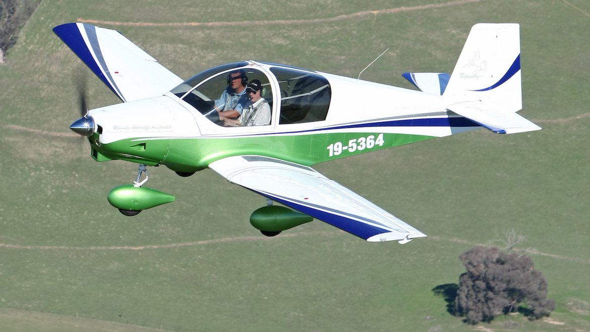

spacesailor Posted May 4, 2021 Share Posted May 4, 2021 " Brumby 610 is also available with a Lycoming O-233 116hp (87kW) . ". LSA 600. Just a quick Google ! a pic from lots of Brumby.s. spacesailor Link to comment Share on other sites More sharing options...
poteroo Posted May 4, 2021 Share Posted May 4, 2021 12 minutes ago, spacesailor said: rumby 610 is also available with a Lycoming O-233 116hp (87kW) . ". LSA 600 Pretty sure they are NOT. In fact, I'm unsure of whether the factory has completed any for sale in recent times? Link to comment Share on other sites More sharing options...
