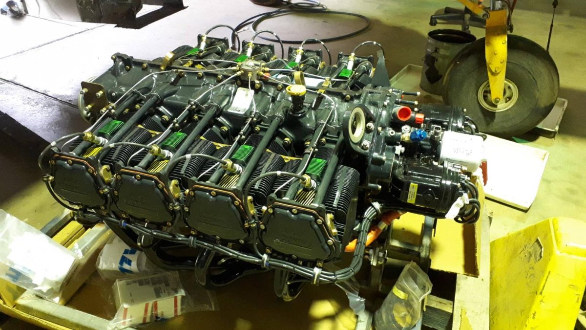

Thruster88 Posted November 8, 2020 Share Posted November 8, 2020 For some aircraft it is not about nostalgia, there are not any viable alternatives in the higher hp class. This 720 lyc will soon be making music with its 4 in 1 headers on each side. The prop makes the most noise. The rotax 912,914,915 are absolutely fabulous engines in their class. 3 Link to comment Share on other sites More sharing options...

skippydiesel Posted November 8, 2020 Author Share Posted November 8, 2020 3 hours ago, Thruster88 said: For some aircraft it is not about nostalgia, there are not any viable alternatives in the higher hp class. This 720 lyc will soon be making music with its 4 in 1 headers on each side. The prop makes the most noise. The rotax 912,914,915 are absolutely fabulous engines in their class. Great looking engine - certainly "presses my buttons" . The thing is, liquid cooled, high revving (geared) high horsepower, aircraft engines have been around for ever (I am fairly sure Continental had at least one). Nev will know for sure but the now accepted horizontally apposed air cooled donk has only been around since WW2. Unlike the automotive world little pressure & relativly small market have combined (with liability concerns) to make innovation in this area glacial. Rotax did not invent this wheel, however their popularity (despite high acquisition cost) proven ability to make an acceptable TBO, lower fuel consumption/reduce pollution, quite running continue to demonstrate what could be, in the rest of the market. In my simple mind it is the overwhelming influence of the USA market that is holding up development in this area. Your average "Septic Tank" seems to be besotted with the big bore (made in the USA) engine to the exclusion of all else. The Europeans on the other hand have, at least since WW2, been focused on fuel efficiency (in their land and air vehicles) and this seems to have driven their development efforts. In more recent times noise & air pollution have also been high on the agenda. Link to comment Share on other sites More sharing options...
