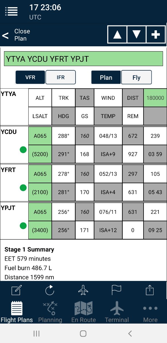

The best way is to enter the route details into EFB, then analyse the results.  Below is the extreme case scenario without stops, direct lines. Perth EOD today is 11:48UTC, subtract 10mins for landing time, and also departing early morning at BOD will give you another ~5 hours.
1377498570_Screenshot_20221218-100615_AvPlanEFB.thumb.jpg.1d12360d26e90969aff7879aa17f10c0.jpg

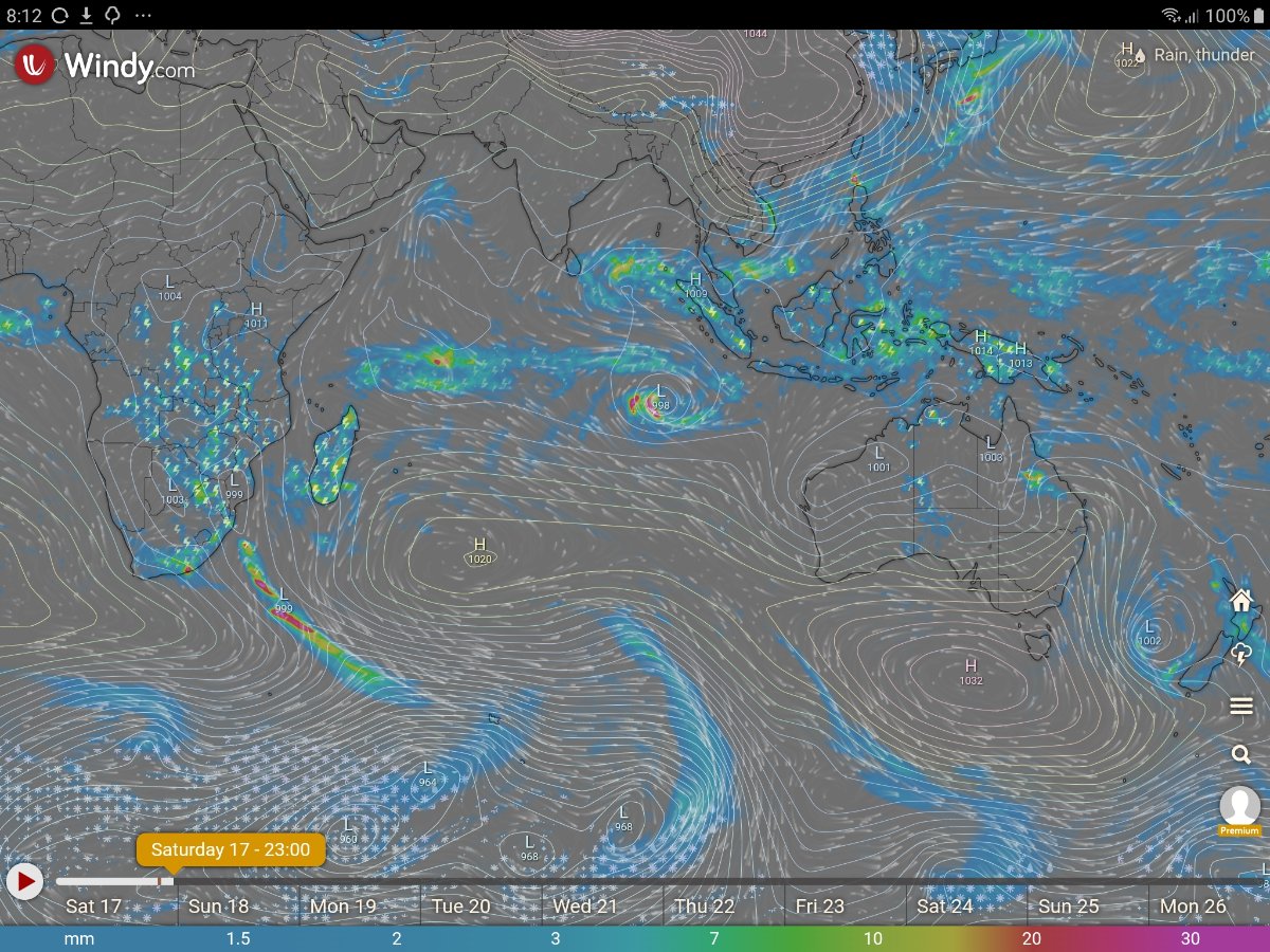

well, puttign aside the odd wx lately, per my post :
and I seem to have screwed up the previous calcs, re-doing :
Given that if you leave the east coast  just on the back of the previous bad weather, the next front will be crossing Perth
1737nm, 72 hour (3 day) period  between weather fronts.
but the next front is crossing the destination  at the time you are leaving
So it is inevitable that you will hit the  weather change. You cant avoid it, so one must plan an off day.
solving for time for intercept given Vx  (weather=24 kts) and Vy( plane =  125kTAS)
t = d/(Vy+Vx)  = 11.56hours to intercept - this assumes continuous flying. but you are not doing this.
So I'll re do this later to account for hours per day flown.
In fact, I will write an online tool for this.
Edited by RFguy
