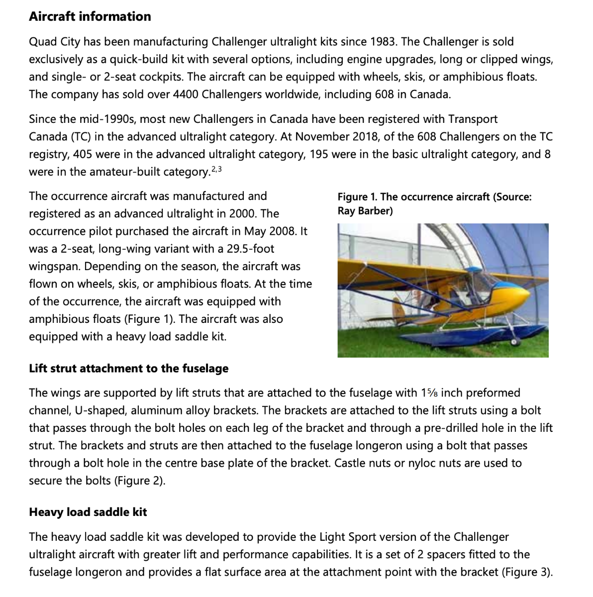

Looking for more detail, I searched for the video BrendAn referred to.
I think it's this one:
... which led me to the TSB Canada reports etc, that it was based on.
My takeaways from all that: first, just how seriously federal agencies in Canada take ultralight aviation and its safety. (Imagine so comprehensive a report being done by the ATSB on an ultralight crash, and RAAus, of course, doesn't have anything like the resources needed.)
And, second, that flying any fairly basic homebuilt ultralight might, itself, weigh-in on the pro side of a BRS installation, where practical.
After all, it's not like either this particular pilot/operator or the kit manufacturer were heedless or clueless regarding the importance of the wing bracket that failed. In fact, the manufacturer required that the part be replaced before 500 hours - as, indeed, it had been.
Anyway, I'm more convinced than ever just how crucial it is for all ultralight owners to keep a sharp pre-flight eye on lift-strut attachments (and to keep up a strict inspection schedule).  Hidden metal fatigue is still a killer, especially in aeroplanes built for lightness.
WWW.BST-TSB.GC.CA
Annual Report to Parliament 2019-20
EXERPT:
Risks associated with ultralight wing brackets
On 30 July 2018, a privately operated Quad City Challenger II advanced ultralight aircraft crashed into trees en route from North Bay to Rockcliffe, Ontario, after the right wing separated from the aircraft. The single occupant was fatally injured.
As part of its investigation (A18O0106), the TSBissued Aviation Safety Advisory A18O0106-D1-A1, “Quad City Challenger II Advanced Ultralight – Bracket Failure,” to alert Transport Canada to the possible risks associated with the failure of the attachment brackets that secure the wing lift struts on the aircraft.
Quad City, the Canadian distributor of the Challenger II, is conducting a stress analysis on the addition of a fixture to reduce flexing and spread loads around the bolthole, where fatigue cracks appear to start.
In response to the safety advisory, Transport Canada issued Civil Aviation Safety Alert 2019-02 to inform owners of the possible failure of the brackets and the need for disassembly, inspection and part replacement.

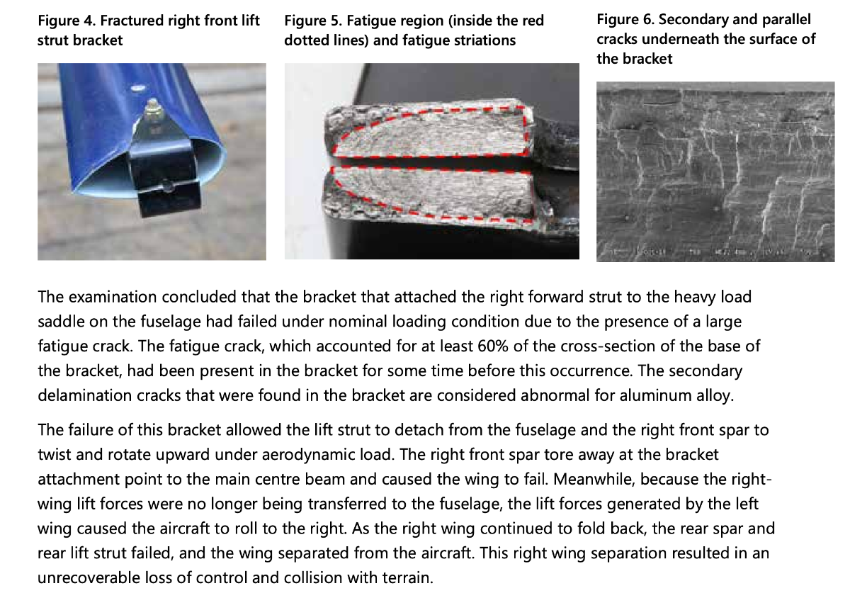

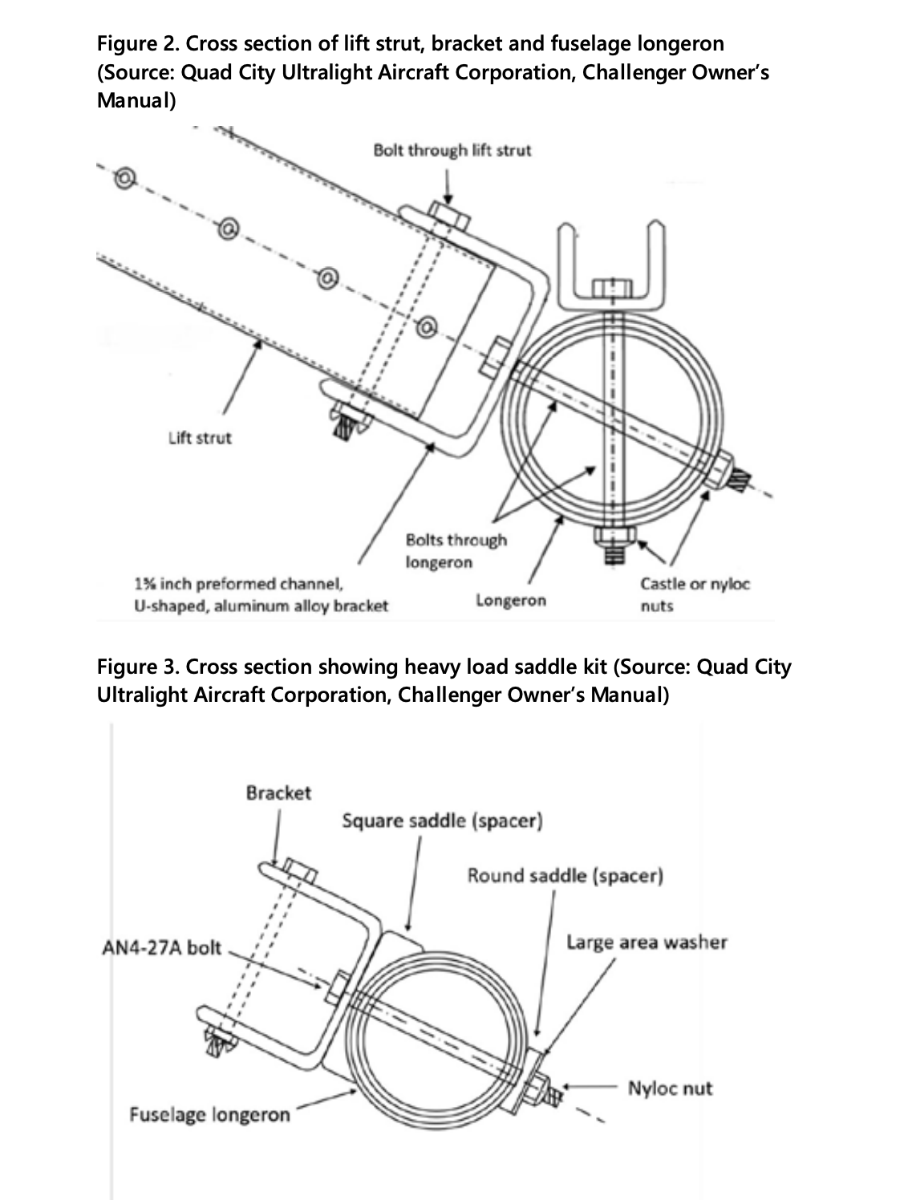

EXERPT:
Safety message
The lift strut brackets used on the Quad City Challenger II have been in service for 35 years and are installed on more than 4400 aircraft worldwide, of which 608 are in Canada. In this accident, a fatigue crack on the right front lift strut bracket went undetected during the routine inspection cycle undertaken by the pilot, and the bracket failed in flight before the 500-hour stipulated life span. The failure led to the right wing separating from the aircraft, resulting in an unrecoverable loss of control and collision with terrain.
Examination of additional brackets obtained from other aircraft, with various amounts of time-in-service, found that fatigue and delamination cracks are not isolated to the occurrence bracket.  As this occurrence demonstrates, it is possible for fatigue and delamination crack failures to occur on these brackets within recommended time-in-service limits and to remain undetected during basic manufacturer-recommended inspection practices. Cracks that develop on an airframe component need to be identified before the component fails completely. This is especially true when the component’s failure can result in an irrecoverable loss of control in flight.

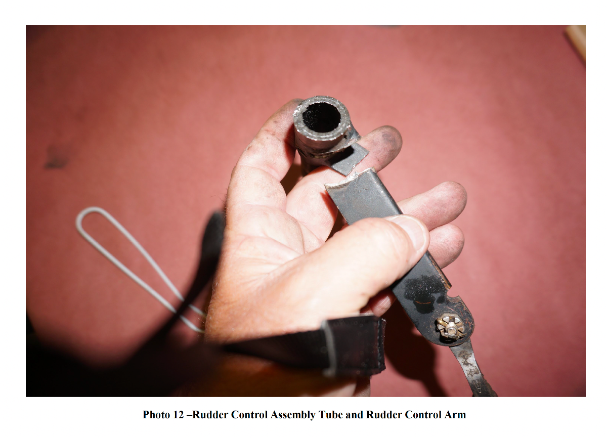

How can a broken rudder cause the aircraft to bank left? The only thing I can think of (which seems unlikely) is that there was a rudder trim spring/bungee that, in the absence of rudder control, pulled it hard left. Even in a go-around situation, it still doesn’t make sense.
Another alternative was that in the process of the go-around, the aircraft stalled, and the attempt to recover with the rudder failed either because the rudder was already broken, or it broke at that point. If that’s the case, then it wasn’t the broken rudder that caused the accident…
