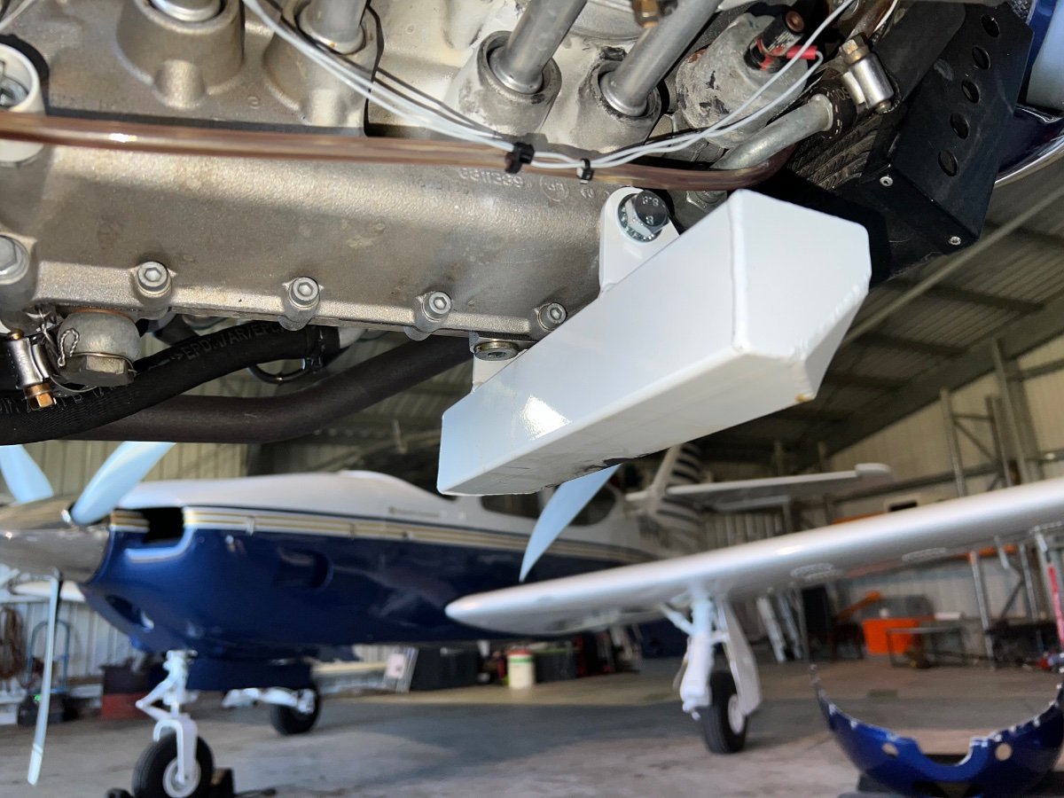

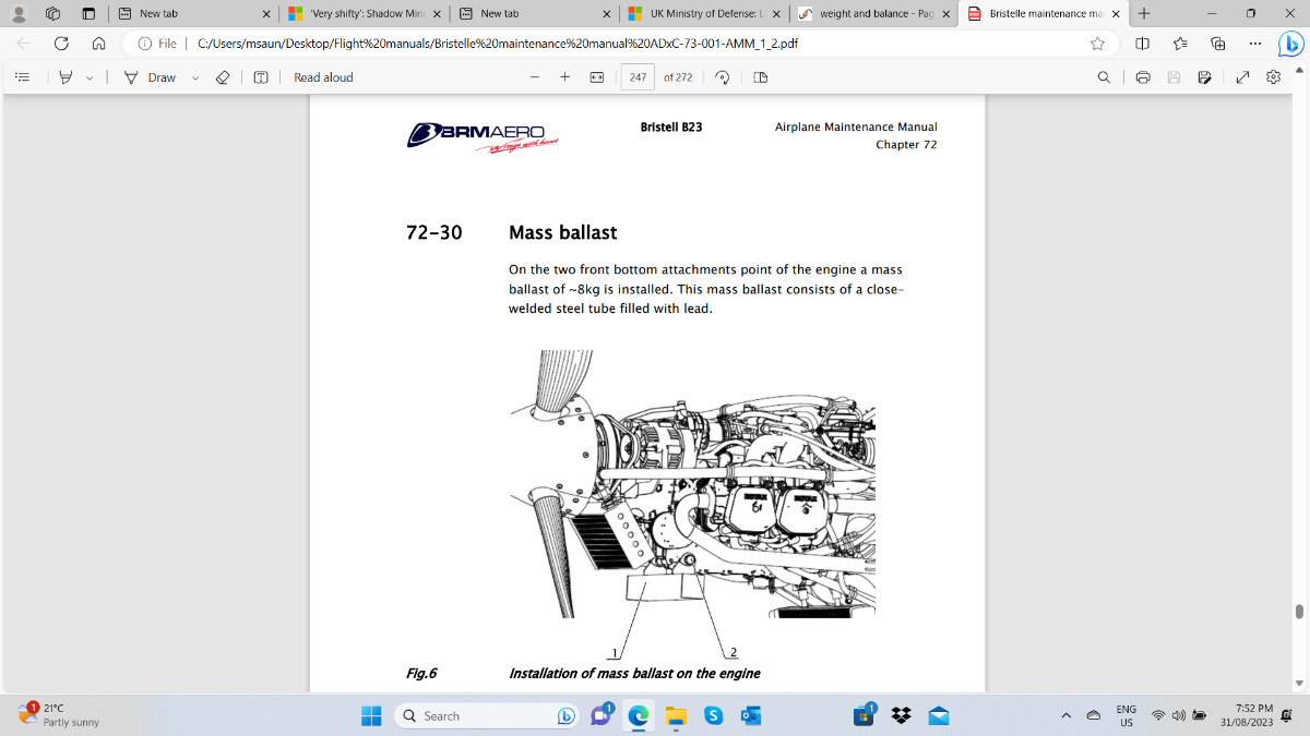

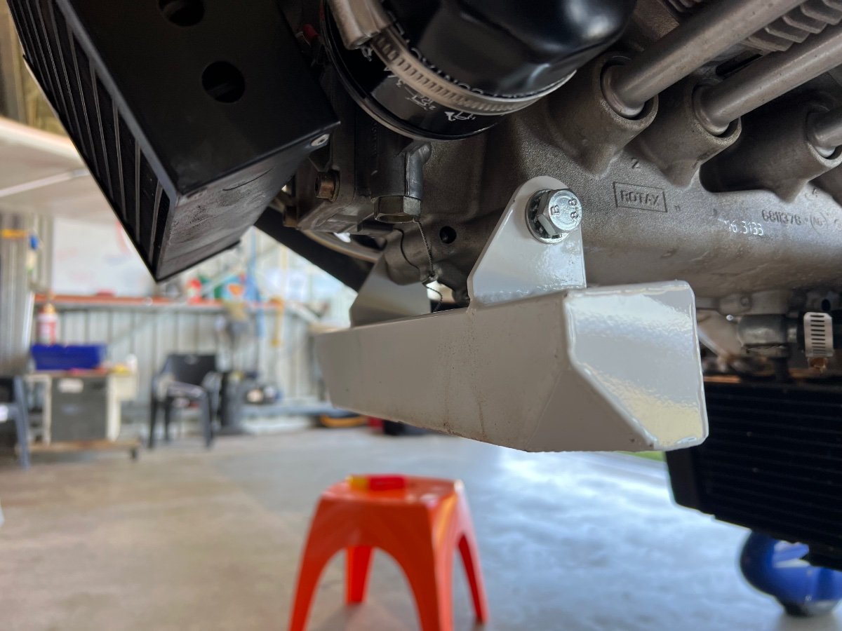

Bristelle are one example of secured 'Mass Ballast' that is bolted to the lower area of the engine mount.
Wow! I would not expect any factory built/supplied aircraft with standard fitments (engine etc) to require ballast - doesn't sound good to me.

I don't believe any have come from the factory like that. After the great crew moment arm debacle https://www.bristell.com/wp-content/uploads/2022/12/BRM-Safety-Alert-001_2020_R2.pdf Prior to that the POH had a loading example with two people of my weight shown to be within the aft limit. The revised POH omits that example as we'd be way behind the aft limit.
I wonder if they checked the strength of the engine mounting.

7 minutes ago, skippydiesel said:
Wow! that's some lump of non contributing mass - Would have thought they would have done something other than that,to achieve balance - moved the engine forward.
Not a good look for Bristelle
