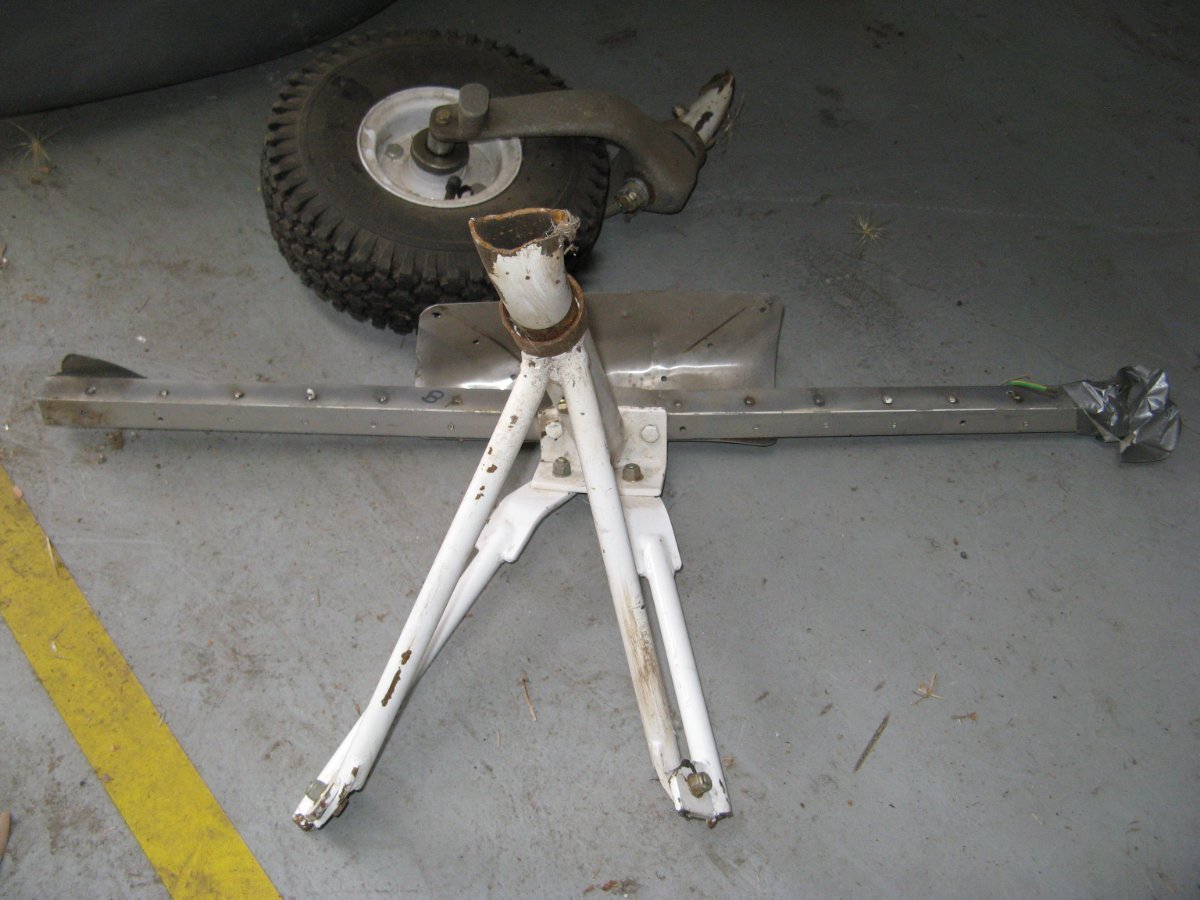

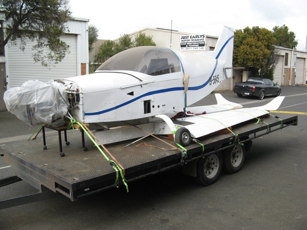

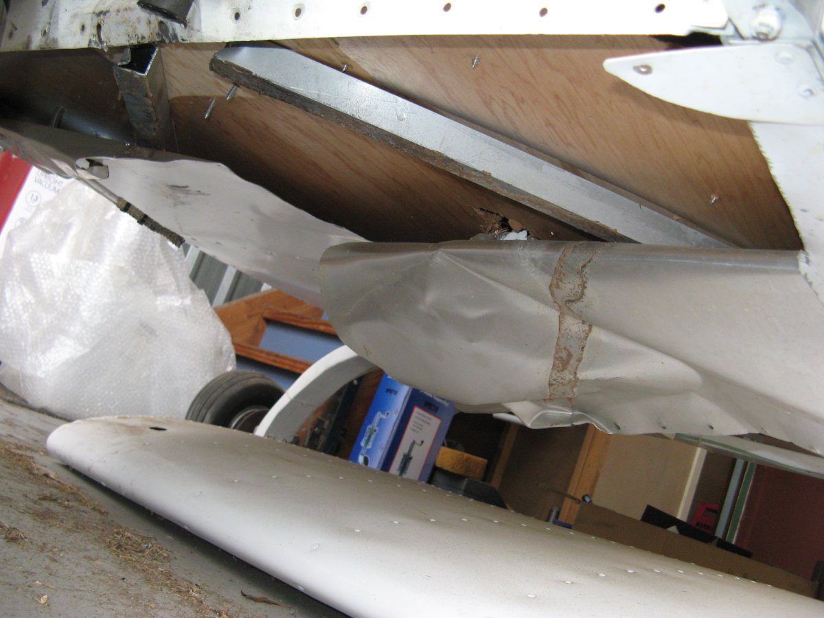

3rd harmonic Posted November 11, 2023 Share Posted November 11, 2023 Against what may be considered sensible or advisable, i decided that the buying a repairable wreck of a Morgan Sierra might a challenging and satisfying project!? As a brief history: The aircraft was built from kit supplied by Morgan Aeroworks and unfortunately after only a couple of flight hours, ended up suffering a loss-of-control on landing accident. Insurance was claimed for the value of the expected repairs which were substantial and although it wasn't considered a total loss, the salvage value of the wreck was not very high compared to the cost of the original build. The accident damage mostly confined to the nose of the A/C. nose wheel folded under and snapped off damage to the firewall and floor. Prop strike, prop destroyed. Engine mount cracked/bent/broken. Very minor damage to the winglets and wing leading edges right at the tip. The wreck was sold to a guy who trailered it to Melbourne, where it sat in a storage unit for about a year. I brought it off him and trailered him back to SA in an epic 2 day road trip. As pictured on a very large car trailer. I have chosen not to identify the original builder explicitly, to be fair as i don't know the guy at all. Of course there may be some sensitivity regarding the accident, i can only imagine it was NOT a particularly enjoyable experience. In anycase it's really not relevant to restoration going forward. Thing have progressed abit from here, but just an initial post to start the ball rolling... Ab 5 Link to comment Share on other sites More sharing options...
old man emu Posted November 11, 2023 Share Posted November 11, 2023 Did the prop strike the ground during the incident? I think that there is a mod to make the nose wheel assembly less prone to folding. Keep us posted with progress. Link to comment Share on other sites More sharing options...
kgwilson Posted November 11, 2023 Share Posted November 11, 2023 I built a Morgan Sierra from scratch starting in 2011 & completing the build in 2015. I have a bit over 400 hours in it now. I too bent a noseleg on about the 12th flight after a long float down the strip & then running in to soft ground. Replaced it & somehow made the new one 50mm longer. This time I almost wheelbarrowed, bounced & broke it properly including prop. There are plenty of horror stories of owners breaking nose legs but once you learn to land it, it's easy. I created a build blog on this site https://www.recreationalflying.com/forums/topic/13034-sierra-100-kit-build-underway/ so if you need any help just ask. What engine is in it & does it need a bulk strip? 2 Link to comment Share on other sites More sharing options...
3rd harmonic Posted November 11, 2023 Author Share Posted November 11, 2023 Yes, Thanks KG I have had a good read through your blog and also some of the others on the Morgan page, there's a gold mine of info and pics showing how others have resolved the same design in different ways. Good to hear that you've managed to fly it consistently, after some initial difficulties. The engine is a UL power 260is (NOT a Jabiru, which the plans suggest) I have had some correspondence with UL power about sending it back to the factory in Belgium to be overhauled and replacement crankshaft fitted ect For various reasons, not the least being the paying the $$$$$, I haven't done it yet... Link to comment Share on other sites More sharing options...
3rd harmonic Posted November 11, 2023 Author Share Posted November 11, 2023 1 hour ago, old man emu said: I think that there is a mod to make the nose wheel assembly less prone to folding. I'm sure that might help if the plan was to fix/replace the nose wheel. But I'm hoping to side step those issues entirely 😉 Link to comment Share on other sites More sharing options...
