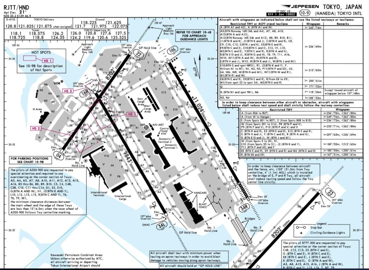

the runway was 34R, so confusion with 34L is a possibility...
its a shame with a dual runway that they don't have one dedicated to landings and another dedicated to take-offs.

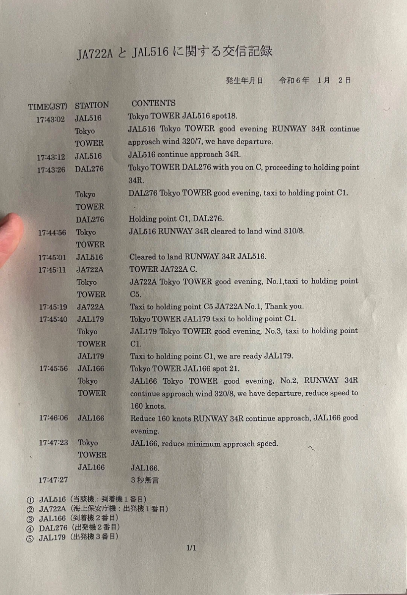

Audio from LiveATC.net appears to detail the crew reading back a clearance order for runway 34, saying “cleared to land 34 right.”
and from the financial post
At a press conference Tuesday night, JAL officials said they believed Flight 516 had permission to land, though they weren’t yet drawing conclusions. It wasn’t clear whether the coast guard plane was also given clearance to be on the runway — instructions were garbled on the ATC recording.

that's a good 7km out, I don't have anywhere near the experience to know if I could tell what parallel runway they are lined up for at that distance

surely the dash-8 would have made an "enter and hold 34R" just as the airbus pilot confirmed  "clearance to land 34R"

Apparently the dash-8 was told to taxi and hold, so maybe heard enter and hold. Only way it makes sense in my mind they are sitting on that runway not moving. And the garbled recording isn't helping.

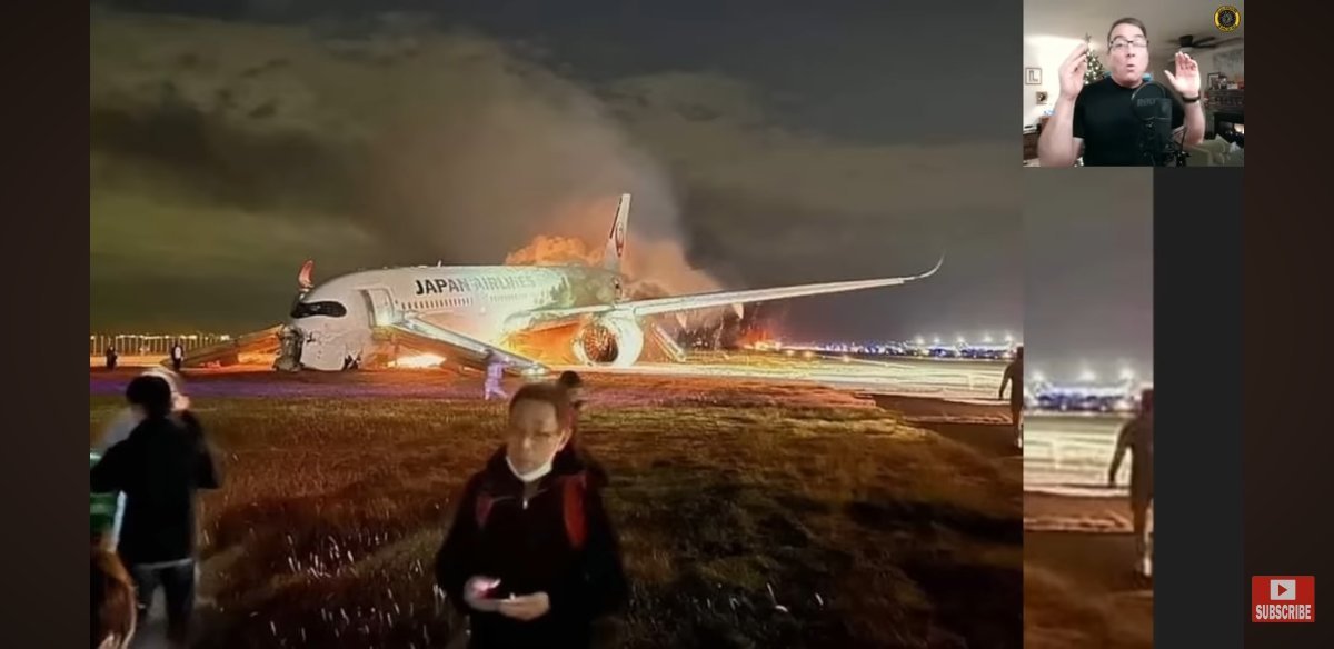

It is amazing that everyone aboard the A350 got off. The Japanese do seem to respond well to instructions as they were told to get out and not take anything & they did.
I've see other scenarios that end up in tragedies where stupid passengers are grabbing their hand luggage and others falling over them trying to get out. The resultant chaos that ensues ends up with injured people on the slides from failure to follow instructions, crashing in to one another, falling off or being hit by idiots and their luggage. It seems ridiculous but it has happened and has all been videoed.
Whilst Japanese are highly organised, disciplined and proud nation, they are still humans, with common "flaws", therefore they should not be idolized.
The lady at the photo below looks like having a backpack.
However, I am now more concerned about ATC's, pilots and other survivors wellbeing.
They should not be idolised or STEREOTYPED. There were cockpit Tyrants in all races. .  Legends in their own lunchroom. ACE of the Base etc.  Nev

This crash demonstrates to me (as Juan Browne said) the importance of correct readback of ATC instructions. The commercial transcript is not clear & while in English, it is with a heavy Japanese accent & seems to tell the Dash 8 to taxi to the C5 holding point. Some reports say this is disputed by the Dash 8 pilot though he is apparently very severely injured. The transcript does not say hold short but also does not have any indication of proceeding on to the runway. The readback (if it was made) is not in the transcript. The initial report that should come out quickly (but it won't) and should include the ATC recording of all of the communication between ATC and both aircraft (but it might not) will be very telling.

It's pretty obvious the Dash 8 Captain thought he had takeoff clearance, even though he was told to hold. Surely a glance skyward when approaching the main runway would have alerted him to the oncoming Airbus?
And it's claimed the Airbus crew did not sight the Dash 8, thus their reason for not going around. I'm quite surprised by this claim, it's not like there was only one pair of eyes looking out the front window.
It was a clear night, so no level of reduced visibility that I could see, but maybe a lot general airport lighting and too many flashing lights distracted them from sighting the Dash 8, until it was too late.
Or maybe they saw the Dash 8, and thought it was going to stop at the hold point, and it didn't, and they were too far into landing to conduct a go-around.
The puzzling part of the communication transcript is the Tower talking to JAL166 (which appears to be lining up behind JAL516) and during the communication with landing instructions Tower says, "we have departure", with no other reference. This looks like fuzzy communication techniques to me.

Why the Dash 8 thought he had clearance when the last transmission from him was the correct readback to taxi to holding point C5 is what needs to be established. He only made 2 radio calls, the first to establish communication, Tower provided the taxi instruction, Dash 8 read back correctly. Nothing more. Assuming the captain survives, the investigation will try to find out from him what he was thinking & why he made the decision to enter the runway.
