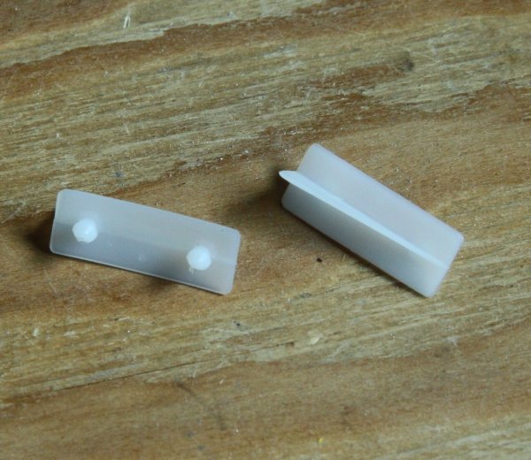

After I get my Savannah S assembled at the field, I will install the little plastic VG pieces. I didn't want to transport the wing with them installed to prevent possible damage.
So the question is, what do I use to install these little plastic VG pieces? Is there a clear glue the you recommend?

I'd just say stick to the recipe (kit manufacturer's recommendation).
It's quick and easy, none of mine have fallen off and I'm not aware of any other builders losing them.

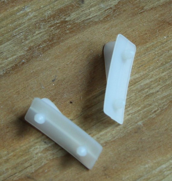

JG supplies precut 3M doublesided tape with his VG kits, which is excellent, but the Savannah wing has locating holes that match twin locating pegs on the VGs provided, and to tape them you would be somehow cutting round the pegs, also standing the VG off the surface.

Having started replacing broken VGs (about 8 so far) on my Savannah after about 8 years I would be wary of using superglue as it implies permanence. Mostly the vertical part has got brittle and snapped, leaving the base.  Getting the old ones off without removing all the underlying paint is the challenge. I have found that careful use of sidecutters and/or Stanley blade works quite well, and if a lug is left in the hole then I just push it through. I then put some clear, neutral-cure silicon on the bottom of the new VG and insert the lugs into the two holes. Ones I have replaced using this method have been fine for a year or more now.

Savannah S vg's have alignment nubs that fit into the pre drilled holes at the leading edge so holding them in place for 10 seconds isn't very difficult

I used double sided tape from Stolspeed. Made a template to cut into the correct size strips and punch the holes for the pins at the correct spacing for the VG’s in the Savannah kit.
Little fiddly to put the pieces on but been on there for 10 years with no problems. Stick well and easy to change if necessary with no damage to the paint.
