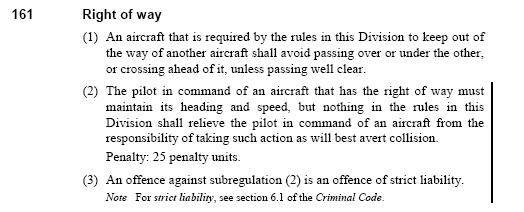

turboplanner Posted April 18, 2009 Share Posted April 18, 2009 People who have been handing off their right of way to other traffic such as RPT might want to take a close look at this. I found the attached CAR 161 while trawling through the Civil Aviation Regulations this morning. It appears that you could be fined around $2500.00 and face criminal charges for doing it. Might pay you to research this thoroughly. Link to comment Share on other sites More sharing options...

Guest pelorus32 Posted April 18, 2009 Share Posted April 18, 2009 Captain, I agree with you. My point was not that the regs are unimportant but that slavish adherence to them won't keep you safe necessarily. Turbo - as for CAR 161 (2), my reading is that it is an almost exact replica of COLREGS Rule 17. It is particularly important to understand the import of the words starting "...but nothing..." that's the bit that will give rise to the penalty. Regards Mike Link to comment Share on other sites More sharing options...

turboplanner Posted April 18, 2009 Share Posted April 18, 2009 Turbo - as for CAR 161 (2), my reading is that it is an almost exact replica of COLREGS Rule 17. It is particularly important to understand the import of the words starting "...but nothing..." that's the bit that will give rise to the penalty. The regulation is that you hold course, but if a collision is imminent you get out of the way which is what you are advocating. I read the penalty as applying to contravention of the regulation - the first part, where contravention can lead to uncertainty and the direct cause of an accident (referred to as the "Dance of Death" in some places). The second part becomes your Defence for moving out of position, but could also draw a charge if it was proved that you knew of the conflict and decided to block the other aircraft. Link to comment Share on other sites More sharing options...
ahlocks Posted April 19, 2009 Share Posted April 19, 2009 People who have been handing off their right of way to other traffic such as RPT might want to take a close look at this..../...It appears that you could be fined around $2500.00 and face criminal charges for doing it. Might pay you to research this thoroughly. Turbz, I really think this is clutching at straws. There are checks and balances throughout the regulation. Applying just one clause as best fit isn't within the intent or purpose of the regulation. I also think Mike sums it up pretty well. "I think what we are talking about (is) Defensive Aviation. Being dead right is not what we are after." =============== For as long as mankind has strived to create an idiot proof system, there has always been corresponding development of the better idiot. Link to comment Share on other sites More sharing options...
turboplanner Posted April 19, 2009 Share Posted April 19, 2009 This Reg was only posted to bring it to the notice of those operating in conditions where it may affect them on a regular basis, particularly because of the severe penalties and potential criminal prosecution. What they do with it is up to them - I didn't do it to spark debate or entertainment. Link to comment Share on other sites More sharing options...

youngmic Posted April 19, 2009 Share Posted April 19, 2009 Turbo, Not wishing to discredit your research, but I think you'll find 161's intent is in regard to separation and overtaking in the normal course of x country navigation. For 20 years as professional pilot I have been reading regulations, they are not always well presented, occasionally contradictory, and often confusing, even to the CASA bods. I feel I have been tested to ad nausea in the numerous exams I have had to sit on air law, and not only CASA but foreign air law as well. But the learning is as much about seeing how and when they are applied in an operational context. It is important to realise that the CASA has to apply these laws in the real world, and whilst they could it is unlikely in your lifetime that you will ever see a RAAus pilot prosecuted for a breach of 161 by giving way to a Regional in the circuit area. The whole foundation of recreational aviation is an avoidance of many of these convoluted laws. The key to it is to just enjoy the simple pleasure of flight. To this extent there are only 2 rules; 1. Don’t hit nothin’ 2. Don’t do nothin’ dumb If you stick to these you’ll be pretty right. But please don’t stop reading up and posting as I’m sure we can all learn from it, and I’m waiting with baited breath on your CASA enquiry and feed back. Link to comment Share on other sites More sharing options...
