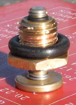

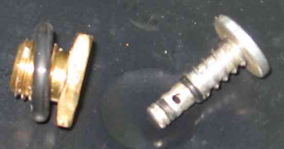

Hi Bob By all means order a new valve, but it is most likely you just need 1 or 2 new small O rings. I needed a new valve because the small steel retaining C ring at the top was missing. Just be careful when dis-assembling that you don't loose any parts. Thinking about it now I know what it looks like and how it operates I think when you pull the plunger down in an effort to make it seal you (me) shear the outer edge of the O ring off. The plunger then drops a little lower with the remaining part of the O ring sealing inside the hole rather than on top as pictured. In this situation the steel C ring probably stops the plunger coming out by seating where the O ring should seat. To make matters worse the loose sheared off bits of O ring probably cause more problems with poor sealing compounding the problem. After writing this I think I might measure the distance the plunger travels ( or hangs out) as a means of condition monitoring the valve as I would expect the valve to protrude further out ( have more travel ) if the top O ring is faulty. If you purchase a new one you could still recondition the old one as a spare. By the way the string seems to be keeping the soft shell away from the valve nicely, and its really nice to have a valve that seals easily again. Ray

Hi Bob My advice - Don't keep doing what you are doing. Mine also was the same and I have been pulling and twisting for some time now after checking the fuel, to stop the dripping. Today while getting ready to fly I refueled and did a fuel drain check then I decided to tie the back of the fabric shroud back to the tiedown loop and rear strut in an effort to keep it clear of the drain valve. While doing this the drain valve was still dripping from the test so I did my usual twist and pull and the plunger came completely out. Of cause Murphy was helping me and I dropped the part in surprise, so there I was little (really old Fella) boy with his finger in the dyke stopping the flow and unable to reach the loose part on the ground. Did the dash and grab and pushed the plunger back in the hole and it mostly stopped the flow without too much loss of fuel. Really pleased it happened then and not in flight as it most certainly would have dumped the fuel without notice and resulted in an engine out - I would much prefer to just practice them with a running engine. Drained the fuel ( an easy job with the faulty valve) and then removed the valve. The top O ring had suffered under my attempts to stop drips in the past and the spring retainer was gone. SO ENDED MY MORNING FLYING LESSON bugger! Lucky Airborne is not to far away so headed off an got a new one, then back and reinstalled in time for a rescheduled afternoon lesson. Airborne's suggestion for stopping a drip is to continually operated the drain valve as it is usually caused by piece of foreign material from the fuel lodging in one of the small holes or under the O ring. Repetitive operation usually dislodges or shears the foriegn body and flushes it free So in summary from my experience I would suggest it's a cheap and easy fix but requires draining the tank.- Just replace the 2 small O rings that are probably now damaged, But do it before you loose the retaining spring an need to buy a new valve either similar or different. Took some pics of the valve if that helps. Checked the thread size but couldn't ID in the limited time I had available ( though I did check it against a few different threads I had at hand) Hope this is of some help Ray
