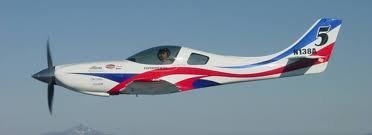

well, this is a Lanceair 320/360, for reference. 76 sq ft of wing.... there were a couple of different wings. -
