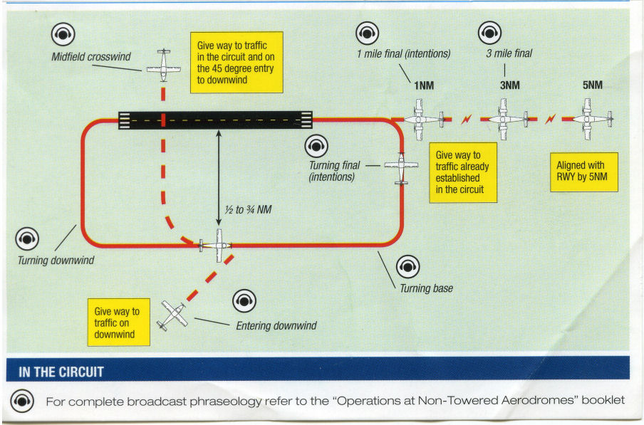

Procedures at non towered Note there are two scans to look at here. [ATTACH]1989[/ATTACH] [ATTACH]1990[/ATTACH] Comments on this small sheet which I thought all pilots would have received. Regards
