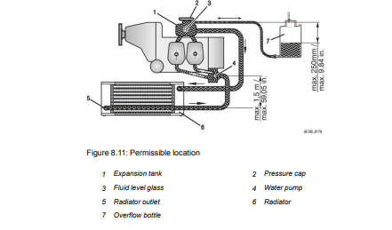

  11. I spent a while in Repco the other day looking for suitable 25mm ID hose for the radiator runs. Couldn't find anything and everything was hellishly expensive anyway given I'd need to buy several to get the right bends in it. Just in terms of the Gemini radiator hose Skippy - was searching online for that but it always seems to be 30 - 34mm, not 25 as we need for the Rotax connections? What other options are there - looking at this (Aeroflow silicone heater hose) - handles up to 180 and it looks like it's got some spiral reinforcement. Can't find any data on bend radii though. Would something like that be suitable for the 25mm sections?

  20. Hi all, in regards to @danny_galaga's original post about radiator hoses... having never installed radiator hoses on anything before (including cars) - is standard procedure to locate one long length with the right shape to extend from the radiator to the expansion bottle / radiator to water pump (very difficult!), or do you do it with a series of bends and straight sections joined with 25mm beaded aluminium joiners? Thanks, Marty
