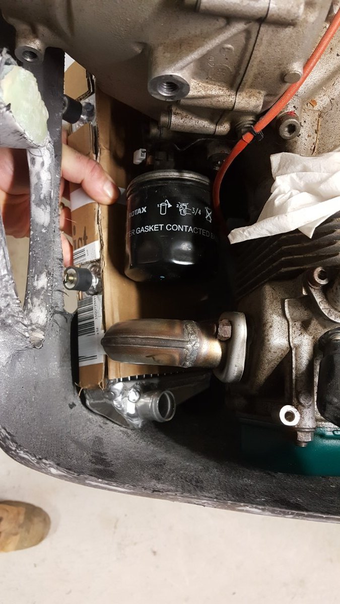

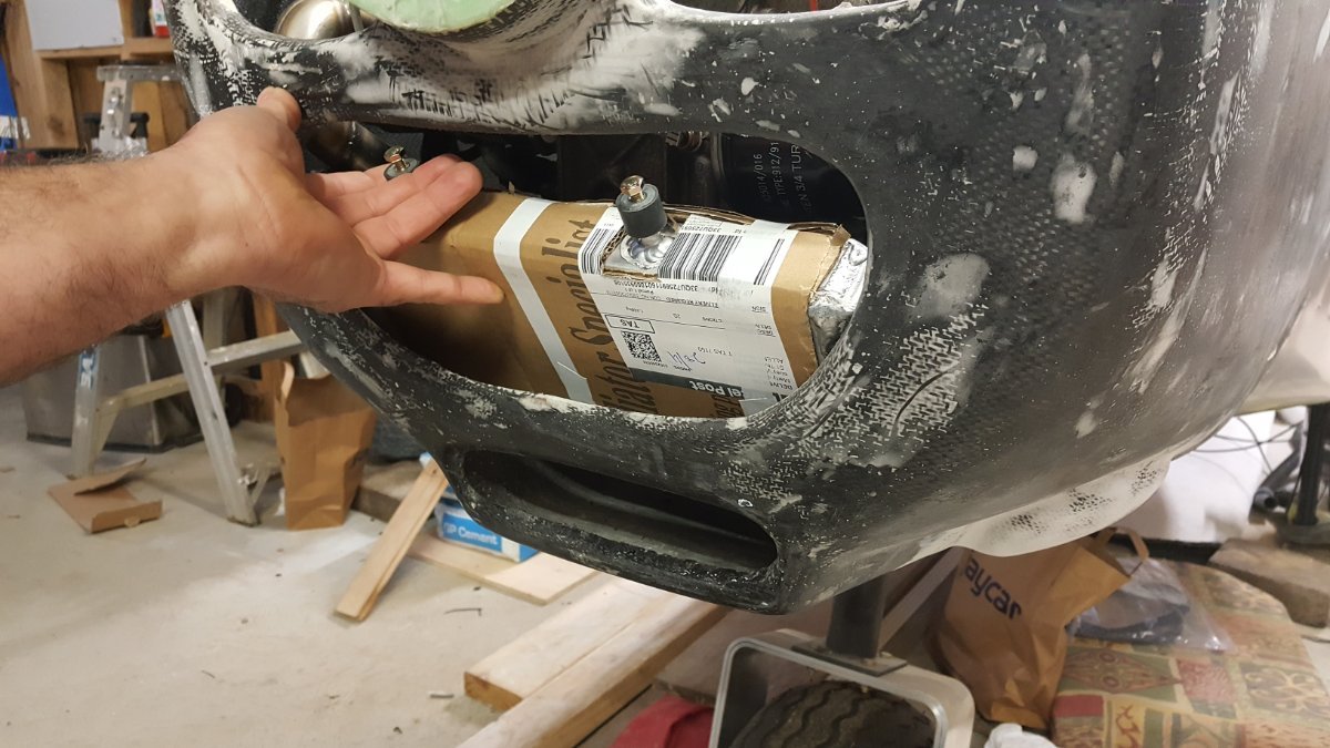

  1. Even in the C172 part of the pre landing checklist was to look out the window and make sure the wheels were there.
  2. It'd be much less work for the cabin crew too. Might be a problem if you need to get everyone off the plane in an emergency though.

  4. If Ryanair are running it, you'll be able to purchase less G for your seat.
  5. I'm building my 701 with a header tank, but will be plumbing the return line to one of the wing tanks. This should avoid that issue and I believe Savannah specify return to the wing tank rather than to header, is that correct Bob?

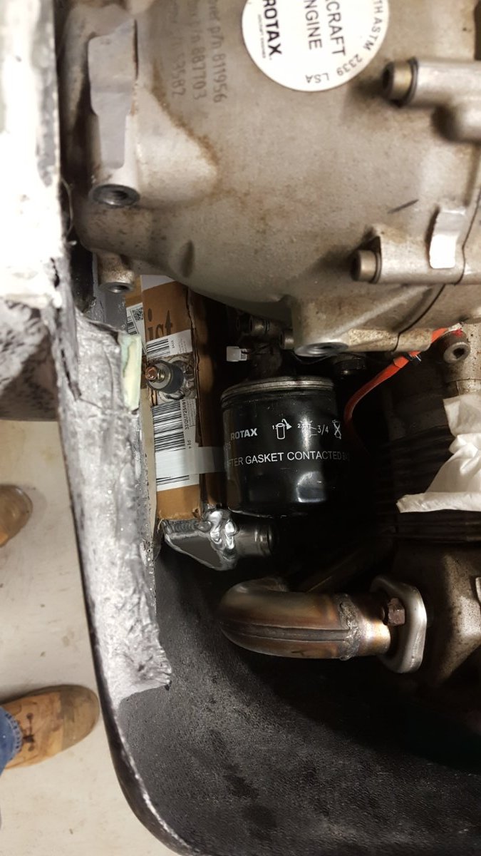

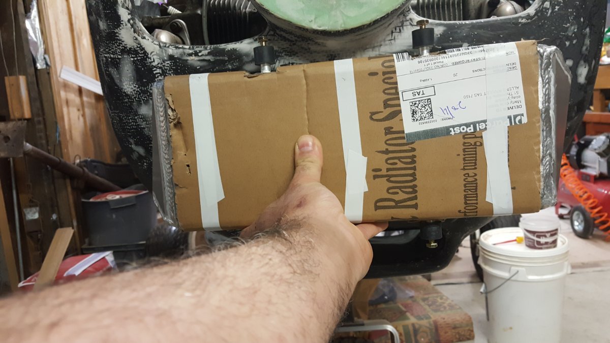

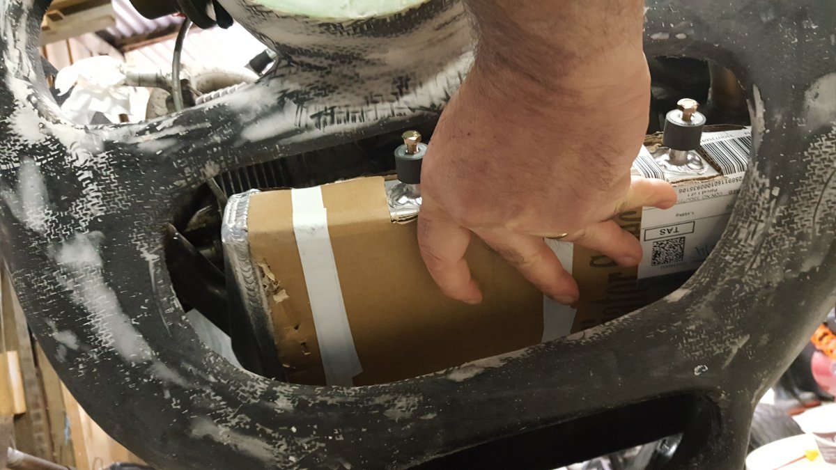

  6. Thanks everyone - think I've got it sorted now. Did some more holding in position, and yes it's best with the oil cooler at the front and the radiator parallel with the front exhaust runs but offset from centre to avoid the exhausts. Pics below show - oil cooler is dark, radiator in aluminium colour. That's not exact position but close. I'll have to jiggle it precisely then I can draw up the mounting brackets required. Luckily there's the M10 holes either side of the gearbox for the oil cooler (which only mounts at the top - no provision at bottom for any attachment), and the front and rear holes at the bottom of the engine for the radiator. The rear holes are used for the engine mount, but if I put an aluminium spacer inside the engine mount recess then a longer bolt can also attach the radiator bracket on the outside.
  7. That's not a bad idea Bob - move it back a bit under the exhausts and put the oil cooler up front. Thanks!
  8. Well I would, OK, but imagine the weight of the extra water and hose...

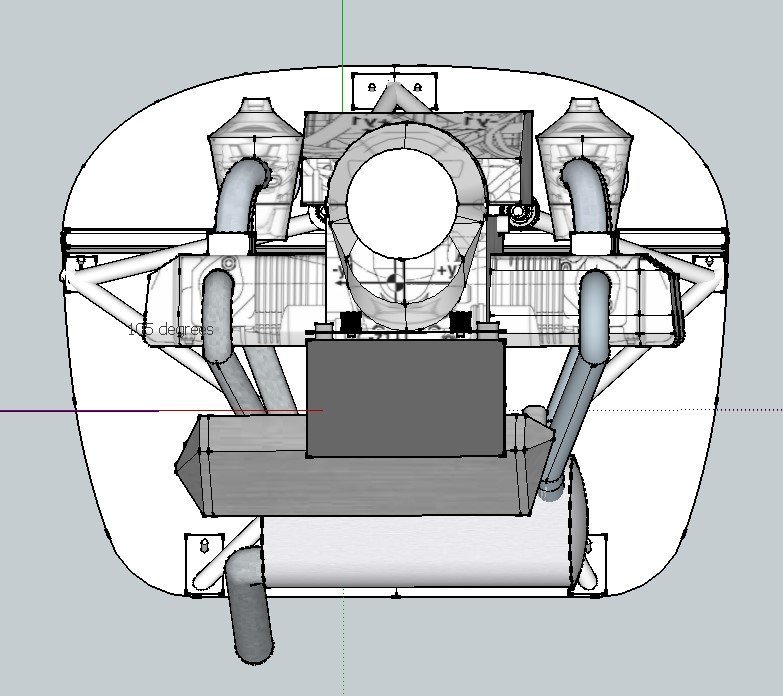

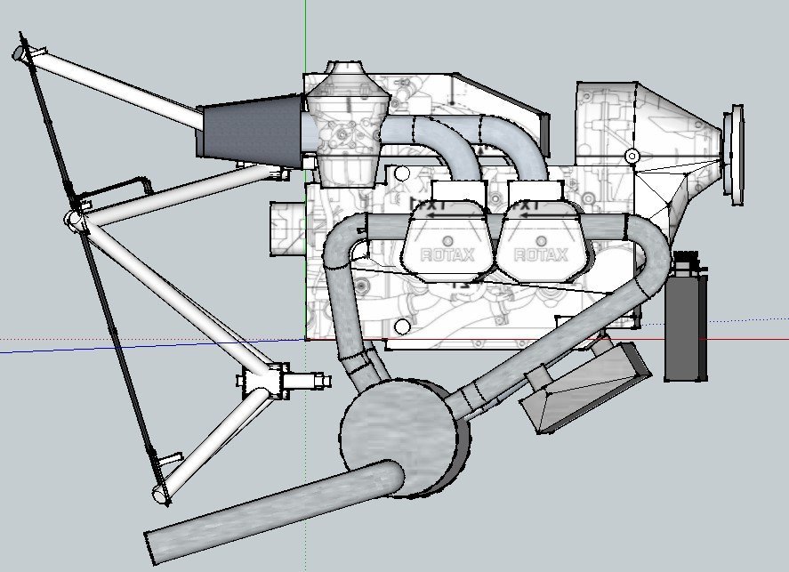

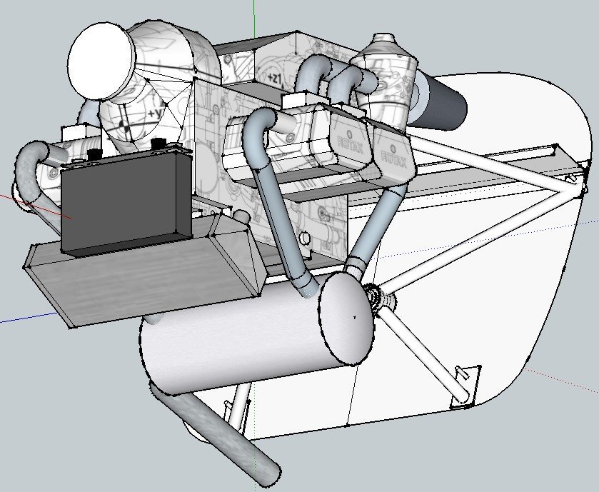

  9. Hey folks, Looking for some advice on the placement of my radiator. It seems like the cowl I've made possibly could have used a bit more room at the front end. The cowl slopes backwards which I guess may be more aerodynamic but doesn't leave much room in front of the engine and especially the exhaust pipes from the front 2 cylinders. It looks like I have 3 choices: 1. Mount the radiator at an angle to the starboard side of centre so the port outlet (upper) is between the oil filter and the exhaust tubing: 2. Mount the radiator at an angle to the port side of centre so the port outlet is outboard of the exhaust tubing: 3. Redesign the entire front of the cowling so it's squarer, protrudes out at the front more to allow the radiator to sit more vertically. I really don't want to do option 3 because (a) I'm sick of fibreglassing and (b) I'm out of carbon fibre, but that depends on clearances, tolerances and allowable angles for radiators. Is there any advice on how far hoses should be from exhaust outlets, how far radiator tanks should be from the cowling, and what angles radiators can be mounted at? Thank you! Cheers, Marty
