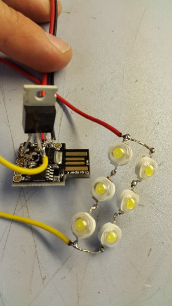

Yes, will see. Do you have a possibility to check if the LED modules have an intern PWM circut? This might jam the radio. Any idea how to get a mould to do the clear resin bath?

worked a little on my Strobe project... results are very prommissing... the LED modules 12V 10W work o.k., but are not the best choice... they must have already drivers or other unwanted electronic in them... Much better are the seperate 3W Power LEDs.... 3 of them in line on 12V give a blindingly bright burst... I used 6 of them in my little test run shopping list: - 3Pcs Digispark Kickstarter Micro USB Development Board For ATTINY85 Arduino 1047663 €6.30 - 10pcs 3W LED Lamp Bulb Chips 200-230Lm White/Warm White Beads 960389 €2.15 - 5Pcs IRFZ44N Transistor N-Channel International Rectifier Power Mosfet 953278 €1.89 (the prices are together and not per peece) here are the videos: http://savannah-blog.de/uploads/20170523_214025.mp4 http://savannah-blog.de/uploads/20170523_214518.mp4

Lookes nice, but would they not decrease the viewing angle. I would rather use a sixpack of LEDs pointing in different directions, covering a wide angle. And of corse there needs to be the green or red countinous LED pointing forward. Hope I will get the rest soon to try. Thanks for the link. I will see if I can find some in germany.
