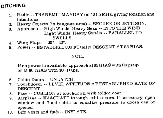

I wouldn't turn steeply at low level either. I've been taught to limit your bank angles to no more than 30 degrees left/right arc, place the aircraft into wind direction if able and try to maintian 80kts. I know other guys are taught to limit the air speed to 60 Kts so not sure why the difference.
That's interesting, I assume this is in the 172?
This is from my C172 POH
To put it simply: Different aircraft have different speeds for best glide.
I believe he's talking about the same type aircraft, though I could be wrong.
"Best" glide depends what you want though. The normally quoted "best" glide is for distance, not for min descent rate. If distance is not an issue and you want minimum descent, a slower speed than best glide will provide this.
I can see that there are situations where you may want to minimise the decent rate, but certainly for the last 100' feet or so I'd want a bit of speed in hand to manage the flare - it was quite noticeable when I landed deadstick that the lack of residual thrust robbed the elevator of some effectiveness and the aircraft sat down a bit sooner than I would otherwise have expected.
