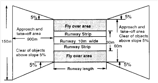

68volksy Posted December 7, 2011 Share Posted December 7, 2011 Pretty sure the ATSB won't be quoting anything said on this forum. If anything's raised they may not have thought of it might get some thought but i'm pretty sure everything on here's pretty standard stuff so far. The report quotes the ferris wheel as 60 feet high - i'd like to know if it was on ground level with the strip also though. Also - anyone out there actually know what an "appropriate" splay for this type of runway is? My quick read of the Manual of Standards for Runway code 1 Aerodromes talks of a take-off "zone" which starts 30 metres after the end of the runway and extends for a total of 1600 metres at a 5% slope. Who can do the math to determine how high that "zone" is at a point 160m after the end of the runway? For the sideways limits it talks of a length of 60 metres (starting 30 metres out) at a 10% divergence - now I can see why the old maths teacher kept telling me trigonometry would be important some day... Link to comment Share on other sites More sharing options...

rankamateur Posted December 7, 2011 Share Posted December 7, 2011 Pretty sure the ATSB won't be quoting anything said on this forum. If anything's raised they may not have thought of it might get some thought but i'm pretty sure everything on here's pretty standard stuff so far.The report quotes the ferris wheel as 60 feet high - i'd like to know if it was on ground level with the strip also though. Also - anyone out there actually know what an "appropriate" splay for this type of runway is? My quick read of the Manual of Standards for Runway code 1 Aerodromes talks of a take-off "zone" which starts 30 metres after the end of the runway and extends for a total of 1600 metres at a 5% slope. Who can do the math to determine how high that "zone" is at a point 160m after the end of the runway? For the sideways limits it talks of a length of 60 metres (starting 30 metres out) at a 10% divergence - now I can see why the old maths teacher kept telling me trigonometry would be important some day... Edit - My post contributed nothing useful to the discussion. Link to comment Share on other sites More sharing options...

Guest davidh10 Posted December 7, 2011 Share Posted December 7, 2011 Also - anyone out there actually know what an "appropriate" splay for this type of runway is? My quick read of the Manual of Standards for Runway code 1 Aerodromes talks of a take-off "zone" which starts 30 metres after the end of the runway and extends for a total of 1600 metres at a 5% slope. Who can do the math to determine how high that "zone" is at a point 160m after the end of the runway? For the sideways limits it talks of a length of 60 metres (starting 30 metres out) at a 10% divergence - now I can see why the old maths teacher kept telling me trigonometry would be important some day... You don't need trig. 5% is a 1 in 20 slope. 160/20 = 8 metres. Link to comment Share on other sites More sharing options...

David Isaac Posted December 7, 2011 Share Posted December 7, 2011 Alan, I think constructive discussion is good value given that there are some very unusual factors that impacted on the pilots actions that day and I think my position of sympathy for Paul is understood. There are some very valuable points on this accident, none any less significant than the ALA issues. So in relation to the ALA and putting any piloting errors aside, please allow me to put up some interesting information. Below is the image from the CASA ALA publication for single engined centre thrustline aircraft not exceeding 2000Kgs. This would be about the limit for Old Bar and the dimensions appropriate for Old Bar. Note the runway and runway strip dimensions and the 5% (1:20) splay requirements. The ATSB report stated that the Ferris wheel was 34 metres East of the runway centre line and 161 metres from the threshold and that the gross height of the Ferris Wheel was 20 metres AGL. I know that the elevation at the base of the Ferris wheel was approximately 1 to 2 metres conservatively below the elevation of the runway, so lets say the Ferris wheel was 18 metres above the runway elevation. Now the consideration is this : Is a 18 metre high obstacle 34 metres from the centre line and 161 metres out from the threshold within the splay? Someone do the maths and advise us please. I believe it is in the splay, therefore an obstruction and therefore a very foolish place to place it. EDIT: I have redone the calcs; at 5% (1 in 20); in a distance of 161 metres from the threshold the physical splay is 8.05 metres, add the 8.05 metres to the edge of the flyover area which is 30 metres from the centre line and you have 38 metres ... so the Ferris Wheel IS in the splay and worse, it protrudes approximately 10 metres into the vertical clearance requirement of the slope on the splay which is required to be clear of objects above a 5% slope. Why was this little gem of information missing from the ATSB preliminary report??? So maybe the Festival organisers have a case to answer after all. Link to comment Share on other sites More sharing options...
David Isaac Posted December 7, 2011 Share Posted December 7, 2011 Hmm image did not display? How do I make it display guys? OK I inserted it as a word document and seems to have worked (I have updated the post to show the image - Ian) Clever man ... thanks mate Link to comment Share on other sites More sharing options...

David Isaac Posted December 7, 2011 Share Posted December 7, 2011 Guys, I have edited my post at #421. Check it out ... it is not good, check my calcs and tell me if I am wrong please. Link to comment Share on other sites More sharing options...
turboplanner Posted December 7, 2011 Share Posted December 7, 2011 Guys, I have edited my post at #421. Check it out ... it is not good, check my calcs and tell me if I am wrong please. Depending how many if any want to sue, the usual procedure is the shotgun approach, everyone who played a part on that fateful day will be a defendant. Someone or some people had a duty of care not to place the ferris wheel in the splay. If it wasn't there it could not have been hit that day regardless of whether the Sierra was doing cartwheels at the time. HOWEVER, there's that tantalising mention several times of cone markers being on the field........where?........what for?.........if it was for a displaced threshold the ferris wheel gets off. Link to comment Share on other sites More sharing options...
David Isaac Posted December 7, 2011 Share Posted December 7, 2011 ......HOWEVER, there's that tantalising mention several times of cone markers being on the field........where?........what for?.........if it was for a displaced threshold the ferris wheel gets off. Indeed, and if it was displaced, that information would have been available when asking permission to land ... but we speculate again. No one has said the threshold was displaced and the ATSB report referenced the Ferris Wheel position relative the threshold and did not mention it was displaced. Then again the ATSB report said nothing of an obstruction ... could they have missed that major point??? Link to comment Share on other sites More sharing options...
