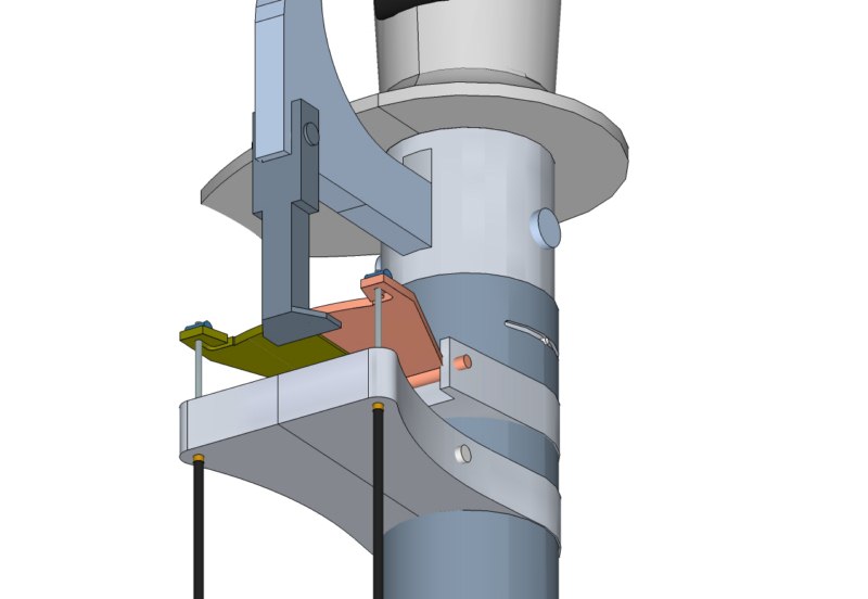

This is the image I referred to earlier. Twist the lever to select left or right brake. Centralized for equal braking. This is an either or system, not proportional. To change direction, the lever must be released first.
449843994_Brakeleverassemblyunderside800x600.jpg.57e551765c2bca9ad33d266e4b0fad68.jpg

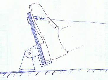

But other than that it seems that two levers are the easiest way to get progressive differential braking, I can see hassles coming from a setup that requires you to release the brake on one side to use the one on the other but maybe you could slope those bottom pull plates in your drawing so that it did provide progressive braking side to side without release with the only problem being when you wished to brake both wheels you would have to squeeze a bit harder.
I tried to draw what I meant by angling those plates not sure how clear it is :-) but setting it up like that would allow you to swap sides without releasing the lever maybe reducing the possibility of operator error.
