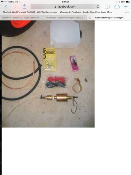

Tim, can you give us a description of your system....are you just pumping it into the exhaust outlet pipe, like they do on ag planes ?..

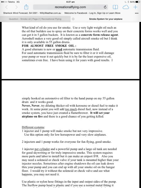

Seriously , the recommended fluids in no particular order are.
From aerobatic pilots (4 st eng) =
Manufactured smoke oil( mineral oil + parifon oil)
Same as above but home made
Diesel + kerosene mix
Transmission fluid
Transmission + diesel mix
Diesel
Pesticide( summer oil)
From ultralight and micro light pilots (2st eng)
As above but home made
Concrete form oil
Transmission fluid
Feel free to add what I missed
What I have tested
Pesticide ( summer oil) thumbs down expensive- burn very quick -$25 3 Ltrs burn 1 min
Super dry aviation smoke oil. Better , but very expensive , burned slower-$55 -3 Ltrs burm 3 min
Trany flyid. Cheapest ( free)same smoke thickness as " super dry" burns slowest - $0 (have plenty in stock for the ford trans and commy power steer lol). 3 Ltrs burn over 5 mins
Smoke is alway released above 1000 ft after a wing waggle followed by a medium 360 deg turn to form( attempt) a circle. Then wing waggle and fly out. And never descend during or after .. As per aerobatic champion advice.
And also found that most say to use the smoke system on final to be seen? I find this odd? Imagine seeing a plane on final , engine revs drop and smoke pours from engine!037_yikes.gif.f44636559f7f2c4c52637b7ff2322907.gif
Also in direct communication with. Dick Starks( K.C Dawn patrol) Nieuport 11 builders and flying display. Dick recommends concrete form oil but proving difficult to find.
