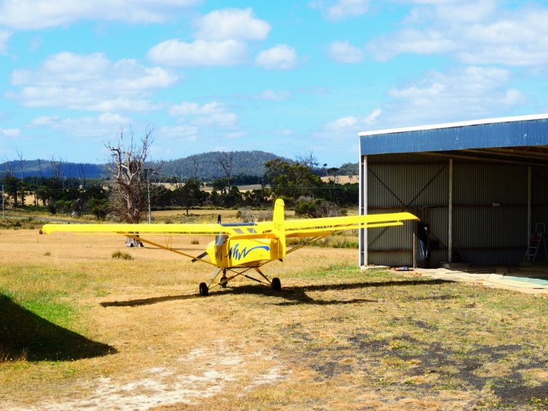

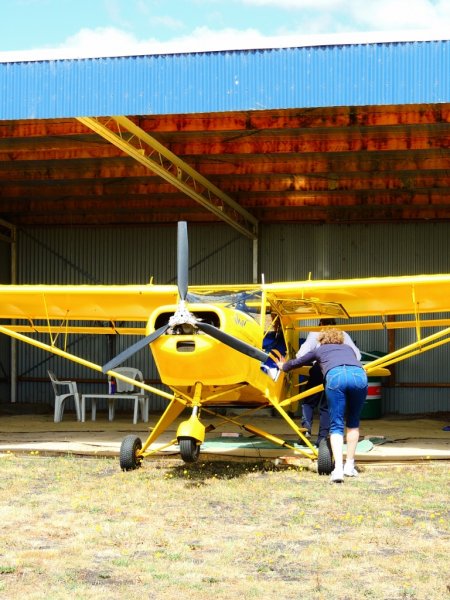

Guest debra stewart Posted December 30, 2015 Share Posted December 30, 2015 [ATTACH=full]40421[/ATTACH] [ATTACH=full]40422[/ATTACH] [ATTACH]40421[/ATTACH] [ATTACH=full]40422[/ATTACH] For those of you still interested in my "hangar Problem" In the photos you can see that I have to come down and park next to the hangar as I have another hangar on my left wingtip. We then push it around so that we can get it into the hangar in reverse otherwise I cant ge tit out again. This is my first time trying to get a photo on here so excise and mishaps, Sorry I put one on twice, didn't mean to, Debb Link to comment Share on other sites More sharing options...

Geoff13 Posted December 30, 2015 Share Posted December 30, 2015 Debbie Is that a step up onto the concrete floor of the hangar or is it a fairly smooth run. It also appears to be slightly uphill. Is that correct. It looks as though this could be more of a technique problem than a strength one. It doesn't look insurmountable though. 1 Link to comment Share on other sites More sharing options...
Robbo Posted December 30, 2015 Share Posted December 30, 2015 Geoff, agree, I reckon half the problem is that final entry into the hanger as it would need one big push or even little pushes leading into a big burst. Link to comment Share on other sites More sharing options...
Jabiru7252 Posted December 30, 2015 Share Posted December 30, 2015 Use a winch or pulley to pull the plane into the hangar? Link to comment Share on other sites More sharing options...
Guest debra stewart Posted December 30, 2015 Share Posted December 30, 2015 not as bad as I was expecting.Don't think im saying it is easy and having a go at you, im not and am just saying its not as bad as i thought. It certainly can be. That black stuff on the ground is like quicksand ( under the frass and quite deep) and the plane sinks into it - it is uphill and I always keep my plane full of fuel so all- together it makes it very hard. I have had men go, "oh that's nothing" and tried to do it, yet not one person has been able to get it in backwards yet ! The two of us can barely do it and we are used to it doing it every week. Anyway, I'll find a solution but hopefully she will move me first ! Link to comment Share on other sites More sharing options...
turboplanner Posted December 30, 2015 Share Posted December 30, 2015 Dyna bolt a cheap boat winch to the concrete floor at a reasonable height to allow you to turn it standing up. Just need to get someone with structural knowledge to design a triangular tube mounting so it doesn't pull out of the floor. Cost maybe $150 - $200 Link to comment Share on other sites More sharing options...
Oscar Posted December 30, 2015 Share Posted December 30, 2015 Hi Deb. For what this may be worth. I designed a pulley system so I can load and unload my Jab. fuselage, (wings off) onto a trailer single-handed, which involves pulling the mains up fairly steep ramps. In my case, I had a spare Catamaran mainsheet system ( basically, a six-pulley block and tackle), but the boat winch would do it well. A few points occur to me, from looking at your photos. It appears you have a definite ledge to get over between the grass and the concrete. Some ramps would make life a lot easier - e.g. some strips of chequer-plate, with a bit of angle welded onto the underside at the top (floor) ends say 50mm or so back from the edge of the sheets so they can't get dragged back. A slight bend in the plate where it sits on the concrete would be good, so it is nice and flat for the whole roll. A simple y-bridle made up of ratchet-strap material that you can clip around the main legs with a single central point for the pull line will ensure that the pull is straight back, but two things you need to consider: firstly, they need to be secured to each leg in such a way as to prevent them riding up the leg: you need to have the pull absolutely as low above the axle as possible so they don't pull the tail down. The second thing - and this is MOST important: the strap connections need to be absolutely fail-proof; if one lets go under load, the aircraft will spin around and most likely hit SOMETHING. A dyna-bolt or Ramset in the concrete on the centre-line of the pull, at the back of the hangar, would provide a location for attaching the winch / pulley system. If it's a hand-turned boat winch, then as Turbs has said, it'll need a platform. 1 Link to comment Share on other sites More sharing options...
Blueadventures Posted December 31, 2015 Share Posted December 31, 2015 [ATTACH=full]40421[/ATTACH] [ATTACH=full]40422[/ATTACH] [ATTACH]40421[/ATTACH] [ATTACH=full]40422[/ATTACH] Hi Deb Could you place some crusher dust fill at the area where you pull up and level to the hangar entrance so that it is a level area to turn around and push the gazelle backwards into the hangar. Just a thought. Cheers Mike Link to comment Share on other sites More sharing options...

Guest debra stewart Posted January 3, 2016 Share Posted January 3, 2016 Hi DebCould you place some crusher dust fill at the area where you pull up and level to the hangar entrance so that it is a level area to turn around and push the gazelle backwards into the hangar. Just a thought. Cheers Mike I know everyone is trying to help but it is just one of those "problems". Yes, I've tried filling in some of the area but didn't work. My instructor and I really battle getting it back in and that's two of us. I have asked quite a few men to give it a try and not one has succeeded yet so I will never be able to do it. I just don't have the strength and yet I can pull it out easy as anything. Its the reversing and turning and going a bit uphill that makes it a three pronged problem. Never mind. I'll get there or get moved hopefully, that's what I'd like. I am in the worst hangar in the place ! Typical. Never mind, onward and upward, Debb Link to comment Share on other sites More sharing options...
