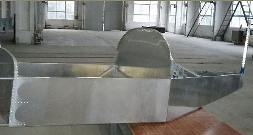

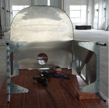

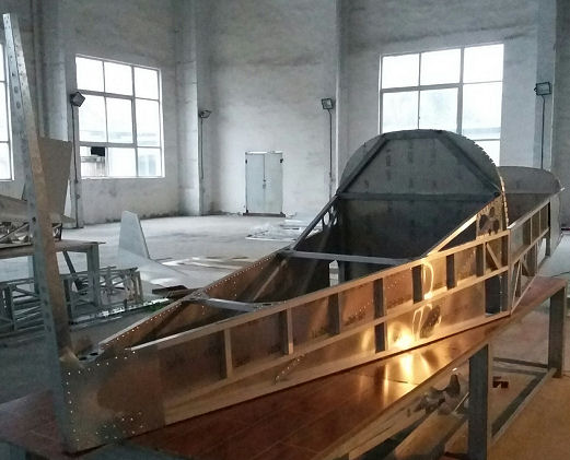

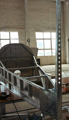

geoffreywh Posted January 5, 2017 Share Posted January 5, 2017 so how will you join the front and rear fuselage sections nicely without a " carry through" ? The rear section looks terrific!...............And, four point harness mounting points please. Lap/sash doesn't cut it..... Link to comment Share on other sites More sharing options...

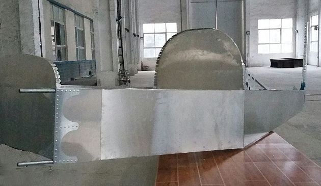

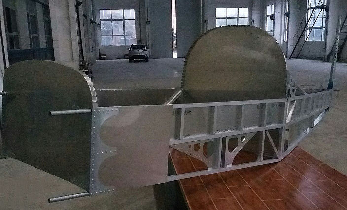

kgwilson Posted January 5, 2017 Share Posted January 5, 2017 What is the point of the inner skin? Surely this just adds weight and complexity as the outer skin will provide rigidity assuming it as aluminium. Link to comment Share on other sites More sharing options...
bexrbetter Posted January 6, 2017 Author Share Posted January 6, 2017 What is the point of the inner skin? Surely this just adds weight and complexity as the outer skin will provide rigidity assuming it as aluminium. The completed structure, with inner and outer skin applied, forms in essence a RHS tube. The outer and inner skins are shear webs. No need for diagonal bracing. Not even the need for as many verticals (to stop buckling) but I didn't want any oil canning or waving. "Complex"? - it most certainly is not, can't you see how simple it is? I just put it together myself, and I know first hand it's easy and fast. It's also cheaper and easier to supply, it's cheaper and easier to ship, it's cheaper, easier and faster to build. Not heavy. ... and don't call me Shirley. 2 1 2 Link to comment Share on other sites More sharing options...
bexrbetter Posted January 6, 2017 Author Share Posted January 6, 2017 so how will you join the front and rear fuselage sections nicely without a " carry through" ? . You can see the inner joining plate in the pictures above forward of the rear bulkhead, the grey multi-hole vertical. There will be a substantial outer joining plate, as well as an overhead tube from the top of the roll bar to the front half. ..And, four point harness mounting points please. Lap/sash doesn't cut it..... The crossover bar on the roll bar provides the mounting point for a harness. 1 1 Link to comment Share on other sites More sharing options...

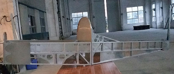

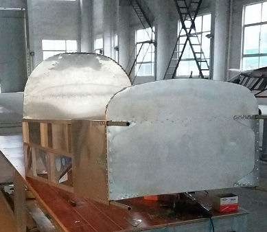

bexrbetter Posted January 7, 2017 Author Share Posted January 7, 2017 Soooo, Went in this afternoon and put the tail post on, adding some bracing inside the rear half, and stuck the front halves and firewall on ... 6 Link to comment Share on other sites More sharing options...
Pilot Pete Posted January 7, 2017 Share Posted January 7, 2017 And just like that there's an airplane 1 Link to comment Share on other sites More sharing options...
Head in the clouds Posted January 7, 2017 Share Posted January 7, 2017 Now you're onto something. I particularly like the strength in the cabin sides - they shouldn't fold up and crush the occupants like the early unmodified RV6s seemed to. Just one small thing - the lightening holes in the rudder-post don't reduce the weight very much at all but they do allow mud wasps to build their heavy nests inside, which also have the potential to interfere with controls when they rattle loose. Similar with the HS spar when you get to that. Link to comment Share on other sites More sharing options...

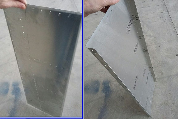

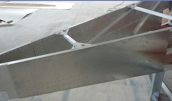

bexrbetter Posted January 9, 2017 Author Share Posted January 9, 2017 So this morning I had the side panels lasered and folded. Bit hard to see but all the pilot holes are there so you just pop the drill through without measuring or mucking around. The panels fit snugly so you just simply line them up, push them on, then drill away. All these panels are sitting their on their own. All the measuring, scribing and pin punching work has been completely eliminated, and of course the laser is deadly accurate and makes left and right sides alignment near perfect. 4 1 Link to comment Share on other sites More sharing options...
bexrbetter Posted January 9, 2017 Author Share Posted January 9, 2017 This is as easy as it gets, pop it in place, start drilling. 4 Link to comment Share on other sites More sharing options...

bexrbetter Posted January 10, 2017 Author Share Posted January 10, 2017 What is the point of the inner skin? Surely this just adds weight Weighed it today, 2 kgs over a Morgan frame but actually I have a large steel 'floor to roof' rollbar. .. and don't call you Ashley. 1 Link to comment Share on other sites More sharing options...
