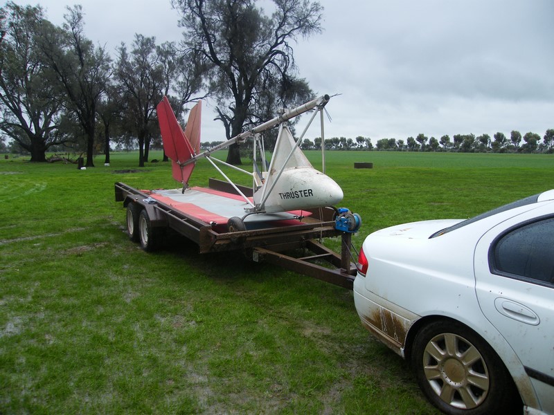

Deskpilot Posted June 7, 2016 Share Posted June 7, 2016 Early Friday morning, I set out from my home south of Adelaide and headed from Lockington, mid Victoria. Behind my car was a REALLY heavy duty trailer that was to carry my gifted Thruster home. As the gods would have it, it pissed with rain the whole way, so much so that I missed a turning and added 45 minutes to my journey time. This was due to a narrow road and no side turnings for miles. Saturday dawned wet with over night rain but the skies were fairly clear. My benefactor Steve, and I set out the Kotta air field, a farmers strip along side his crop. The airfield was under water so no flying was possible. A big disappointment for Steve as he wanted to show off his newly built Ninja. Nice job Steve. Behind the larger hangar sat a home built enclosed trailer in which the Thruster has been stored for 10 years. I'll skip the bit about Steve getting his ute bogged down trying to pull the trailer round to the front of the hangar but eventually we got the Thruster out of one trailer and onto another and all ancillary parts loaded into my car. The wing skins are shot so we removed the ribs before storing them under the fuselage. The following day started out with ground clouds(very wet fog) and I set out for home. As it is my way, I got lost again but the detour wasn't quite as large as on my outward journey. I got home safely but dead tired. Unloaded everything and tucked up my prize in her new 'hangar'. Into which she JUST fits. Today, I pulled her out for a better inspection, and, although Steve had told me she is a T100, she's on the register as a T84. I understand that a T100 is a modified T84, something to do with the empennage. Anyone care to clear that up? Of course, with the plane outside, I had to find out if I'd fit in it. I found the seat is a bit narrow but there's plenty of leg room. Now I wonder it the refurbished bird will actually lift me. 100 kilos but look more. This will be a long term project for me although, it's in a much better condition than I expected. 8 2 Link to comment Share on other sites More sharing options...

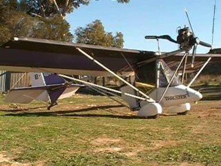

flyerme Posted June 13, 2016 Share Posted June 13, 2016 Great score Doug. I need to check it out :). Yeh looks like an 84 , t83 has no lower battens mate,And ran my fav eng the robin ec44.. I did a rebuild and put 60 hours in my T83. I REALLY WANT IT BACK !!! new owner never regoed and did 1 lesson and called it quits... It's sitting in a shed somewhere in Vic. Past 4 years... :( My ol girl in 2012 Day before sale :( Link to comment Share on other sites More sharing options...

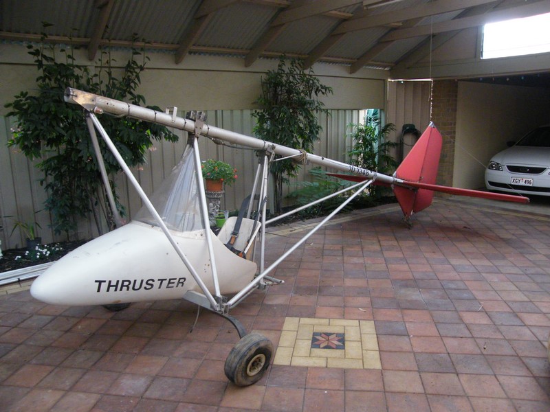

Deskpilot Posted June 28, 2016 Author Share Posted June 28, 2016 OK, a quick update. Although registered as a T84, she has all the properties if a T83. 80mm boom, tail lower struts finish short of tail plane assemblies and has no lower rib in the wings. Not that I'm bothered what she is as long as I can re-register her at a later date. Currently she looks like this: Now, another query, one of the 2 tanks I have, and the one I will probably use, appears to have a different spacing to the plane...?: In case this offers some info as far as identity is concerned, this is the pod profile: What I have found so far is that there is more wrong than I first imagined. Rusty through bolts in the wing attachment assemblies, degraded nylon spacers(very brittle), rusty rivets (thought they were all alloy) all bungies are hard and useless. Tail-wheel bearing absolutely shot/rusted out. Will be replacing this with a larger wheel. Still sticking to my 'do a little every day' routine. There's certainly no rush to overlook things that need to be fixed or modified. CYA Link to comment Share on other sites More sharing options...
kasper Posted June 28, 2016 Share Posted June 28, 2016 Your molded tank is for the T85 airframe ... it has wider spaced fore/aft tubes and has the raised tank to allow clearance on the tail support tubes coming up from the rear cross tube ... your airframe looks like a T83 with the narrow spaced tubes and of course with the tail boom support tubes coming off the front cross member no need for the raised tank. Its 95.10 regn so you can modify it to your hearts content to fit the molded tank on or just use 20-40L fuel tank on the existing rails with a flop tube through a modified cap ... up to you Link to comment Share on other sites More sharing options...
