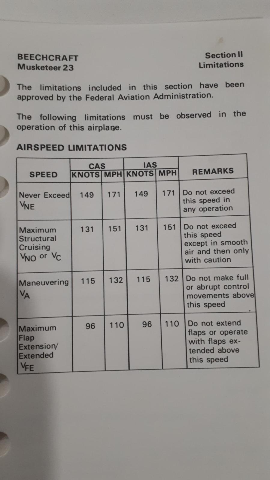

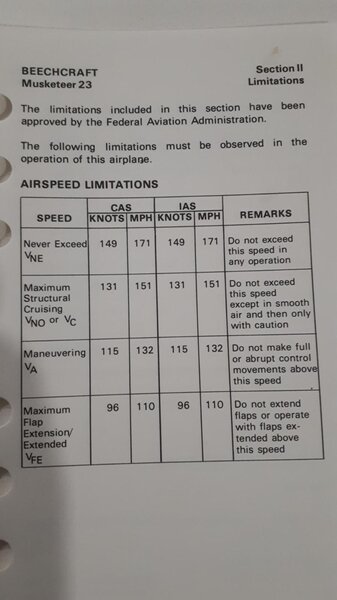

Thruster88 Posted August 28, 2020 Share Posted August 28, 2020 There are quite a few previous threads here about the importance of Va. I've just had a look at the Atec site and it has a Vra for the Z2000 (V rough air) of 107 knts which is considerably quicker than the listed Va of 80 knots. Perhaps someone more familiar with design engineering could explain the difference? Turbulent air penetration speed and max maneuvering speeds are different. Link to comment Share on other sites More sharing options...
M61A1 Posted August 28, 2020 Share Posted August 28, 2020 Turbulent air penetration speed and max maneuvering speeds are different.[ATTACH type=full" alt="Resized_20200828_180728_3863.jpg]55864[/ATTACH] Yes...but How is Vra defined and calculated? Link to comment Share on other sites More sharing options...
Thruster88 Posted August 28, 2020 Share Posted August 28, 2020 Yes...but How is Vra defined and calculated? I have not heard of that one and a google search produced nothing. We all ready have enough V speeds without manufacturers inventing more. Smarter people than me work out Vno. If Va was also marked on the ASI it may have saved a few in flight failures on aircraft like the c210. Link to comment Share on other sites More sharing options...
