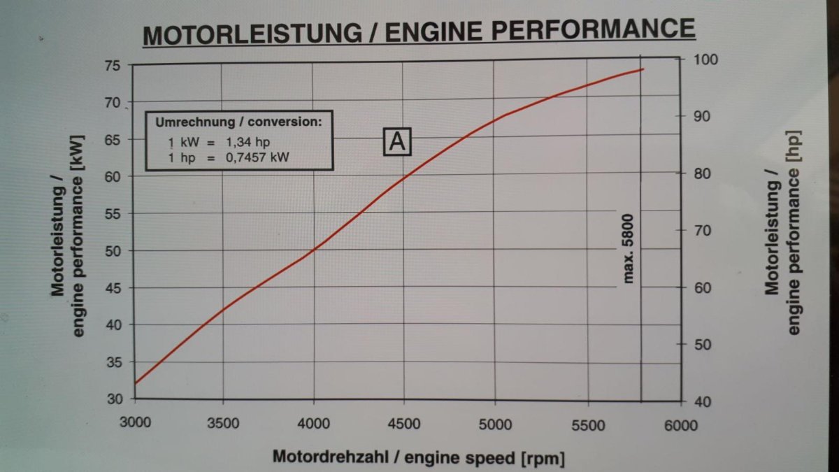

Thruster88 Posted October 15, 2020 Share Posted October 15, 2020 22 minutes ago, skippydiesel said: This attached article on CS prop use on Foxbat is, in my mind, a very balanced article: https://foxbatpilot.com/tag/constant-speed-propeller/ As per the fox bat article and looking at the 912uls performance curve you will "pick up a bit", maybe 4kw for takeoff and almost nothing for high cruise with a constant speed. If you really need that extra 6 horsepower to operate at a strip it is still going to be marginal. Link to comment Share on other sites More sharing options...
facthunter Posted October 15, 2020 Share Posted October 15, 2020 Yes the article is quite reasonable. It concentrates on getting the max horsepower from the engine by the prop making the engines revs available. (like lower gears in a gearbox). One point should be made in all of this is even a CS prop blade is a compromise as it's blades twist cannot suit a wide range of RPMS efficiently, wheras a properly "tailored" fixed pitch for a particular speed. CAN IF this is done for your cruise speed it will out perform any CS at that speed as well as being lighter and cheaper and more reliable.. Nev 1 Link to comment Share on other sites More sharing options...
