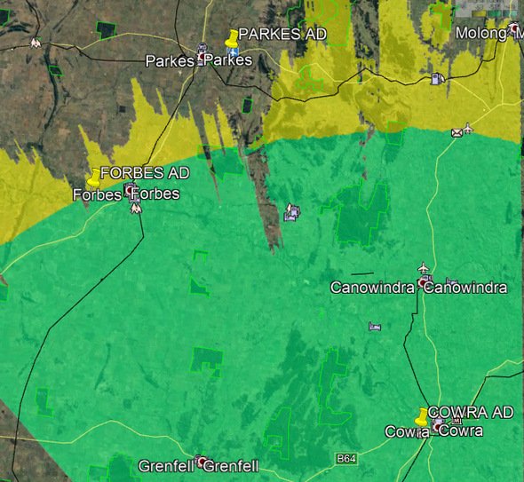

Recently I have been running some numbers to see where the nearby SSRs to the central west, what height they'll be able to see us.  This is for Mode A, Mode C transponders.
Mt Bobbara (Young)
3000'

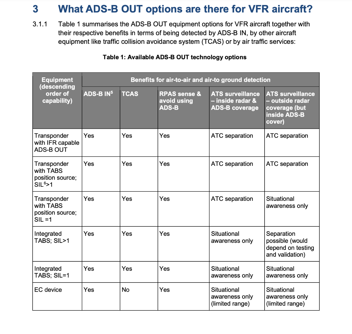

According to CASA's   ADVISORY CIRCULAR AC 91-23v1.0  it is the case in Australia that SkyEcho type devices are/will be visible to ATC, within range.
"6.3 Integrated TABS device 6.3.1 Aircraft operated to the VFR can use an integrated TABS device. TABS devices were designed primarily for those aircraft in USA that were not required to comply with the FAA's stringent ADS-B requirements but want to be ‘seen’ by ADS-B and TCAS. In Australia, it is expected that these devices will provide a level of visibility to ATC as well, for situational awareness purposes"

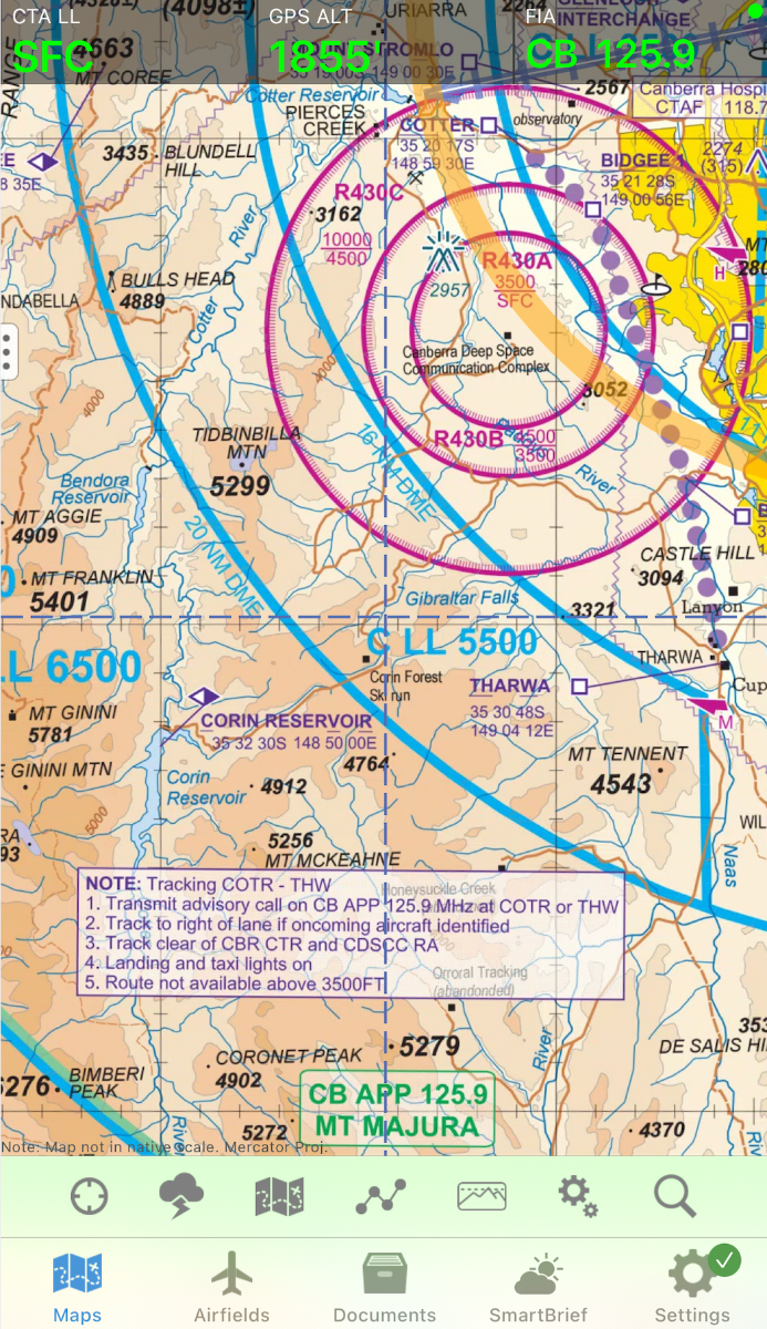

But at least ATC should be able to identify you in times of trouble.  I wonder if they'll get around to accepting these devices for the purposes of flight following. I guess they'd want to see how they work in practice first.

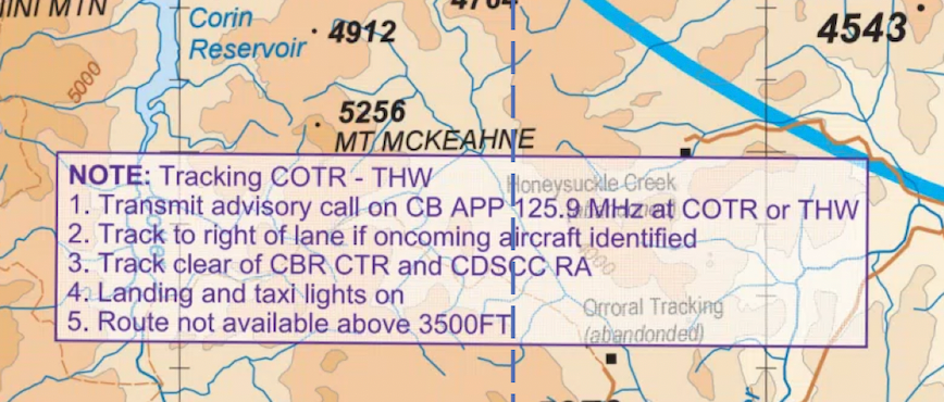

Also there are times when you need/want to advise ATC of your position/intentions when skirting OCTA, so it would be nice to know that you are conspicuous to them.
This VFR route south west of Canberra between Cotter and Tharwa is an example of being required to advise even OCTA.

CASA, details that restriction in ADVISORY CIRCULAR AC 91-23v1.0:
(In this table alongside "Integrated TABS; SIL>1")

And Downunder, I think you have interpreted that page the wrong way.
What it means for VFR  :
- you must have a transponder in CTA (Mode A, C or Mode S)
- new transponders MUST be Mode S. you cannot put a old A/C transponder in if your old one fails
- EC devices like Skyecho DO NOT REPLACE the transponder requirement for CTA CTZ
