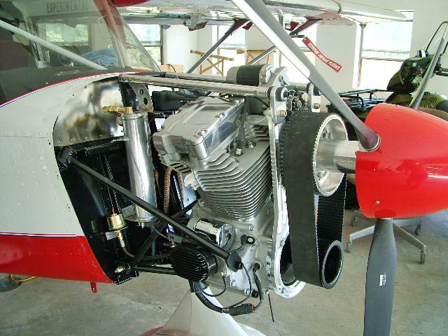

Marty_d Posted December 16, 2015 Posted December 16, 2015 I've seen a 701 with a converted Harley motor - I thought they were asking for trouble, Harleys convert 90% of their power into vibration... 2 3
facthunter Posted December 17, 2015 Posted December 17, 2015 Phil Irving was well aware of the "problem" I mentioned, He recommended an angle of 67 degrees, as optimal I believe but it would depend on conrod length. That might affect 3-4 degrees each way. 90 degree Vee Twins are fairly smooth and a vertical twin like the early triumphs used in the benson ? Gyros are not a lot different to a single, balance wise. Some Harleys use balancer shafts so their balance would be quite good, but that's extra weight. . When you get fairly big cylinders with not many of them and only firing every second turn (4 stroke) you are going to get pulses (torque) of some significance. Balancing ANY V twin uses the same process and concepts unless the pins are staggered. I've been doing them for years A Vee 4 with a 180 degree plane crank configuration might be the go for an aero engine, otherwise a two row 2 stroke six cyl radial has appeal. Nev
